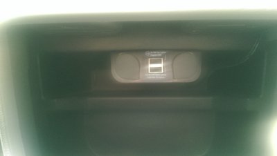

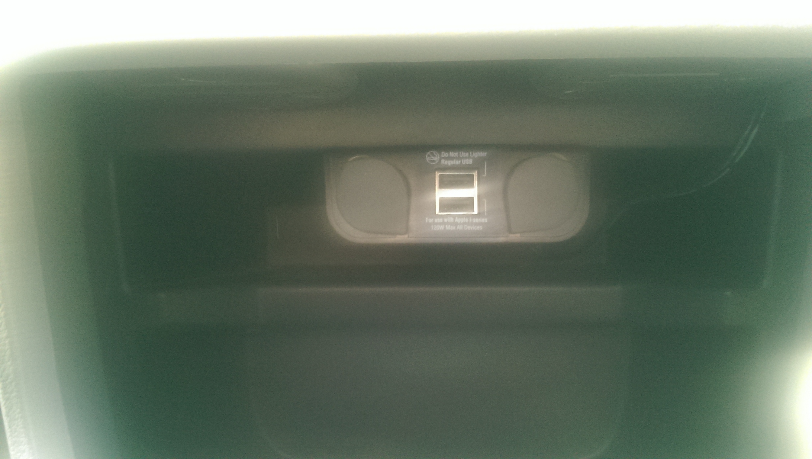

When I replaced my beverage mate with a new console, I bought this charger/adapter from Amazon (Multi-Use Vehicle Charger with Dual USB Ports and Dual 12 Volt Sockets - Magnadyne):Blue~Go wrote:
Since you may now have a live wire down there (you may already know this), you can find the fuse for it in the little added Chinook fuse block that is by your left shin when driving. On my rig it was the third fuse down in the right-hand column, labeled "7.5 amp max." The 2000 manual shows it the same.
http://www.amazon.com/gp/product/B000PB ... ge_o04_s00
and spliced it to the old beverage mate live wire and mounted inside one of the console bins. Now I have two new 12 charger ports and two USB charger ports in the doghouse, for phones and GPS, etc. The chargers are tied into the ignition and fused, in place of the old beverage mate. This keeps the cords away from the dashboard.

That's a clever on the Beverage Mate wire - I hadn't thought of that. Only caveat (which you have probably taken into account) is that it's not too hard to exceed 7.5 amps with that many charging sockets. Of course that doesn't mean you have to, and it's fairly easy to keep track. I haven't looked at the wire size though - it may have the ampacity for a larger fuse and they just used 7.5 amp because Beverage Mate "said so." I'll have to look at mine to see what gauge the wire is (unless you already have?)

The Beverage Mate wires are not big (maybe 14-16 gage) but they are as big or bigger than the wires that come with the charging ports. I just used crimped spade lugs (male to female) so they can be separated, and I covered them with tape.Blue~Go wrote:Funny, but I have that same little unit. I use it at the dining table.

I also spliced a wire into the Beverage mate wire which runs the length of the chassis to the rear step to power my backup camera. It comes up through a hole under the rubber seal of the big dog house. I have "tested" the fuse twice already, with the camera power wire getting punctured or abraded and shorting to the floor. (ouch.) Hopefully my last repair will hold up better. For that reason, I feel better with the smaller fuse, so it will blow faster for real trouble. We use the ports mainly for charging phones when driving, so it's not many amps.

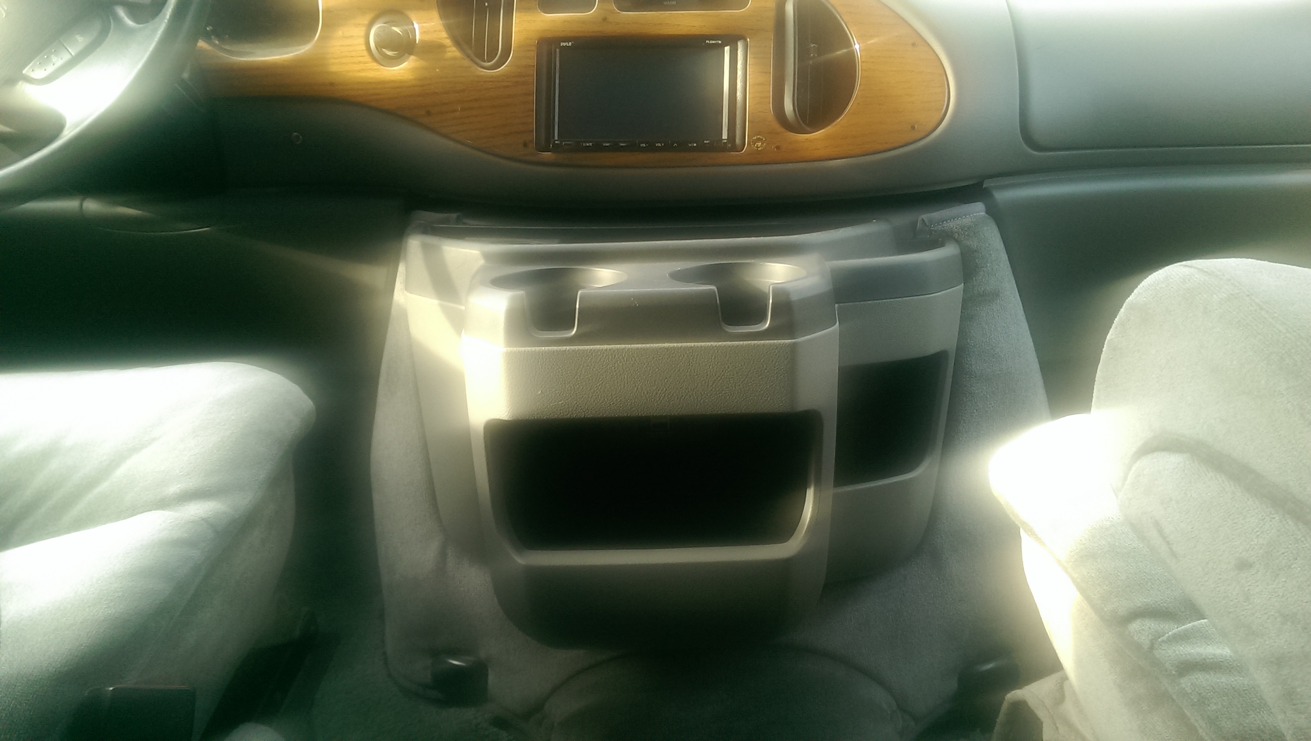

Here's another picture showing our new console (which I managed to buy for $50 last December before the price gouging) and my new head unit, which integrates the radio, backup camera, and GPS on a single display/touch screen. I connected the backup camera feed to the head unit Aux video input as well as the backup camera input, so I can view it continuously, in addition to it automatically coming on in reverse. The charging ports are in the big cavity just below the cup holders.

Great ideas, Caconcourse. I'm going to end up borrowing some ideas from this thread. I got the replacement today and will either install it later or tomorrow. I haven't unboxed it so I'll have to see if it needs a good cleaning. By the way, great picture. Very ethereal...
