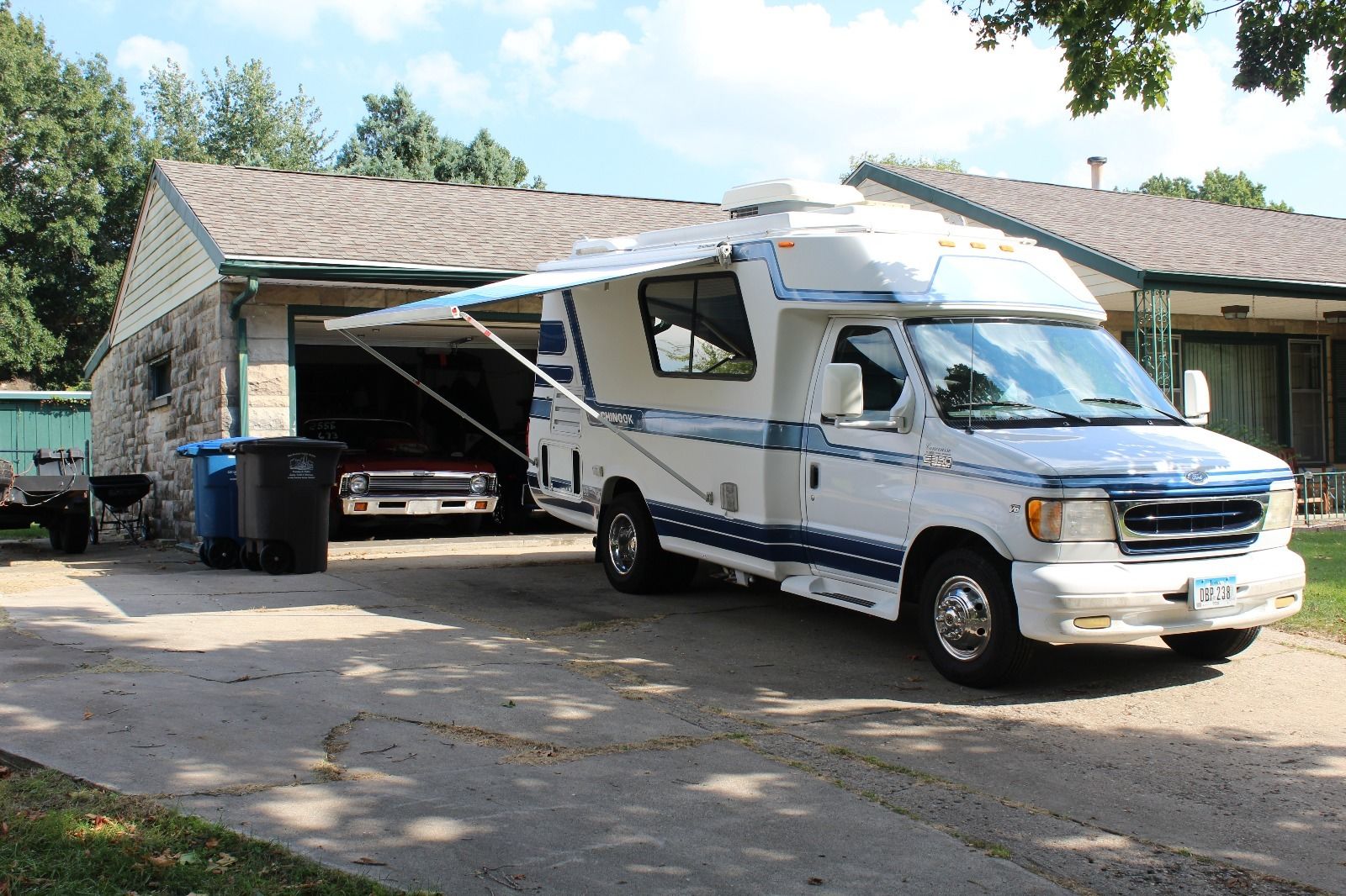

Our new to us Chinook had the awning removed and stored prior to our purchase but was included in the sale. The previous owner lost the top mounting brackets and was not able to find them. I have the "C" channel railing used on regular motorhomes and it will work but will require drilling and mounting with several screws. I have never mounted anything in fiberglass before and was wondering what precautions I should take and does it require special type of screw? Thanks

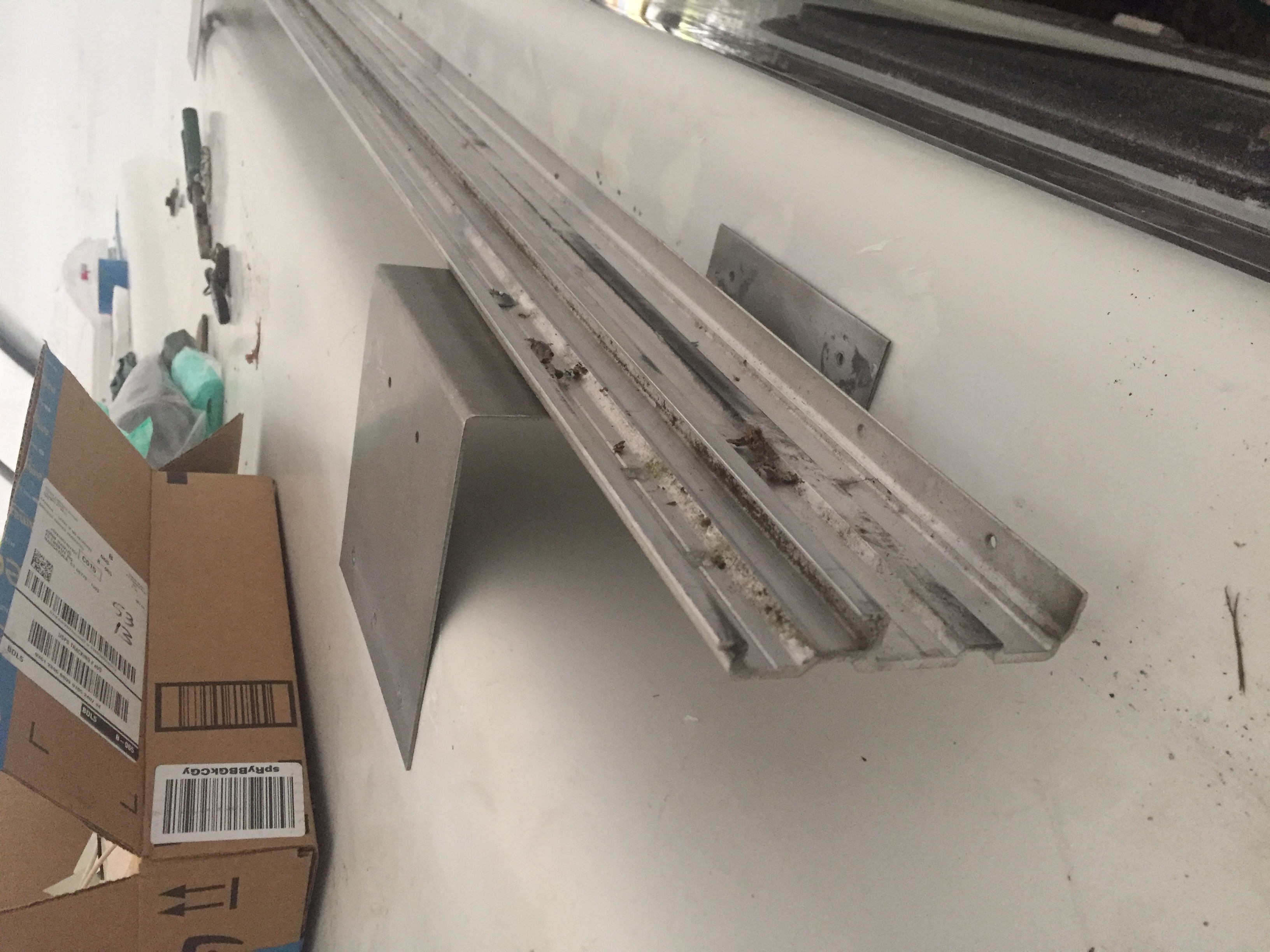

Mine is attached with three aluminum brackets that take advantage of the Chinooks uneven roof.

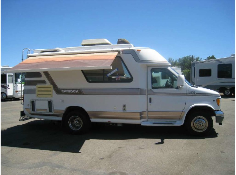

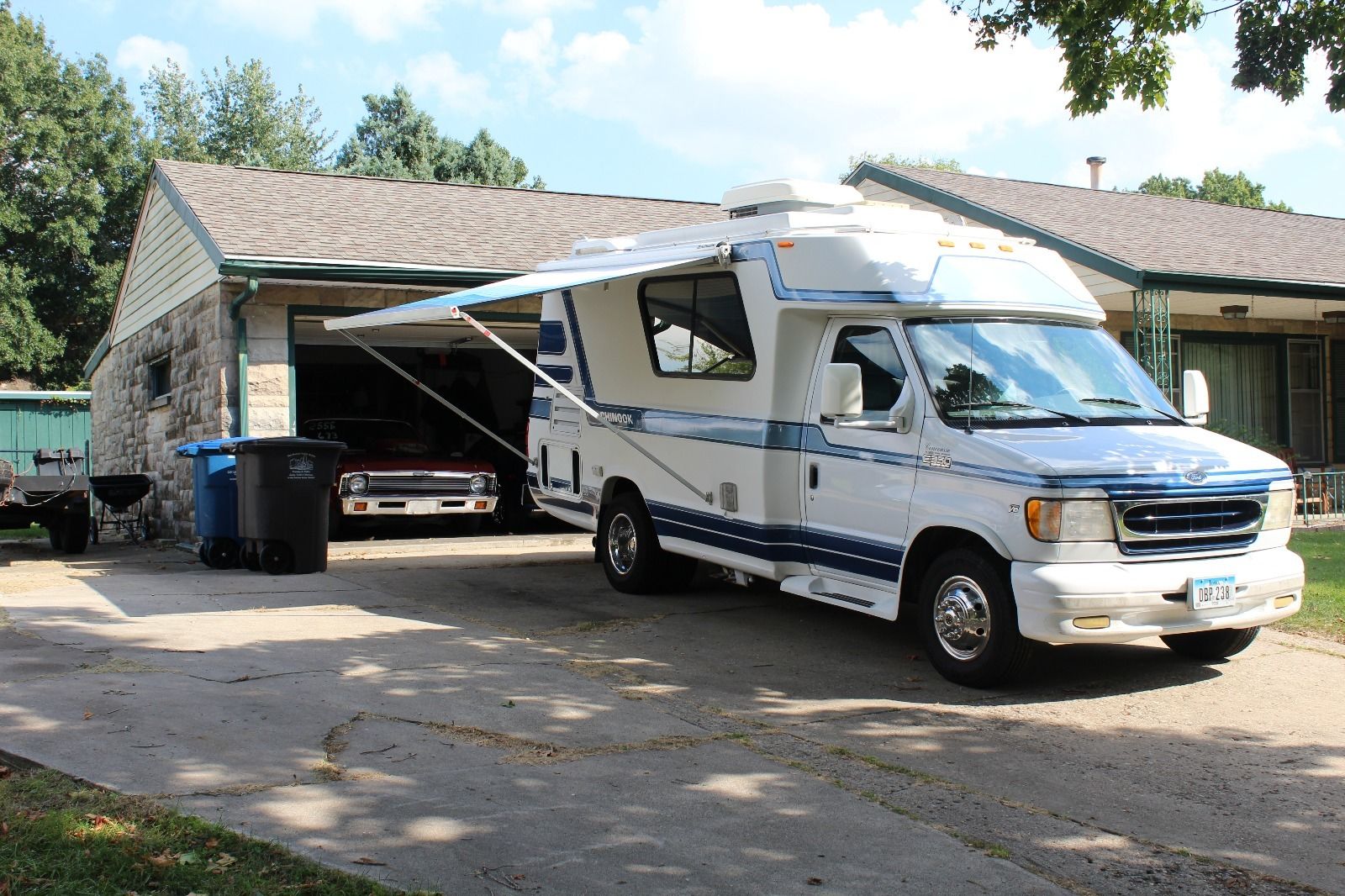

Is yours a side-door model, Willy? I ask because I forget (sorry), and typically on the rear-door models the awning is attached right above the window (over the colored stripe a Concourse would have there) so the area is perfectly flat. Mine is in the latter location and has the three anodized brackets typically supplied by Fiamma for a wall mount (basically flat pieces with a little ledge at the bottom).
I could imagine where on the side door models they'd have to mount the awning up in the roof "dip" so it would clear the door. There are a few other side-door tweaks as well (water tank location, propane tank size, etc.) Here are typical rear-door awnings as done by Chinook (may have to click to enlarge in order to really see them)
I have noticed a couple of "flaws" with the installation of mine.
One is that the rearmost bracket is about a foot forward of the end of the awning. When tensioning the legs you can see the last foot of the awning trying to bend away from the coach (although it doesn't if you are really careful). I looked at the Fiamma install instructions and they specifically show that bracket right near the end of the awning (that's where the force is), not a foot away . My guess is that Chinook put it where they did as that avoided them having to deal with the inner roof liner - it's not there where they mounted the rearmost foot because of the cutaway for the refrigerator vent area. Further aft it's there. Not that I can see any reason but "ease" for not putting the bracket further back. Also there are no backing blocks or washers - slight flaw although I don't know that any have torn out so maybe no prob in real life.
Two is that one notices, upon putting the awning out, that it doesn't shade the forward end of the dining window, and yet shades the closet :roll: Then you notice that they "had" to mount it so far aft or otherwise the body foot (for if you put the support legs on the body not on the ground) would otherwise have landed on the generator door. Well that explains it. Shading the refrigerator is nice, but it would be nice to shade the window completely. I haven't looked in the Fiamma guidelines to see if perhaps the feet could be mounted higher up. Mostly that's because it's either too windy to put the awning out, or, more often, I tend to park with the couch side to the south or west (I could use a window awning on that side!)
