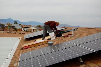

Recently I’ve installed new roof vents in our Chinook and used roofing tiles to seal the floor of the vacant generator cabinet. This provided serendipitous training for the present home saga.
‘She who must be obeyed’ insisted the leaking home skylight get fixed before Christmas but local roofing contractors were of dubious reliability. No problem, thinks I - should just be a bigger version of my Chinook projects.

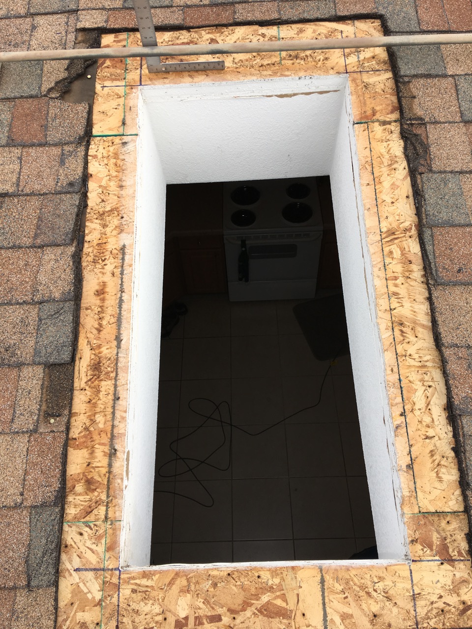

Home Depot sourced a nice new double-glazed Velux skylight for me to replace the existing plastic bubble and there was no more excuse to procrastinate. I pried off shingles down to particle board and prepared the 4’ x 2’ opening. Naturally the only rain in months was forecast that evening to increase my stress factor.
The tricky part was stair-stepping new shingles to fit the ragged opening with sufficient overlap for a leak-proof seal. To this end I applied roofing tar in vast quantities and naturally created a heinous mess on clothes and tools. My timid “Honey, I have some items for the laundry….” was not well received.
Anyway, to conclude with some relevance I want to mention a possible alternative to butyl tape for sealing water leaks through the Chinook’s shell. It is Velux adhesive underlayment for skylight and Google will provide more details. This comes in rolls and is very durable plastic sheet with a pre-applied and incredibly tacky tar adhesive layer.
If tar was good enough for the Royal Navy’s sailing ships then the Chinook should also benefit from this more natural and proven material.
