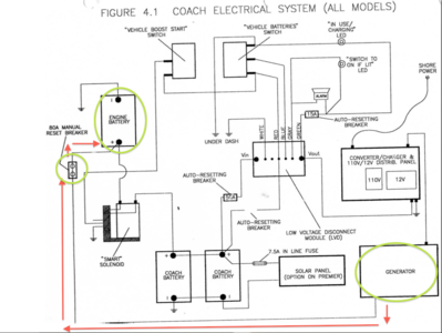

Okay, I'm surprised a 2004 would have the gen start breaker on the firewall. I remembered the electrical diagrams showing that having moved. Or maybe they moved it but didn't change the diagram. I was lazy last night, but I'll take a look now.
On my oft-mentioned buddy's other-brand Class C, the electric step is triggered by the ignition. So if the step is out, and you start the vehicle's engine (Ford E-450), the step retracts so you can drive away. Likewise, once you stop the vehicle, the first time the door is opened the step automatically extends so you don't walk out into space if you are exiting the rig. I don't know if the Chinook works this way, but on his the step gets its power from the house bank, but there is a wire tying into the ignition somehow (it's under the hood, labelled, and runs over to the big fuse box in the forward corner under the hood).

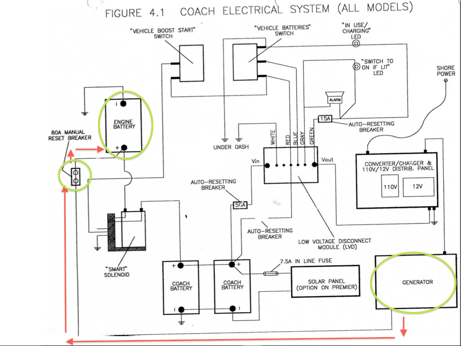

So okay, on the 1998 Concourse and Premier manual DC diagram, it shows the gen start wire running up to the Ford battery, and the 80 amp breaker. Mine was just like that, breaker on the firewall (and with that crazy long run of 6AWG wire, far, far beyond the recommendations by Onan for voltage drop). Here is a copy of that diagram. I have highlighted the path of the positive cable in red, and the components in green (clicking on it should enlarge it). Edited to add: As kdarling rightfully pointed out, I drew the arrows in the opposite direction that power would normally flow. This power we're talking about only flows from the battery to the generator starter and not the other way. I was just highlighting the path, and my editor doesn't have a feature that is just a line, so I have to use an arrow as a line. But duh, I should have made the arrows go the other way for clarity. I was focusing on the two different paths Chinook used.

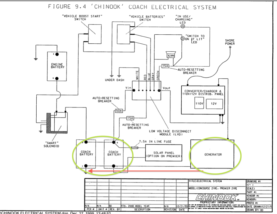

And here is the same drawing from the 2000 manual. You can see they moved the gen start positive cable to the house bank (much shorter run, so that's good, although it's still undersized by Onan spec, which may show up as hard starting in cold weather). They don't show the fusing (breaker), but I would hope there is one. It should be as close to the house bank as possible on the positive line.

There is no DC electrical diagram shown in the 2004 manual that I can see. Only the AC diagram (generator starts via DC power). Since the 1998 manual shows it starting via the Ford battery, and since my 1999 does that too, and then since the 2000 manual shows it starting on the house bank (which Onan recommends anyway), I conclude it was moved for the 2000 model year. I can't see why they would have moved it back, but since the diagram doesn't appear in the newer manuals, I can't see anything about it.
(I have a paper copy of the 1999 manual, but have not digitized it and it's not with me right now. But I have a real, live 1999 to look at :D)

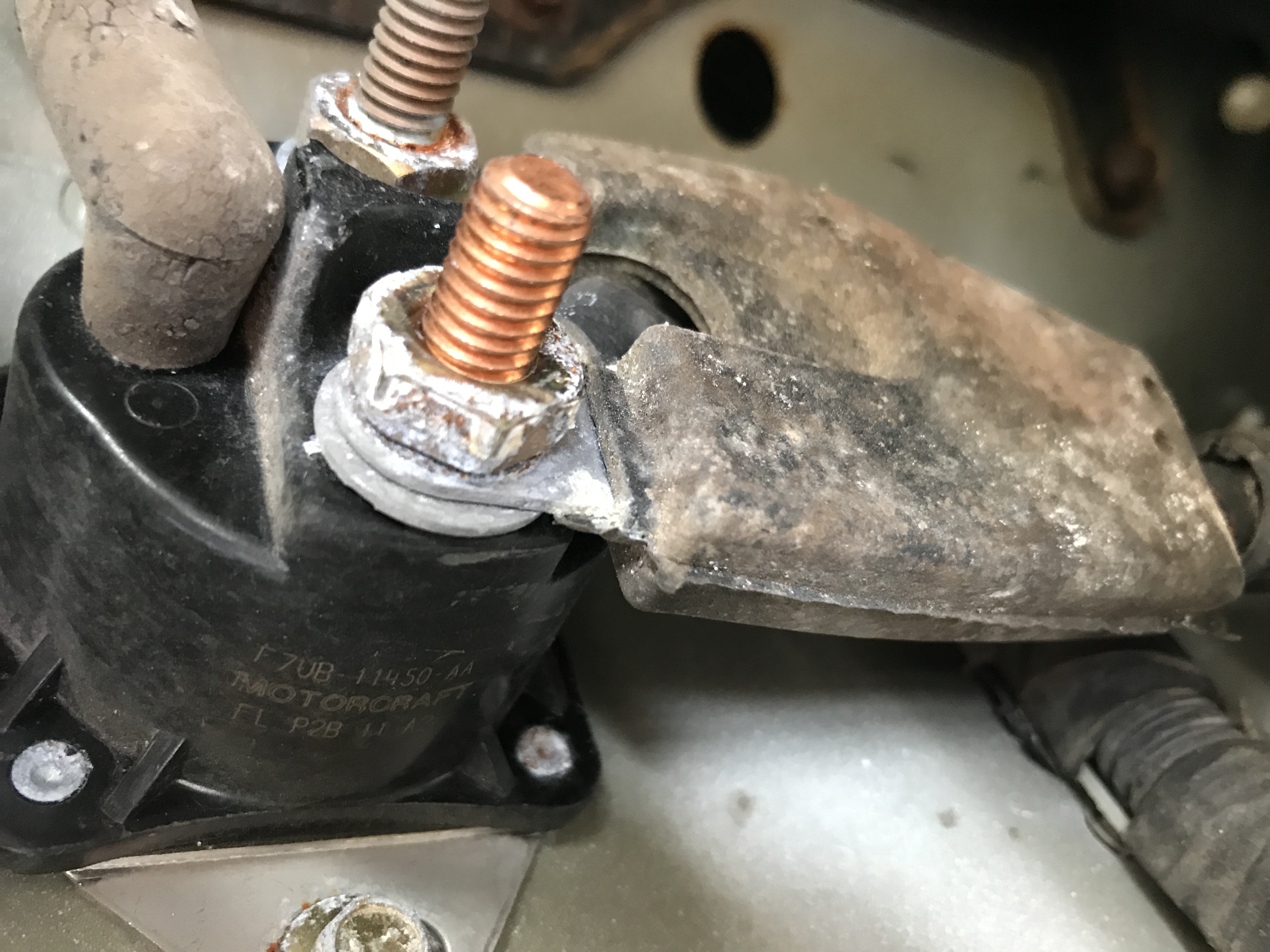

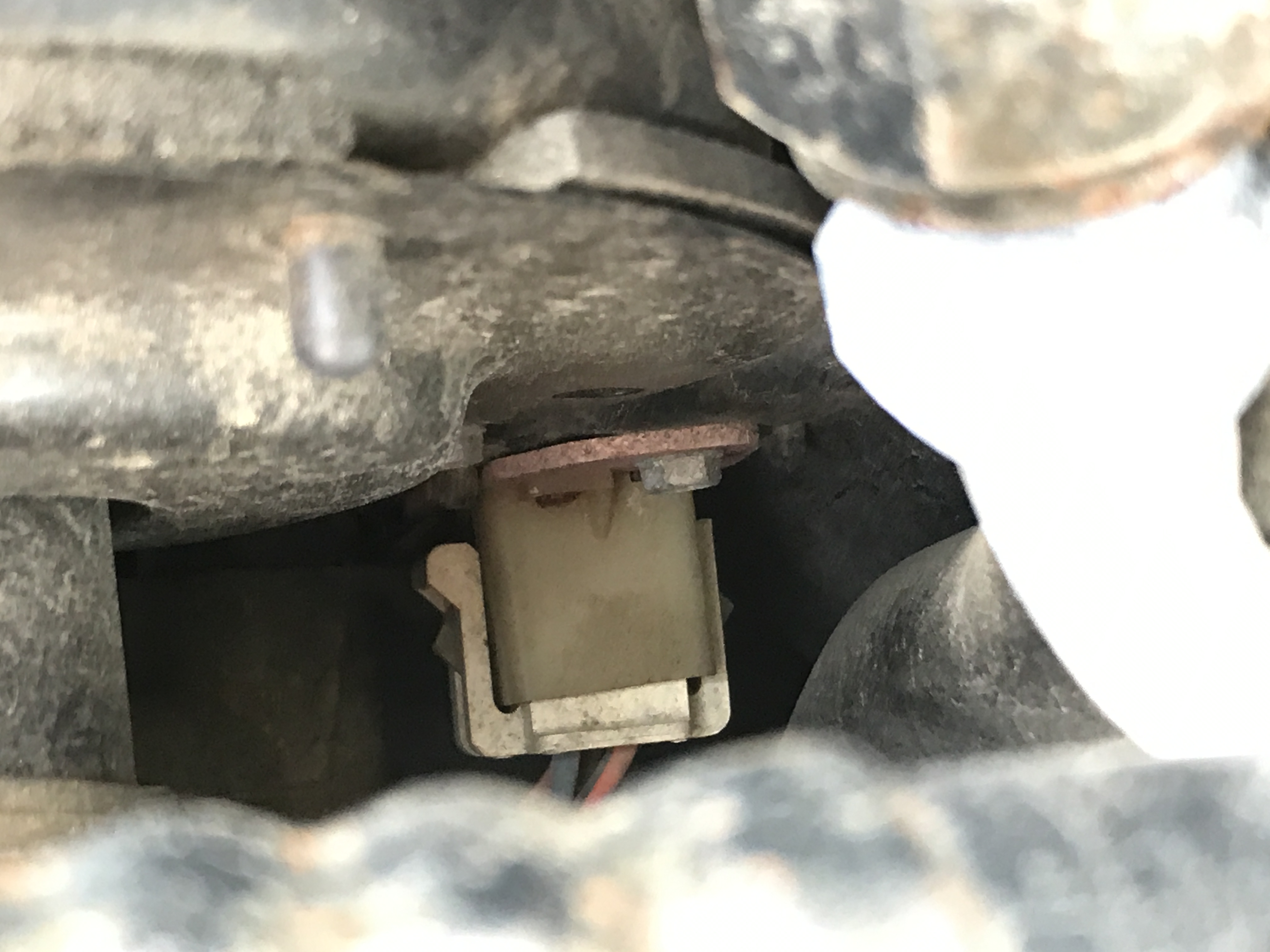

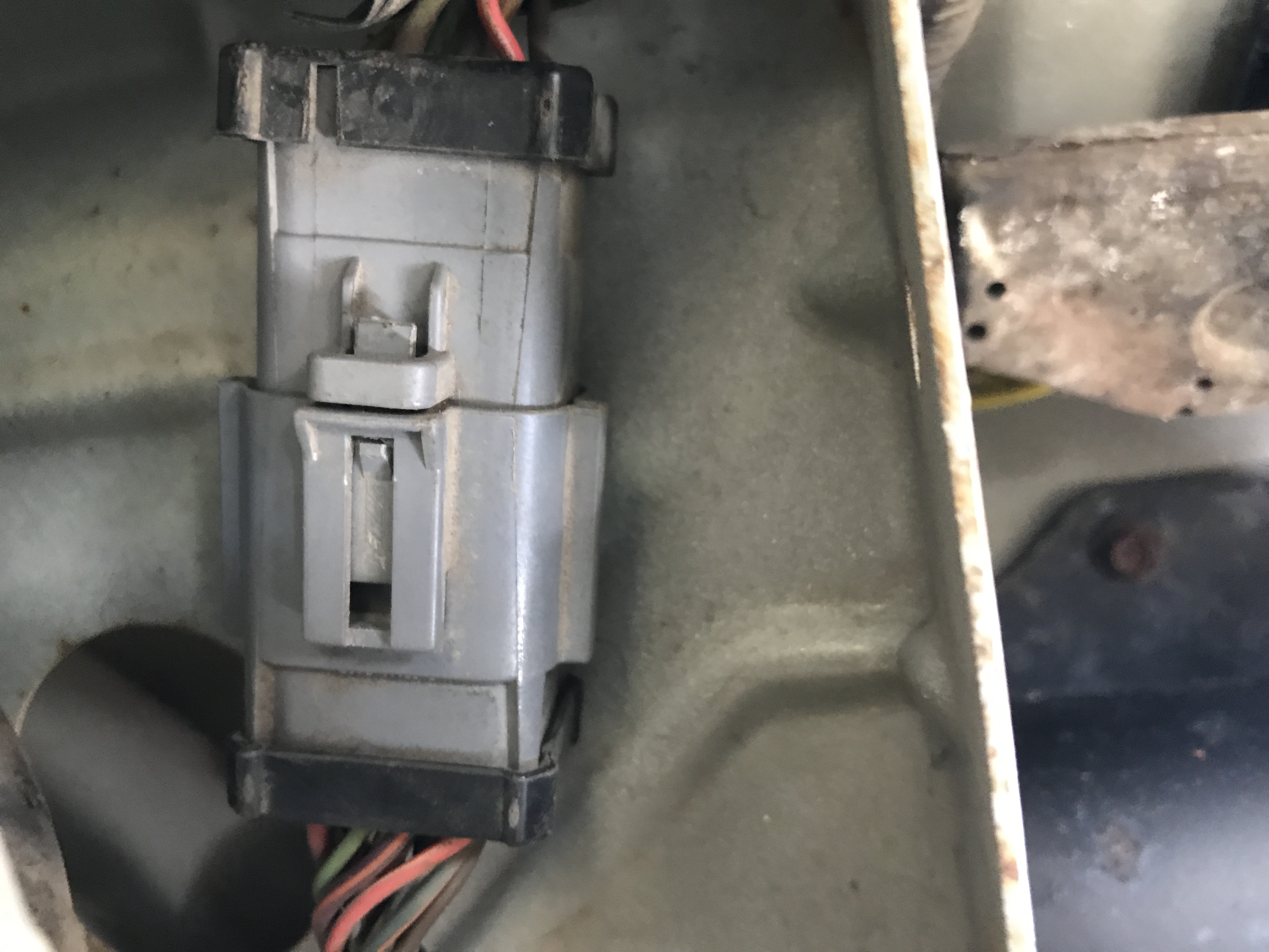

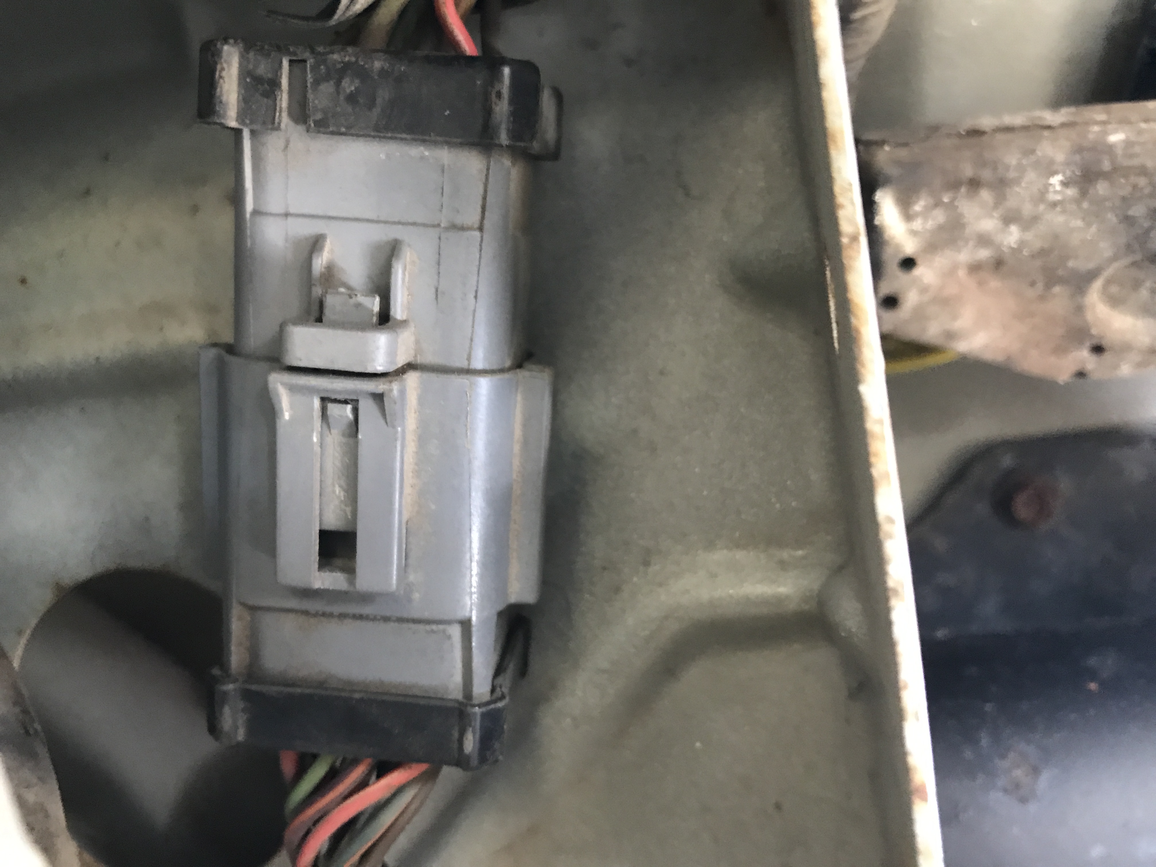

OK now I'm going to show my ignorance. The three electrical components in the attached photographs were all found near the passenger side firewall under the hood. Are any of these three a circuit breaker?
Ross
2003 Chinook Concourse
PostPosted: July 10th, 2017, 10:44 am
Posts: 248
Location: Marysville, WA
This is a 100 amp breaker I found to the left of the generator which connects to the solenoid. It appears to have a reset button but I'll leave confirmation of that to someone with better knowledge. I didn't find one on the firewall as indicated in my manual.
PostPosted: July 10th, 2017, 1:18 pm
Joined: October 26th, 2016, 8:01 pm
Posts: 25
Location: Bend, OR
I have a similar breaker at that location. I am assuming that that is the circuit breaker between the generator output and the house batteries, and not the breaker that sits between the chassis batteries and the generator starter. Correct me if I'm wrong.
Ross
PostPosted: July 17th, 2017, 10:46 pm
Posts: 142
I have a 2004, the photo of the breaker is the one with the red push button and the writing on it that says HI-AMP, located beside the generator. In your photo it does not appear to be tripped, when it trips a small arm will pop down near that red push button. To reset it you simply push that small arm back up in position. To test it you simply press in on the red button and the small arm will pop down. I cant tell for certain because the one image isnt clear enough... but is the plastic housing on that breaker melting? It looks like from the images that the corners of the plastic housing have been hot and are melting or is it just an illusion from dirt and lighting?
