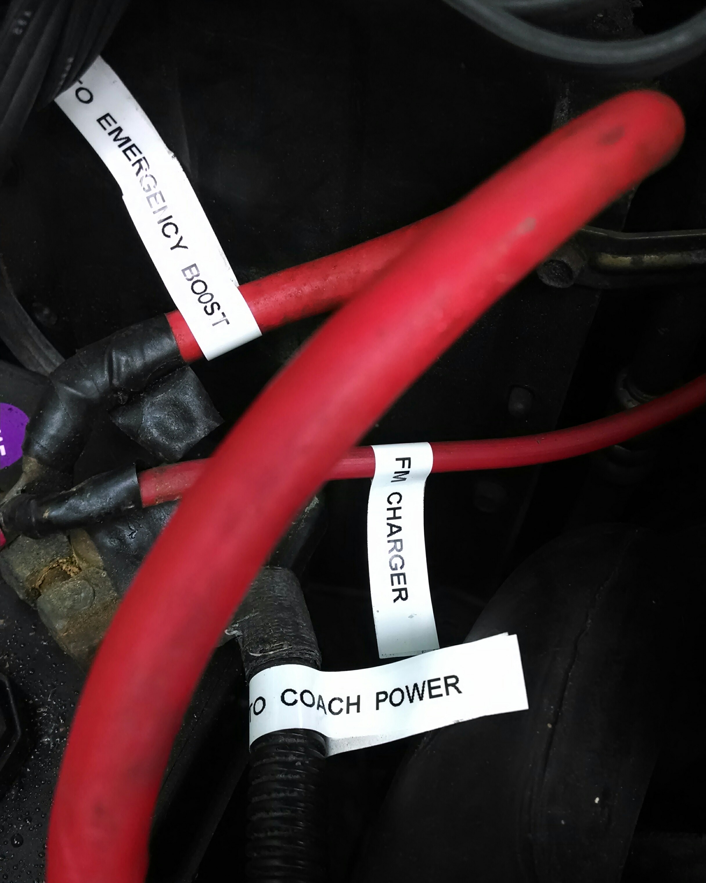

Yeah I've gone crazy labeling all the wires, from under the closet, to behind the fridge (helped when troubleshooting and replacing the power supply), and now plan on laminating wire color reference cards to go under driver's door sill, and under chassis for the big rear lights bundle. Will save me and others from having to dig through reference manuals all the time.
I started with masking tape but they didn't last. Here's what I use for labels now. Also bought an extra roll of tape.

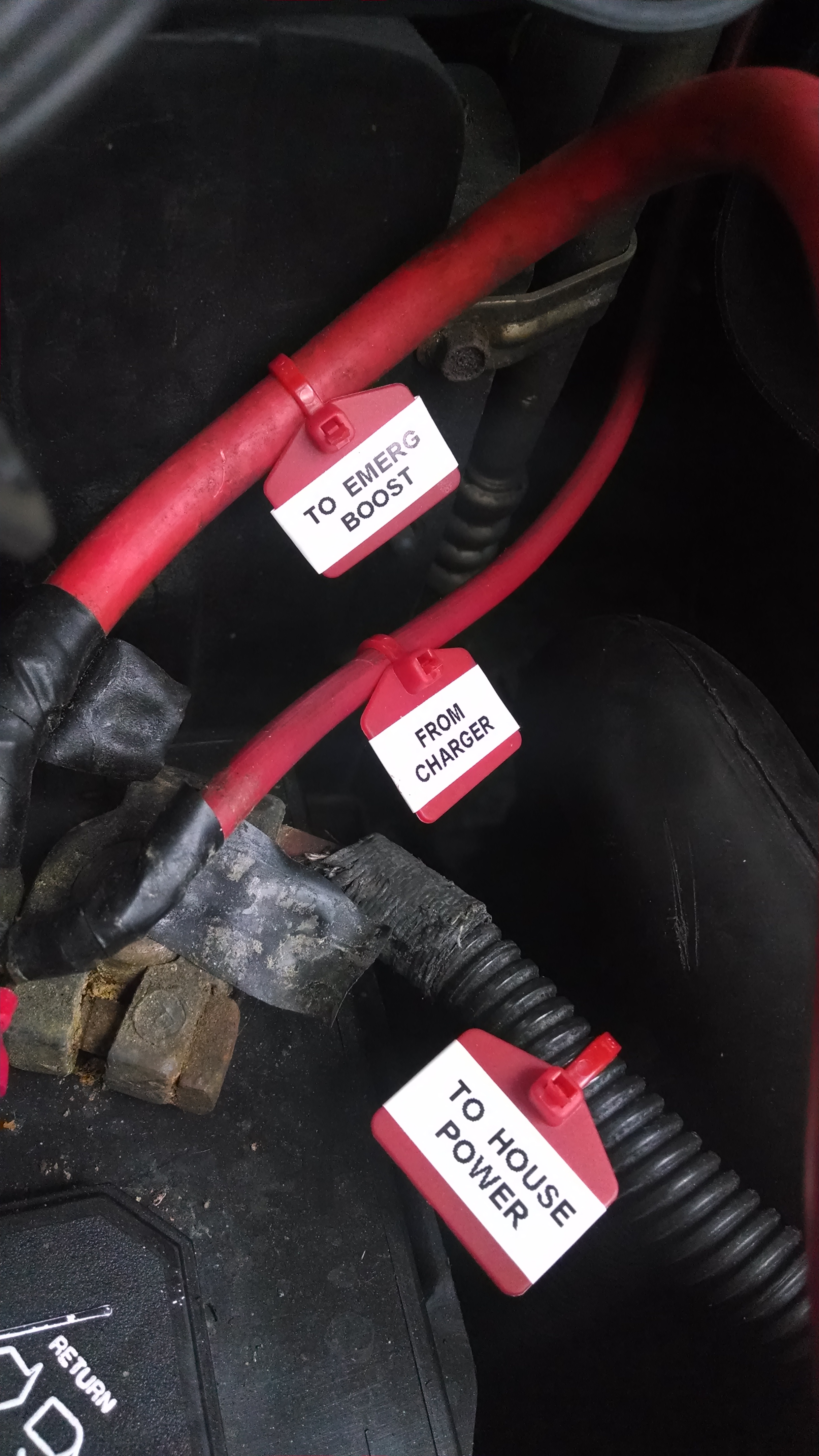

Edit: here's the new tags:
File comment: new label tags
