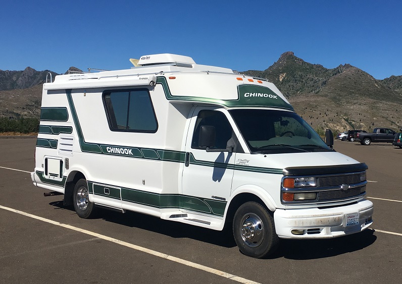

I am just getting acquainted with my new (to me) 2001 Chinook Destiny. We have taken it on one weekend trip and will be going on another in a few days to find someplace dark enough to watch the upcoming Perseid meteor shower.

Hi and welcome! I like the green - will look great in camps :)

Welcome Jim. Great looking rig. (I've always been more of a GM guy but always had Ford chassis motorhomes) Sounds like an ambitious list of upgrades. Look forward to more pictures. The name of my Chinook? The Chinook. ;)
