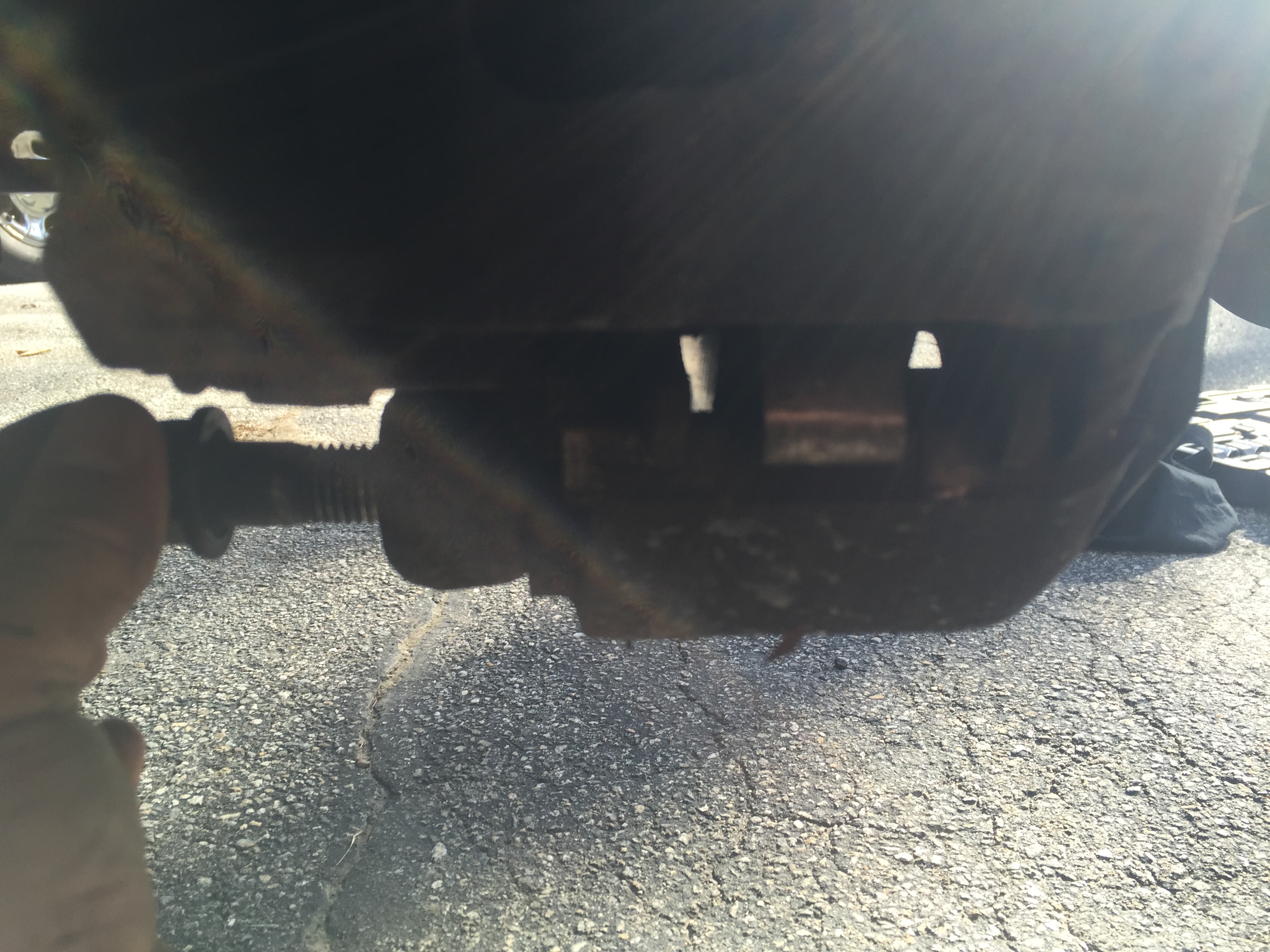

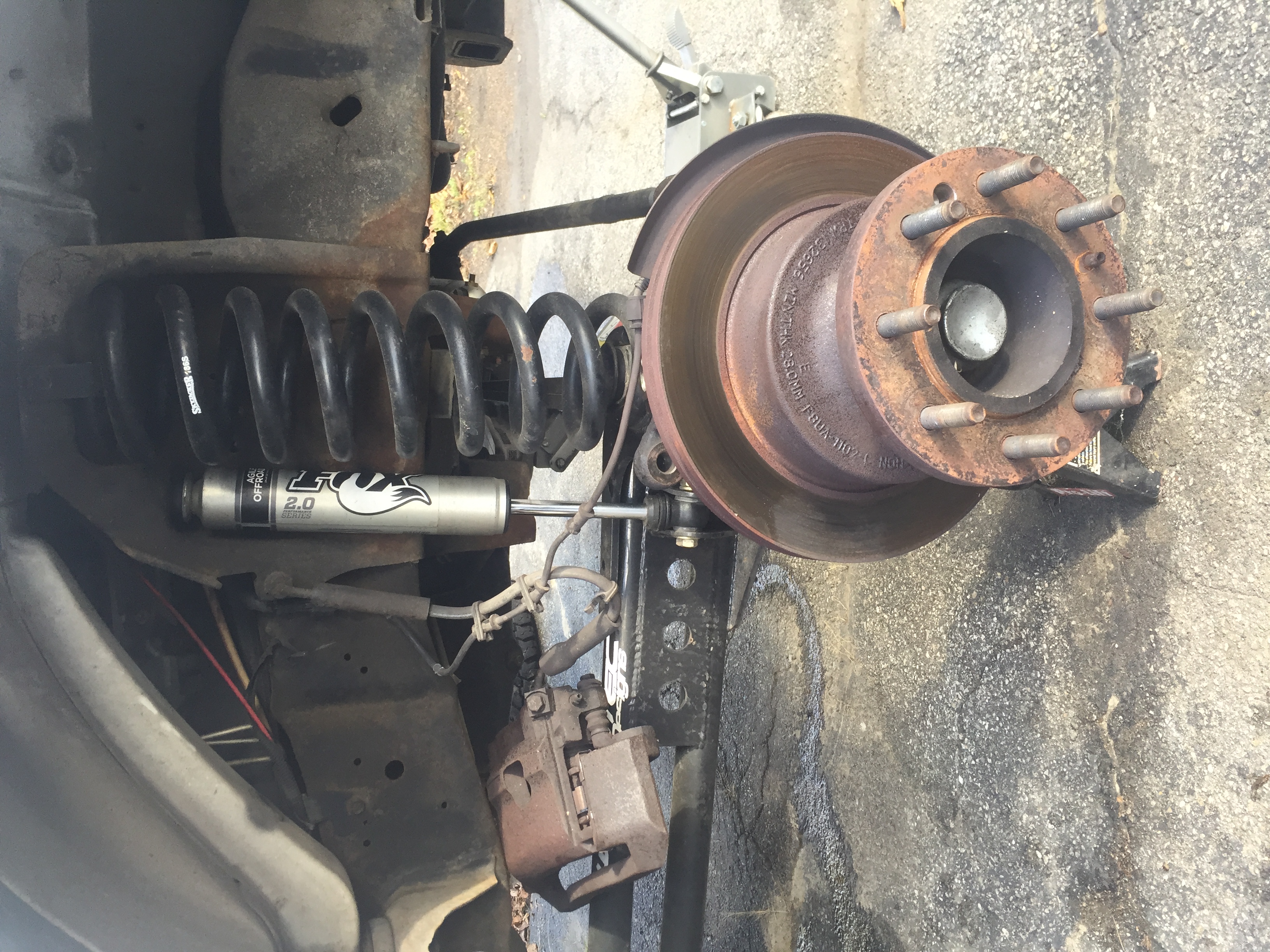

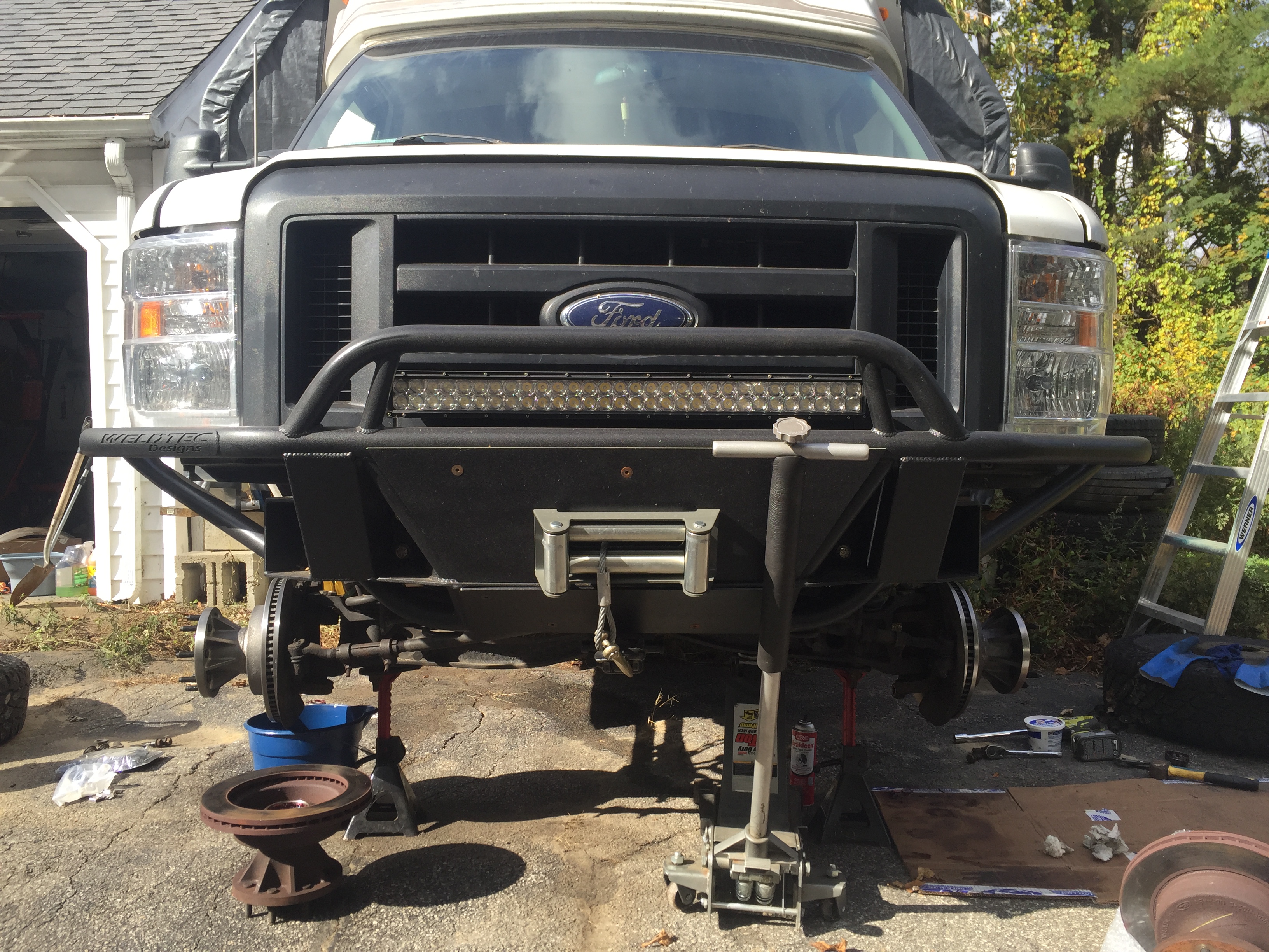

I installed everything yesterday morning in under 2hrs. It was VERY easy and I'm confident anyone with some basic tools (socket set, pliers, jack, jack stands, can of grease, new cotter pins, some rags) can accomplish the task in their driveway. Taking the caliper and bracket off together makes it so quick and easy. I purchased new inner and outer bearings but ended up not using them and just re-packing the current bearings as they looks as if they were replaced once already and looked very good condition. I also didn't use the hydraulic brake lines i bought as the current ones looked good and fit fine.
I took a ride after the install to "bed" the brakes which just involves some moderate stops from 35pmh-10mph, then from 45-10mph all without coming to a complete stop if possible. After that i let it sit so the brakes could cool down while i did an oil change. I was going to take her out for a cruise after that but ran out of time so the verdict is still out.
Attached are some pictures of the job...

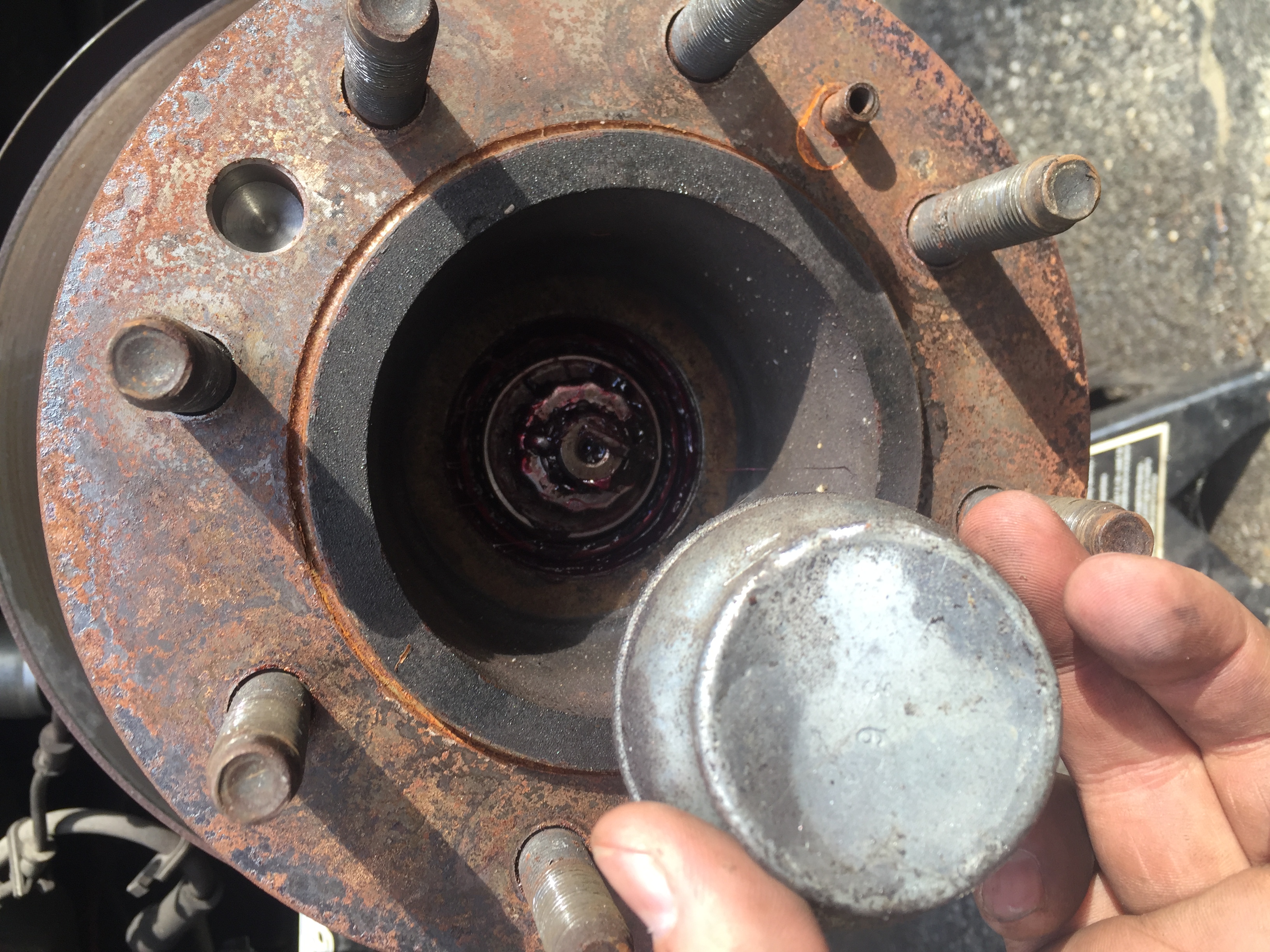

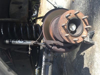

First photo is the stock setup. once you have the truck up in the air and the tires off you can pop off the dust cap with piles or a screw driver, pull the cotter pin, remover the "castle nut" style cover that sits over the nut and then remover the nut which is usually only hand snug and can be taken off with pilers.

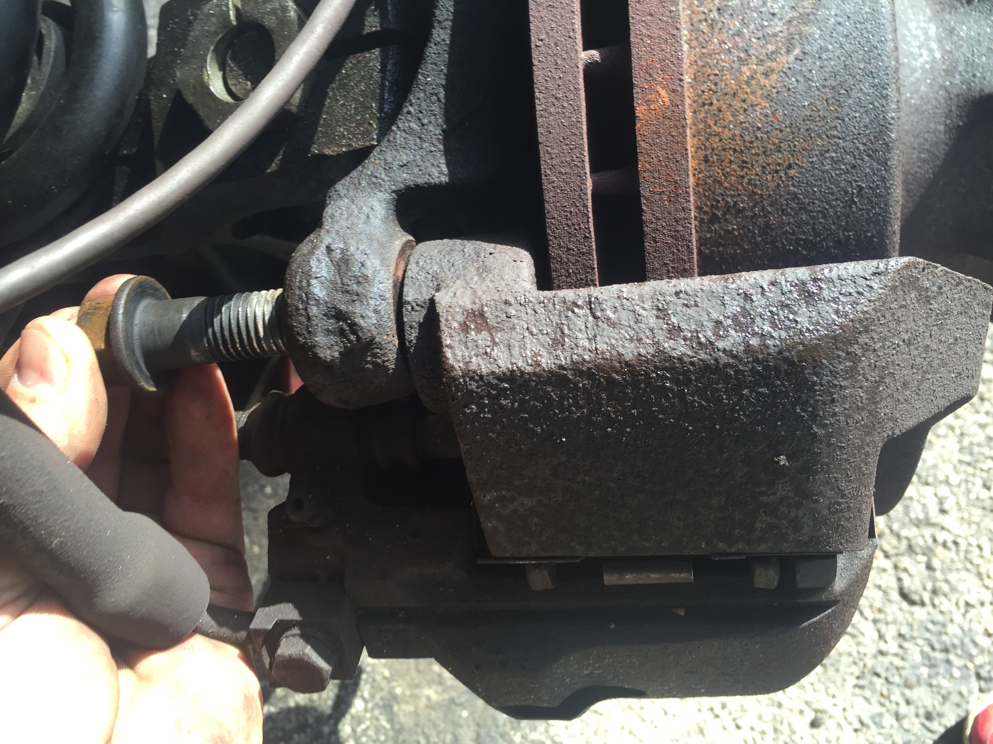

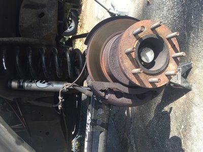

Take off the two bolts that hold the caliper bracket on then remove the whole assembly and place it out of the way till you disconnect the line from the caliper. have a bucket handy to catch the brake fluid that will drip out.

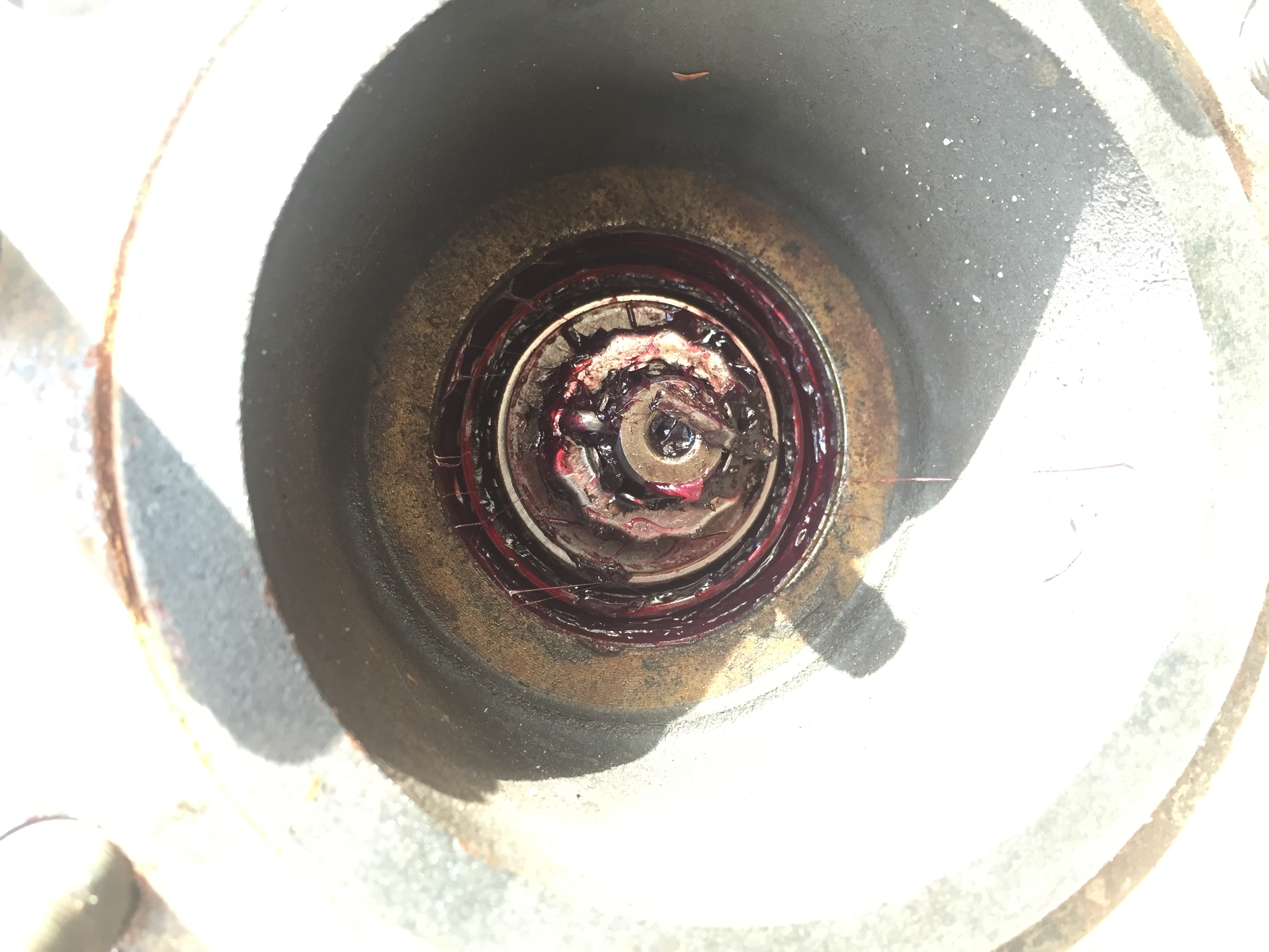

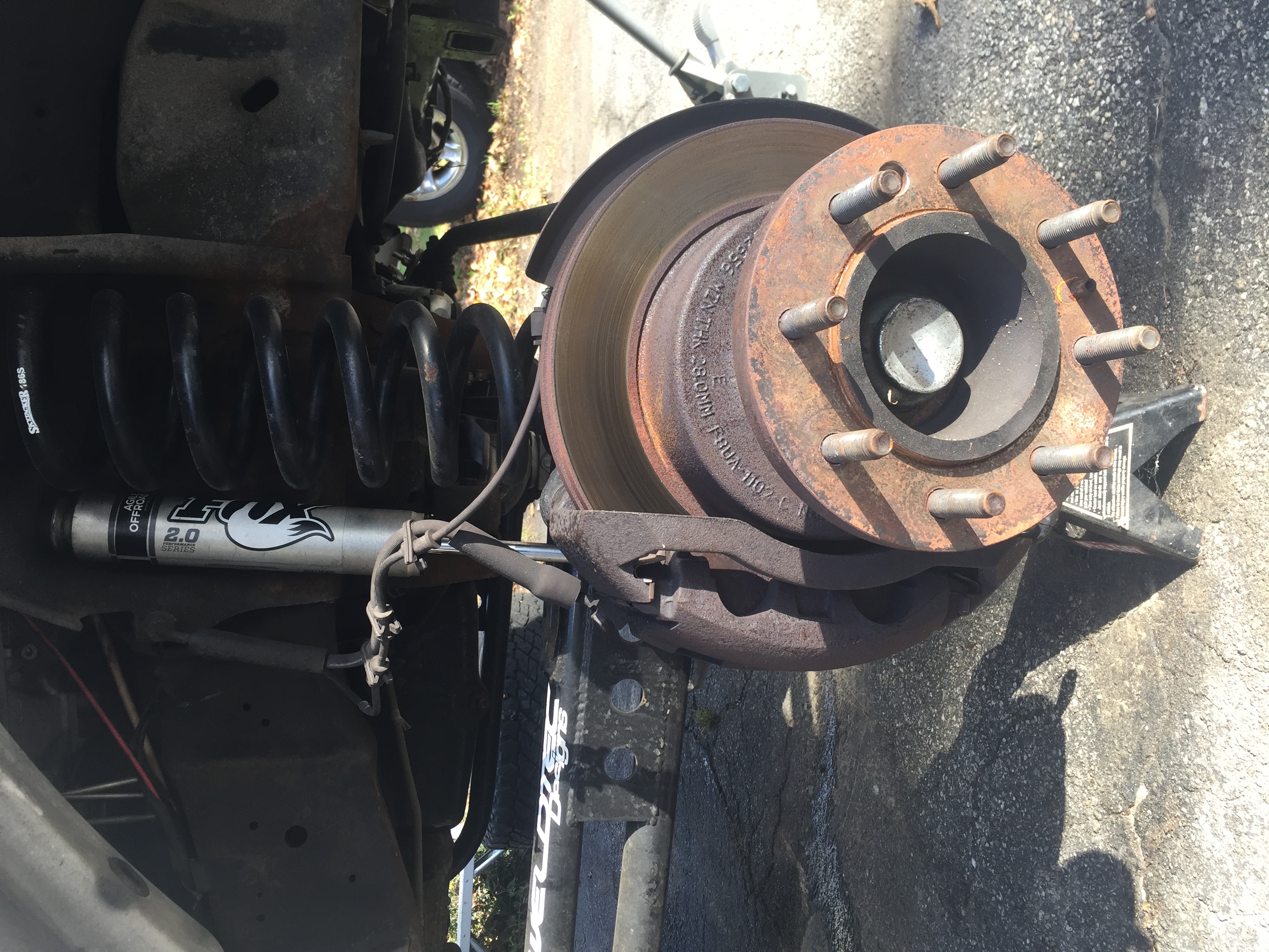

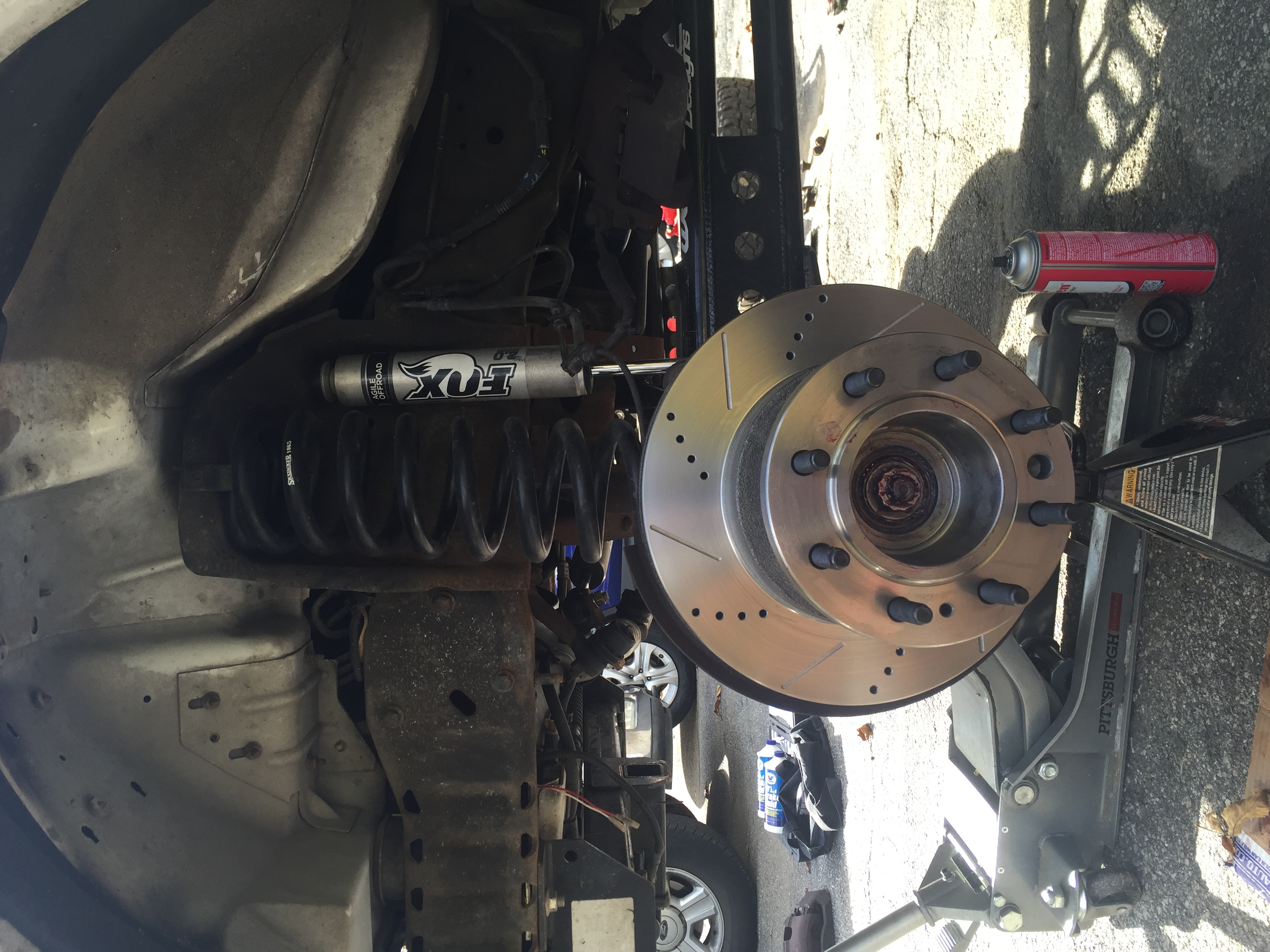

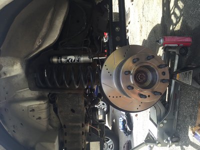

Once you have the caliper off you can fully remove the old rotor/hub being carefully to catch the flat washer and outer bearing that will fall out. Then to remove the inner bearing and dust seal from the old rotor just lay it flat with the wheel studs up and use a large socket or flathead screwdriver to tap the bearing out thru the bottom, it comes out really easy.

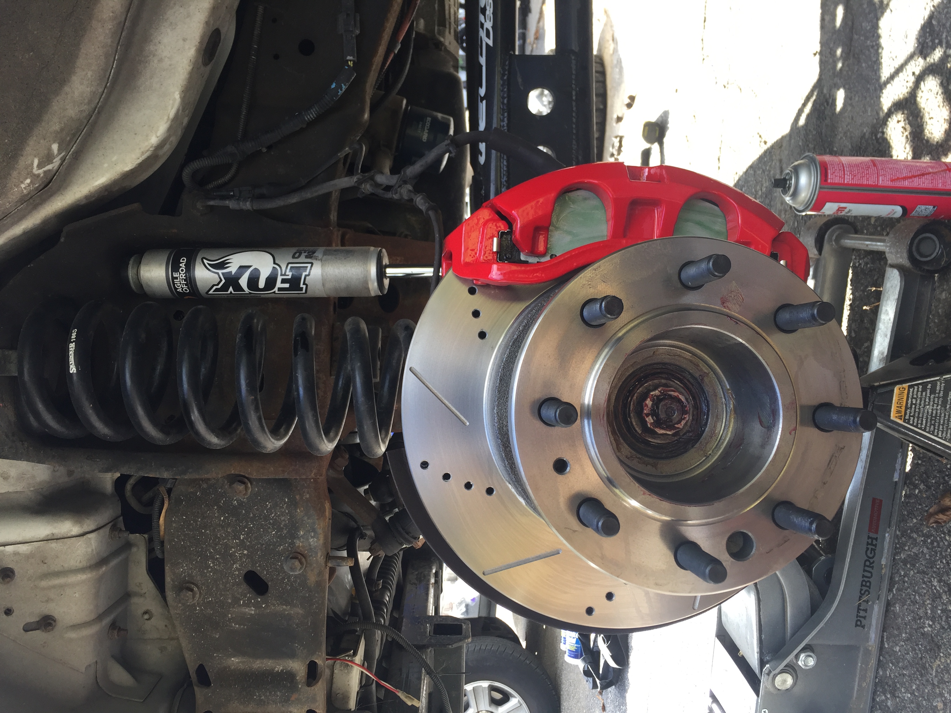

After they are out, repack the bearings with grease and install them into the new rotor/hub assembly and slap it all back together. Next install the new pads into the new caliper and attach the whole assembly back in place with the two bolts for the caliper bracket. Attach the brake line back up to the new caliper and then your done. Make sure to bleed the brakes good after the install.
