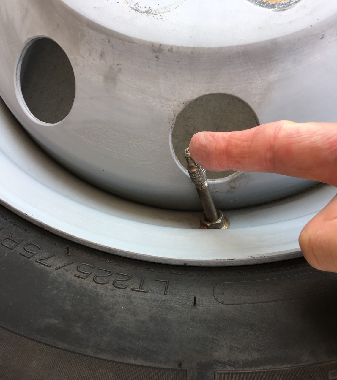

A word of caution out there, folks. We just escaped a potentially serious blowout of the front tire on the freeway owing to sudden loss of pressure. I had new metal valve stems installed just over four years ago along with a pair of Michelin tires. Naturally I assumed the rigid metal option would be more durable and safer at 65 psi, being common in the trucking industry.
I was fortunate to limp home where inspection showed the rubber grommet seal at the base had failed. The picture shows how the stem became loose and can be tilted easily by finger pressure. I have a monthly routine of checking tire pressures and there was no prior warning like gradual loss of pressure. Perhaps a bubble solution check would have caught the onset before we were out on the highway, but this is impossible for the rears where the stems are recessed inside the rim.
Naturally the tire is trashed from running seriously deflated with multiple sidewall bulges showing cord separation/breakage. Based on this I would recommend a check/replacement of valves, even the rigid metal ones, along with tires at the maximum recommended 6-year life. Cheap insurance!

OK, here’s the scoop from our local heavy equipment / truck tire “expert” on metal valve stems. He confirmed the main advantage of metal is withstanding higher pressures safely compared to rubber stems.
However, the disadvantage is metal expands then contracts significantly with normal operational thermal cycles that loosen the thin exterior lock nut over time. This lock nut holds a metal washer compressing the lip from the inner rubber seal that projects through the rim.
Therefore you are supposed to snug, but not over tighten, the lock nut regularly as part of preventive maintenance. I neglected this so never caught the loose lock nut in time. Now being wiser I’ll have to learn to contort my hand with a wrench inside the duallies to take care of the rears. The “expert” said not to use loctite but gave no compelling reason.

Had my new Cooper Discoverer HT3 front tire (to match the existing set) and metal valve stem put on today by a real olde-tyme pro; you know, from the daring generation who used ether explosions to seat beads on stubborn tractor tires. I digress…. he allowed me in the shop past the manager/clerk security checkpoint for a forensic analysis of the failure.
The valve inner rubber seal was good so indeed the 9/16” (14mm) lock nut had loosened. I did notice the new washer he used under the locknut was flat whereas the failed one was dished with less contact area against the rim. Perhaps this was the weak link as the tech said stem loosening was most unusual in his experience. He also recommended against blue loctite for the simple reason it makes subsequent removal too difficult.
