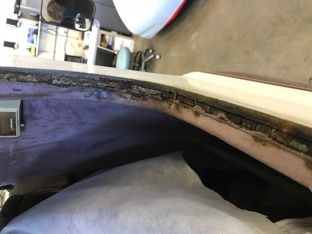

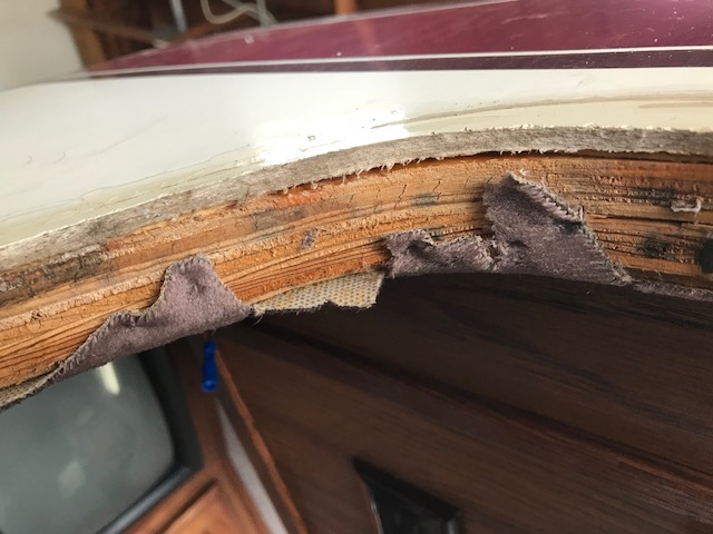

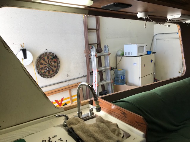

Your post is quite interesting. I have a 1995 Chinook Concourse with plywood framed window openings. I had similar water damage on the driver side sink area and then quite an obvious leak at the opposite end of the window running down the wall onto the couch.
On the passenger side, I found two leaks, after removing the furnace under the seat. A small water leak from around a poorly sealed vent cap and another stream of water trickling down the fiberglass to the left of the vent cap leak. I assumed these leaks were causing the wet carpet from just behind the front passenger seat all the way along the wall back to the stove area.
I made this a priority as it was going to cause more problems if not addressed. I made an appointment with a local auto glass shop as they had an inside covered work area. They removed the passenger side window first. The window seal was a thick black foam which the glass installer thought was a good idea, probably used to make installing the windows easy and quick. It worked for a while anyway. This window opening had the most water damage to the plywood at the corner above the furnace. I'll post some pics, it looked bad and had been leaking for quite a while.
The driver side window opening was nearly perfect. No water damage anywhere, the plywood looked as new. Pics of that also to follow...

Here are pics of 1995 Chinook Concourse: The previous owner stored this outside. I had no idea about the source of the leaks until I sat inside it during the pouring rain while removing the old furnace. That's when I discovered the clogged window drain by the sink area.
File comment: Passenger side corner. This leak was discovered by previous owner, thought it was from roof vent because carpet was wet in various spots on passenger side. I observed a small water leak at furnace vent cover when replacing the furnace and and another bigger leak running down the fiberglass wall to the left of the vent opening. This leak is what caused carpet to be wet behind front passenger seat and continued along the wall to the stove area. I still have not located the source of this leak. Could be a roof railing support which is above that area. Also, there is no staining to the ceiling anywhere including the cabinet above where antenna crank is located.
File comment: Upper driver side window corner. No water damage to window opening. Water was leaking through the foam rubber seal at the top of the window frame and then dripping onto the pad behind the couch.
File comment: If you zoom in you can see damage to paneling by the sink, but no water damage to window opening. So leak was from clogged corner window drain, my drain was clogged, water over flowed the window track/frame and ran onto counter top. You can also see very minor water damage to opposite bottom corner behind couch.
