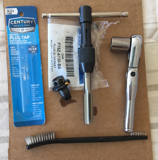

Sorry to continue the techno-geek talk but I wanted to close out with a success story on repairing my oil drain plug. Dodged a bullet on this one as the first order repair is chasing damaged threads inside the oil pan with a tap. This operation is fraught with risk of cutting too much meat off the threads or even breaking the brittle tap inside! Been there, done that.
Anyhoooow, the attached picture shows essentials for the job. Good quality M14x1.5 tapered metric tap, new drain plug, 16mm socket and stubby wrench to restrain the overzealous hand. Not shown is WD40 to spray away cutting chips and moly assembly paste for the new plug. The old plug is shown for reference so you can see the damaged bright section
With my intense halogen work light I could see the drain pan hole has ONLY 4 threads, much like the notorious spark plugs (a topic for another day.) However the drain plug has 10 threads, leading many quick-lubers to assume a typical 20~30 ft.lb. torque should be used, or even worse an air wrench for those typically in a rush.
Fortunately the workpiece is bathed in oil for lubrication and washing chips out. It takes a steady hand to run the tap in straight, first catching existing threads then backing off periodically when resistance is felt through the damaged section. Good light and patience ensures a safe job, along with gloves, drip pan and glasses for those like me with dimming eyesight.
On a final note, the tap doesn’t restore the threads to new condition as some material is invariably cut away. Prevention is better than cure so best policy is not to over tighten in the first place. My new plug, coated in assembly grease, spun in smoothly by finger pressure till the base O-ring made contact. Then I snugged it up with the wrench no more than 1/2 turn; lesson learned.
