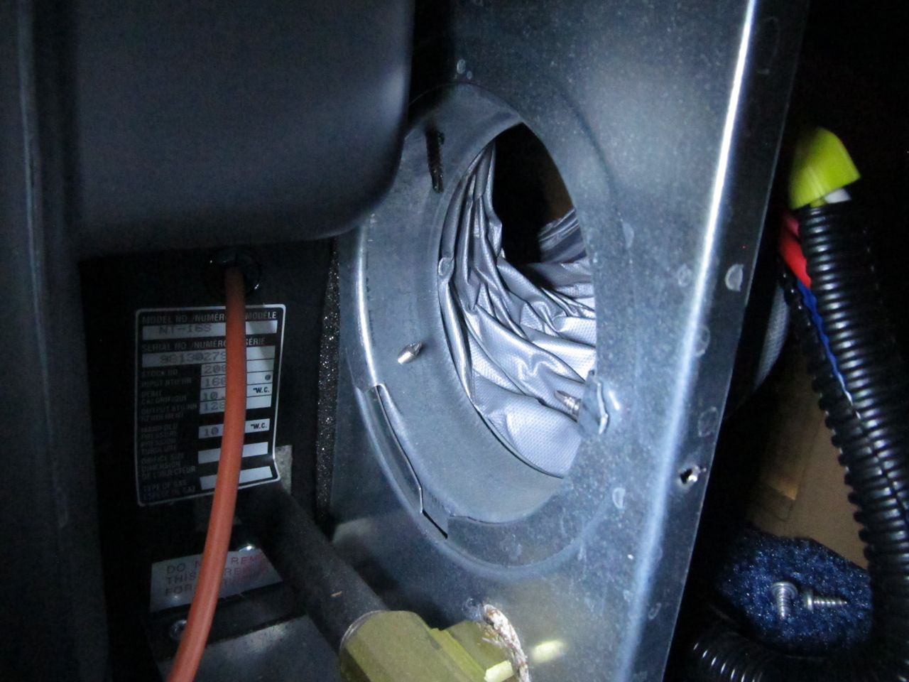

Next I removed the screws holding the other end of the vent hose (to the furnace).

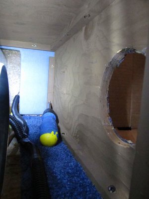

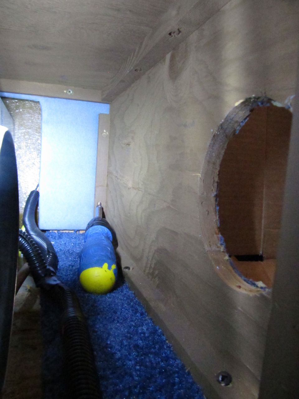

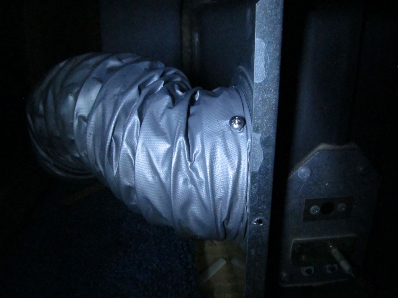

There is a similar vent in the rear side of the box; I removed that similarly.

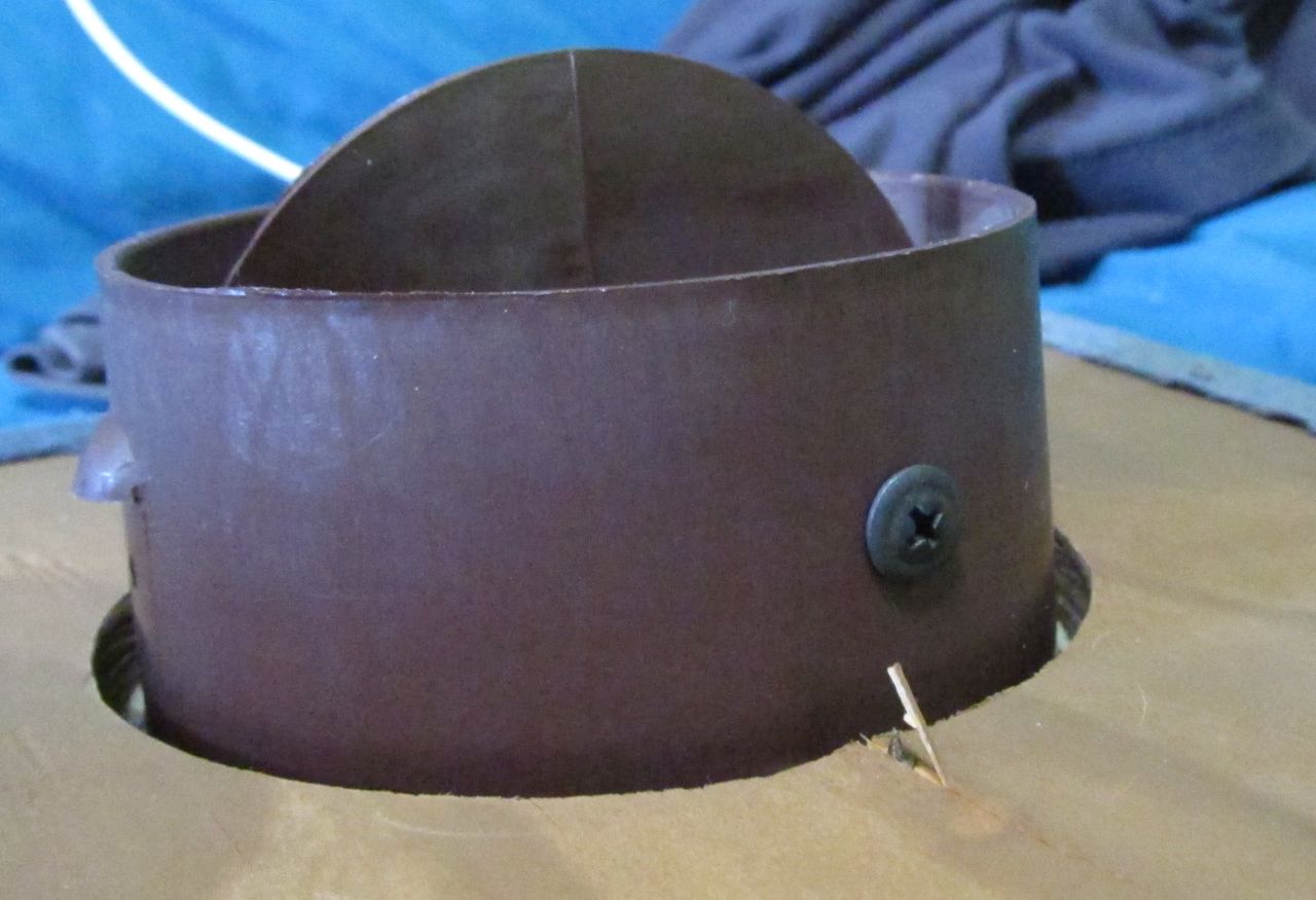

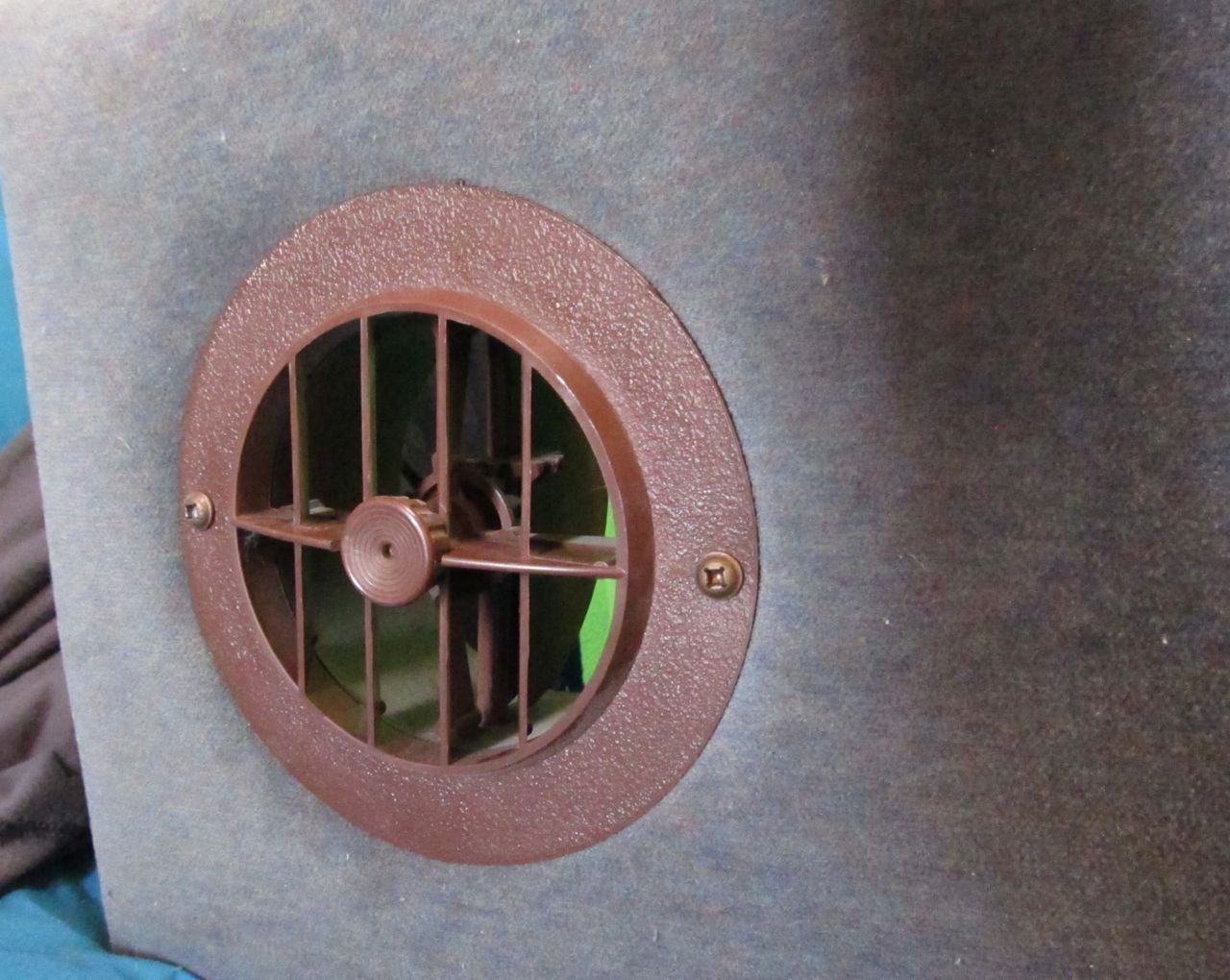

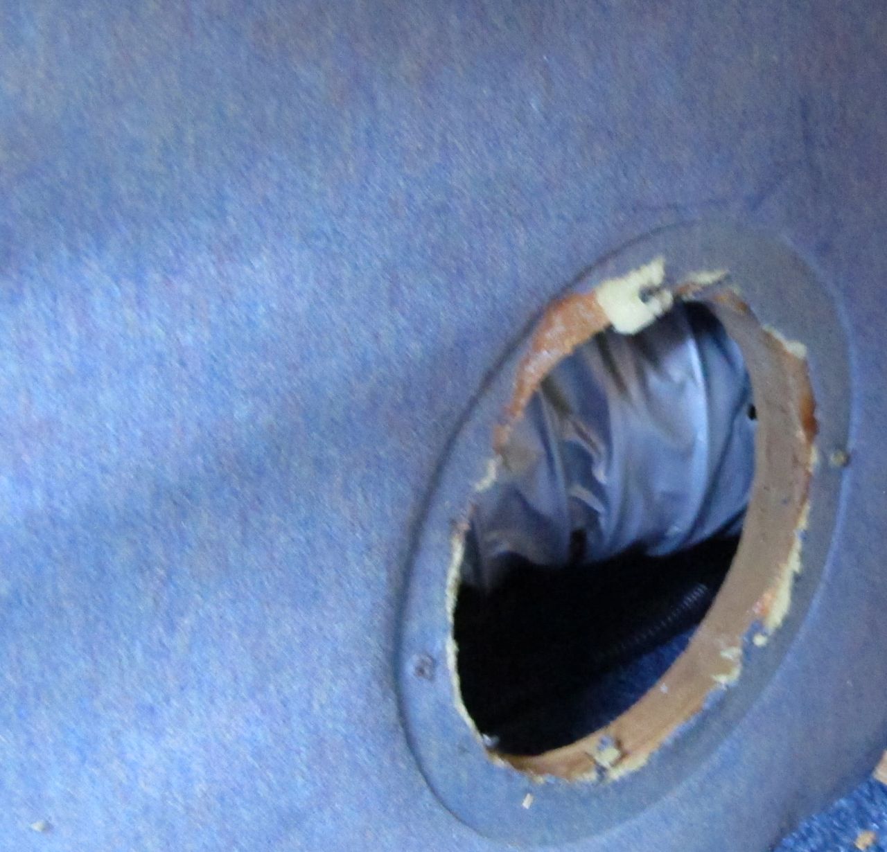

These are the vent holes with the vents (there are two) removed. I replaced them just for looks after I was done so there would not be unsightly holes. I simply put all hose fasteners back in them for safekeeping.

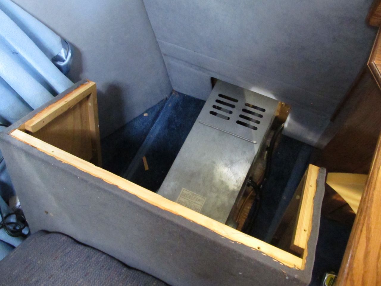

Next I tilted the seat base forward (toward the couch). This can be done pretty easily, and there is no need to remove the club chair from the box. Now there is room to work!

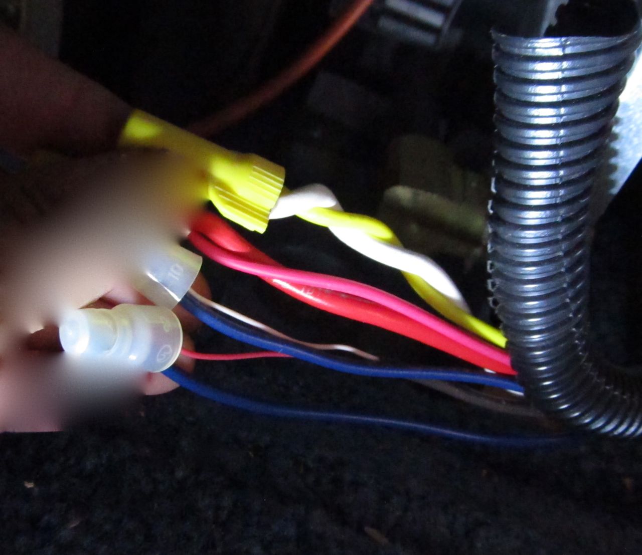

Then I disconnected the wiring, and taped off the wires so nothing could touch while I was working (although fuse was removed as well).
There are power wires (the thicker ones) and then the thermostat wires (thinner ones). There is also a set of wires (I think they are out of the photo) that are in the same general area by the wall, but clearly don't go to the furnace but instead go down through the floor with the gas line. I don't know for sure, but believe these go to the propane tank (perhaps for the vent hood control panel meter).
One caveat is that I'm not positive whether removing the thermostat wires will affect the air-conditioner. I do know from reading Glenn's blog that when he removed his air conditioner, he had to have some wiring re-connected/differently (?) in order to use the furnace without the air conditioner in place (the 4-button "control center" apparently feeds both). The reason I can't say is that I also removed the air conditioner (that would be a separate post).
I plan to use the power feed wire that went to the furnace (not the thermostat wire, but the power wire coming from the fuse panel) to wire up a "charge center" for all my 12-volt devices (cigar lighter/USB). Will be handy right by the table/desk.

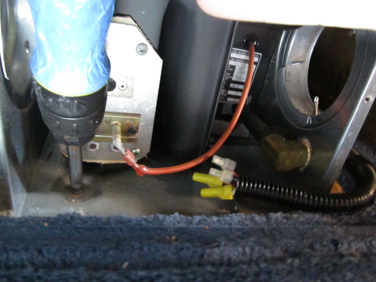

Next I disconnected the propane line (it is a 3/8" flare fitting, takes a 13/16" wrench). There was not even a whiff of propane when I did so, although of course I had no sparks or open flames around (and the propane was shut off at the tank - that's important!). Then I capped it off with a 3/8" flare cap that I had purchased in advance. Flare fittings just tighten to seal (no "tape"). I then turned the gas back on and tested the connection with soap/water. No bubbles and no leaks. I then turned the gas back off and re-bled the system (by burning out a stove burner as before) for the duration of the project (turned it back on again after all was put back and done). This propane line and cap will show in a later photo.
Then I removed the two fasteners holding the furnace to the floor (right in front at bottom) (Actually you can see I did this before the wiring, but either way will work fine.)
After this the furnace was "free" from the rig. That said, the way it fits onto the exhaust fitting, is that it simply slips over tubes that project into the rig from the exhaust fitting. One of the tubes projects into the rig/furnace by about 9", so you have to sort of wiggle/pull the furnace straight out until it clears those tubes (see later photo).

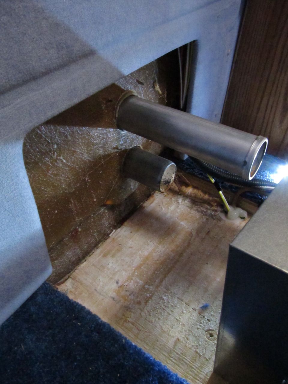

I don't have photos of this next part, but I (later in the day) removed this fitting from the outside of the rig, capped off the tubes (so no insects or water could get in) and then reinstalled it with new bedding compound (the old putty was a bit tired anyway). It was pretty straightforward (I used circles of galvanized flashing plus butyl to seal them off). I may order an entire new intake/exhaust fitting and then saw off the long tube. This way I could not have the long tube in the way, but also have the "stock" fitting for future potential furnace re-installation.

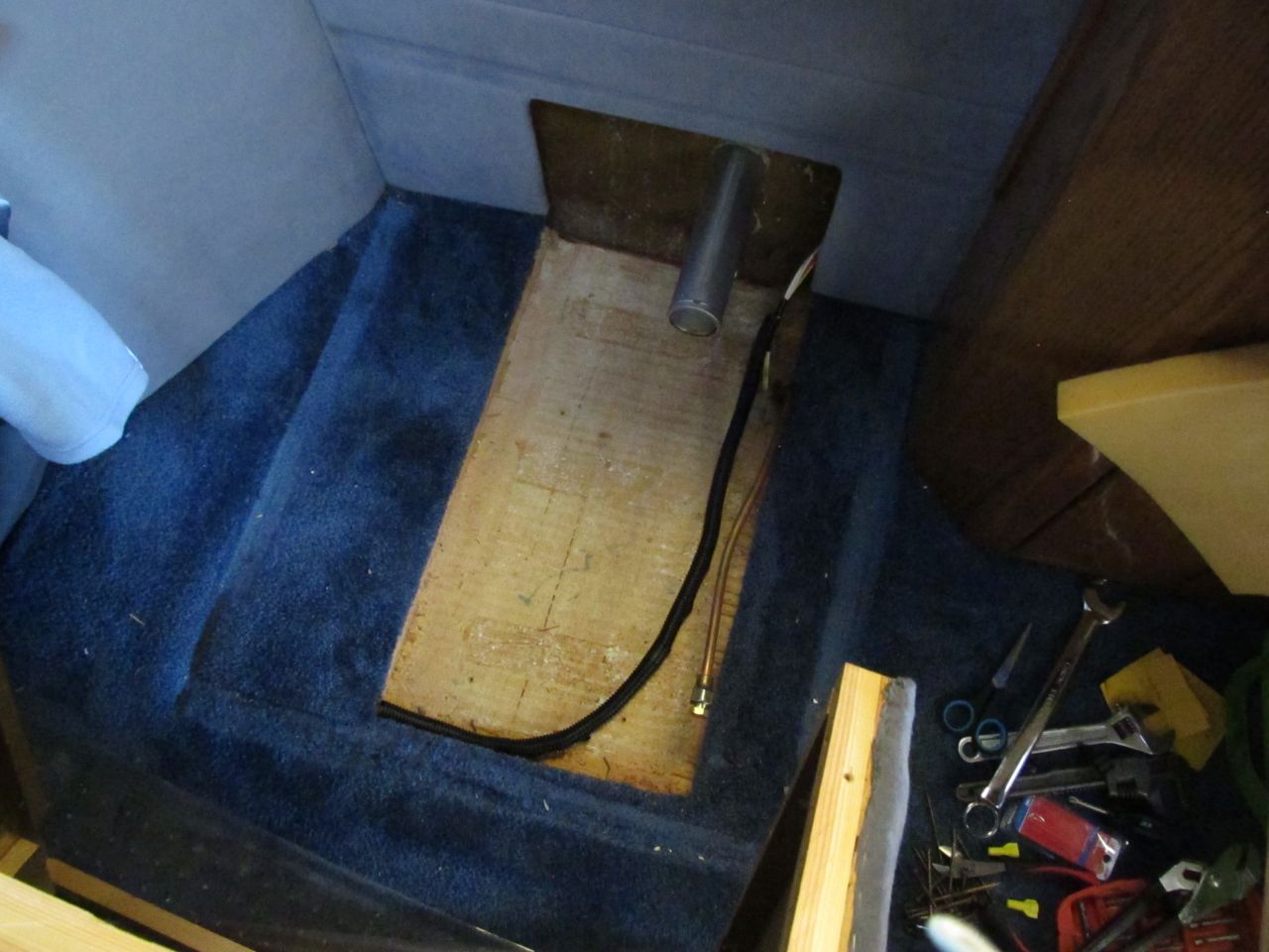

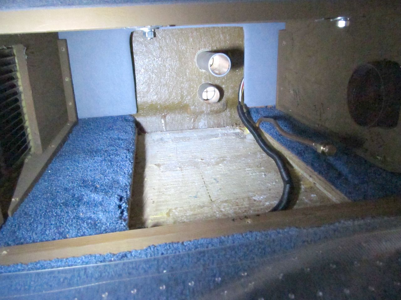

Next is a photo of the underseat area with the furnace removed. The section that is "raw" plywood is a bit lower than the rest of the floor. I believe this was so the furnace could be as low as possible, so the seat box wouldn't have to be any higher. It could easily be filled in to make a level floor, although I have left it as is because it happens to hold a storage box I have perfectly. The black J shaped thing is the wiring inside the protective loom. It's totally flexible/movable but just happens to by lying where it is in the photo. You can also see the capped off propane line to the right. This lies in a fairly protected area along the right side of the seat box once it is back in place. Of course one could shorten it to completely get it out of the way if desired.
After this I reinstalled the seat box (so much easier without the furnace in the way), and then reveled in the new storage space! Sweet!

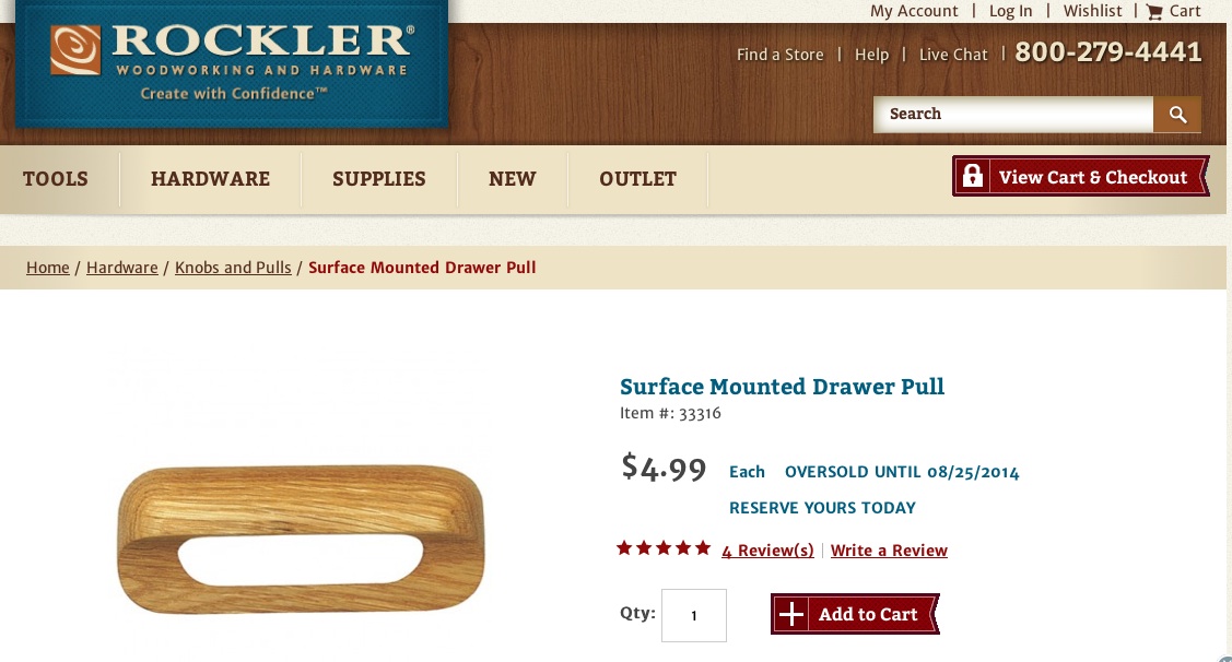

After the chair/base are re-fastened to the rig, the front "door" to the compartment snaps back into clips inside the boxes just by lining it up and giving it a thwack. I have gear stored here that I don't access super often, but I still think I'm going to convert this door into a hinged/handled door to match the other seat box and make for easier opening. It would work just fine even with the furnace back in place. I found a wooden handle/pull online that looks like a great match for the stock one in my rig (there is currently one on the rear seat base and also one on the under-couch "door." Here is a link to that handle.
http://www.rockler.com/surface-mounted-drawer-pull
