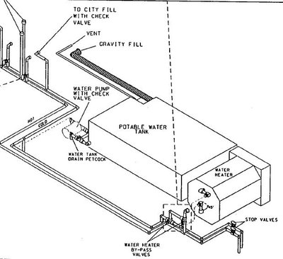

You can see the gravity fill pipe/hose and vent line from under the couch as they route up to the back of the "service center" (the name for the locked exterior door). Here's the fresh water tank plumbing part of the diagram.
Re: Sanitizing the water tank
Although just as a note, in real life that vertical "city fill" PEX pipe and the vent/gravity fill are right next to each other on the outside wall. They just drew it "way over to the left" for clarity.
