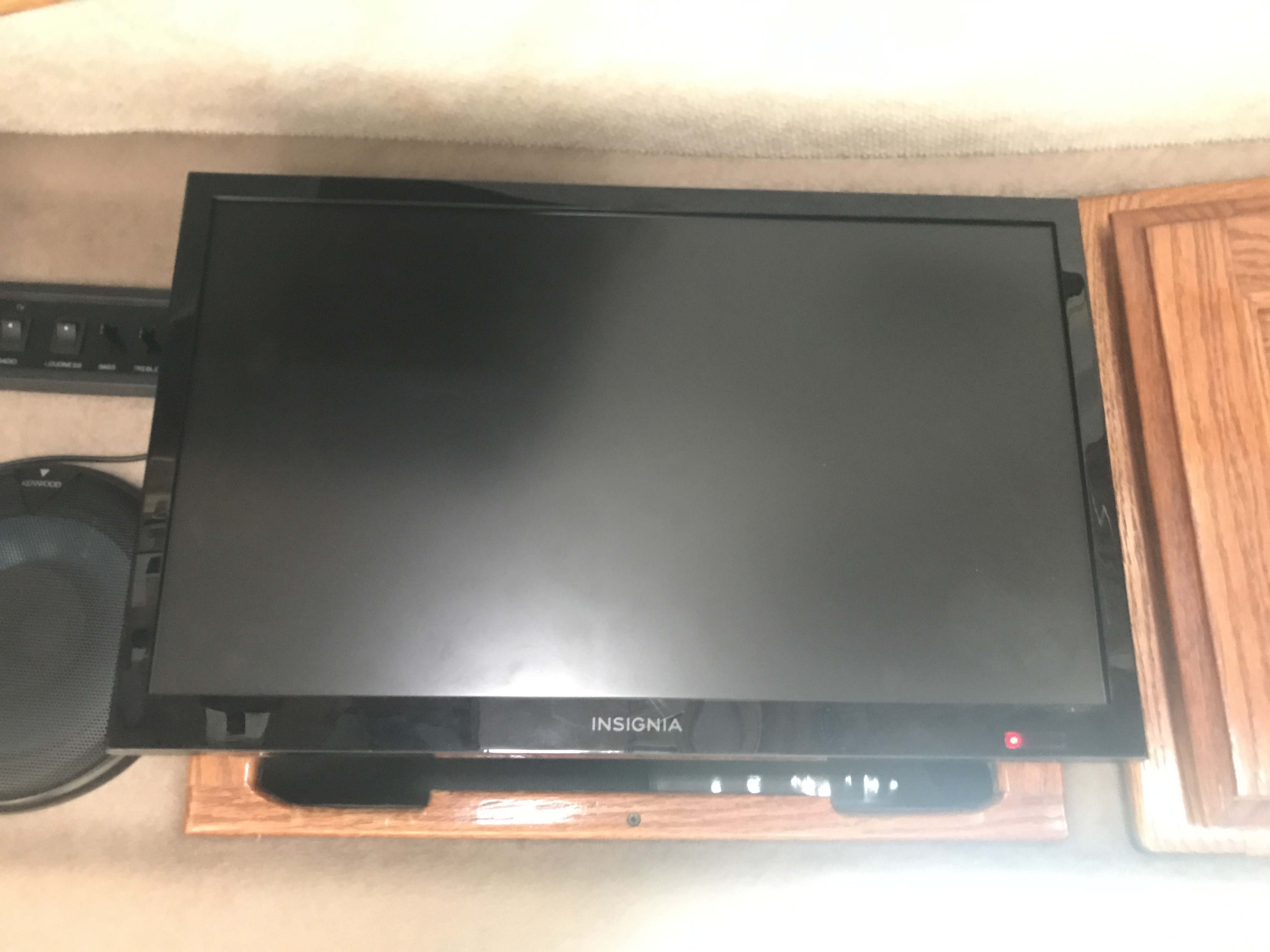

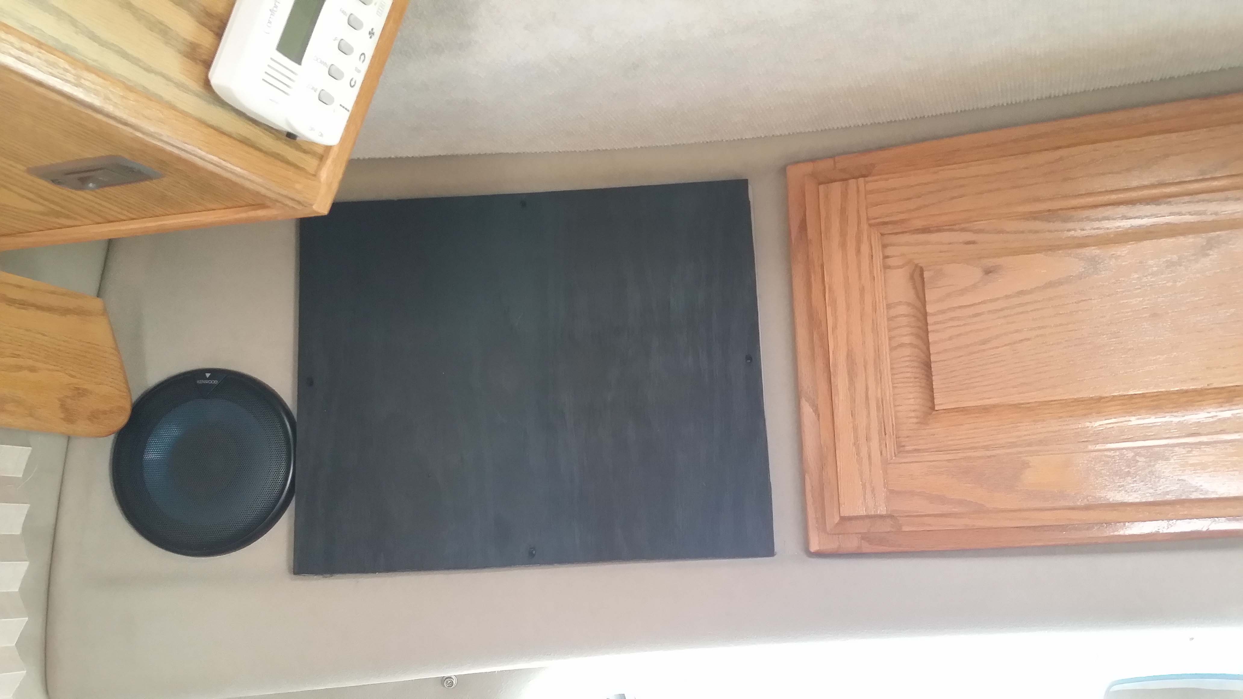

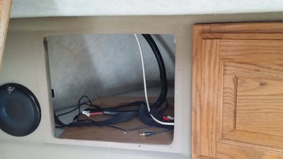

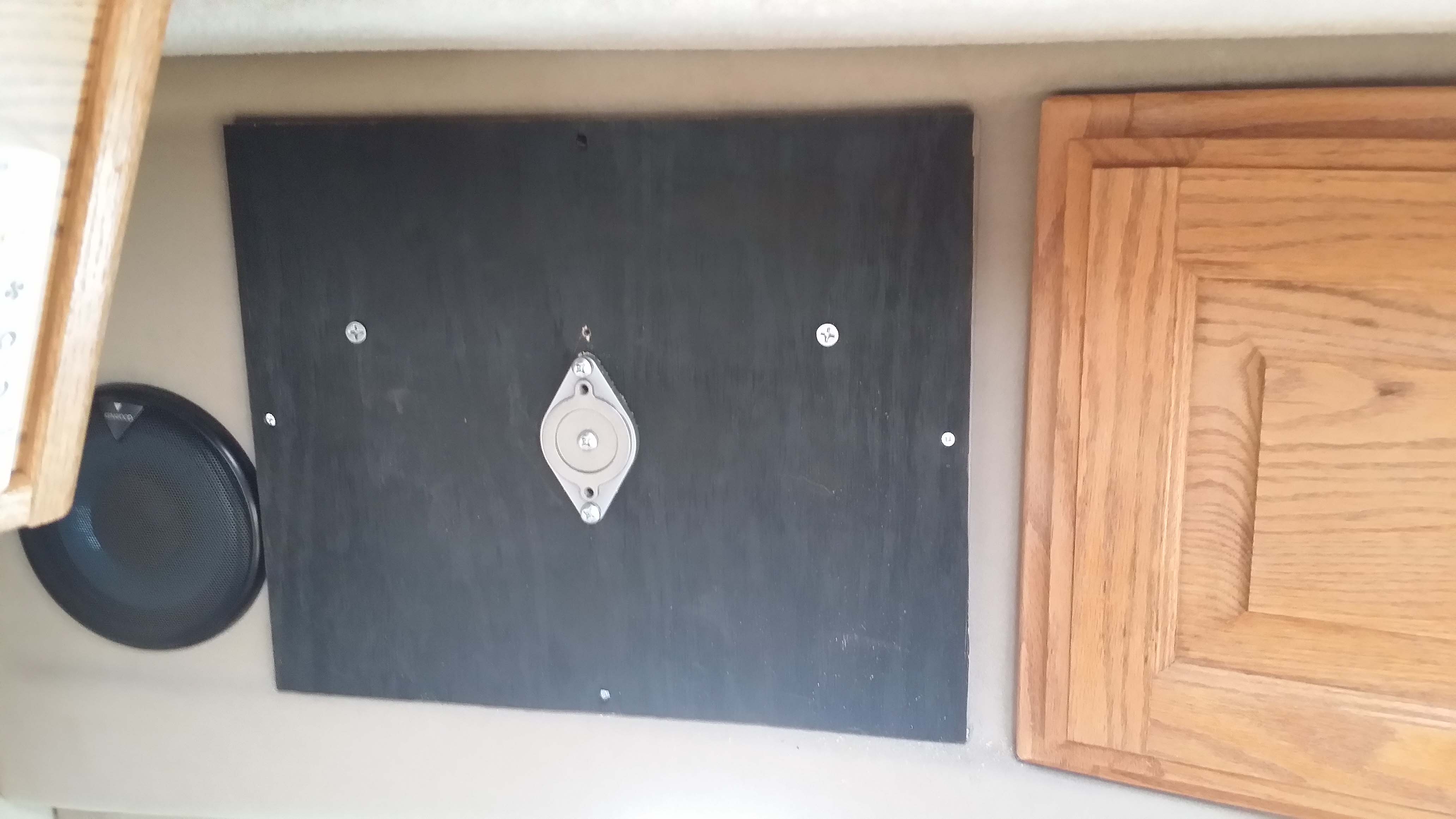

The 1st picture shows the hole after the old tv was taken out. Picture 2 is how that hole is going to be covered. Picture 3 is a cross-member I put in because I'm afraid the sides won't support the tv as it bounces around when I'm driving. My fear is that it would pull out, even though 3 of the 4 sides have wood behind it.

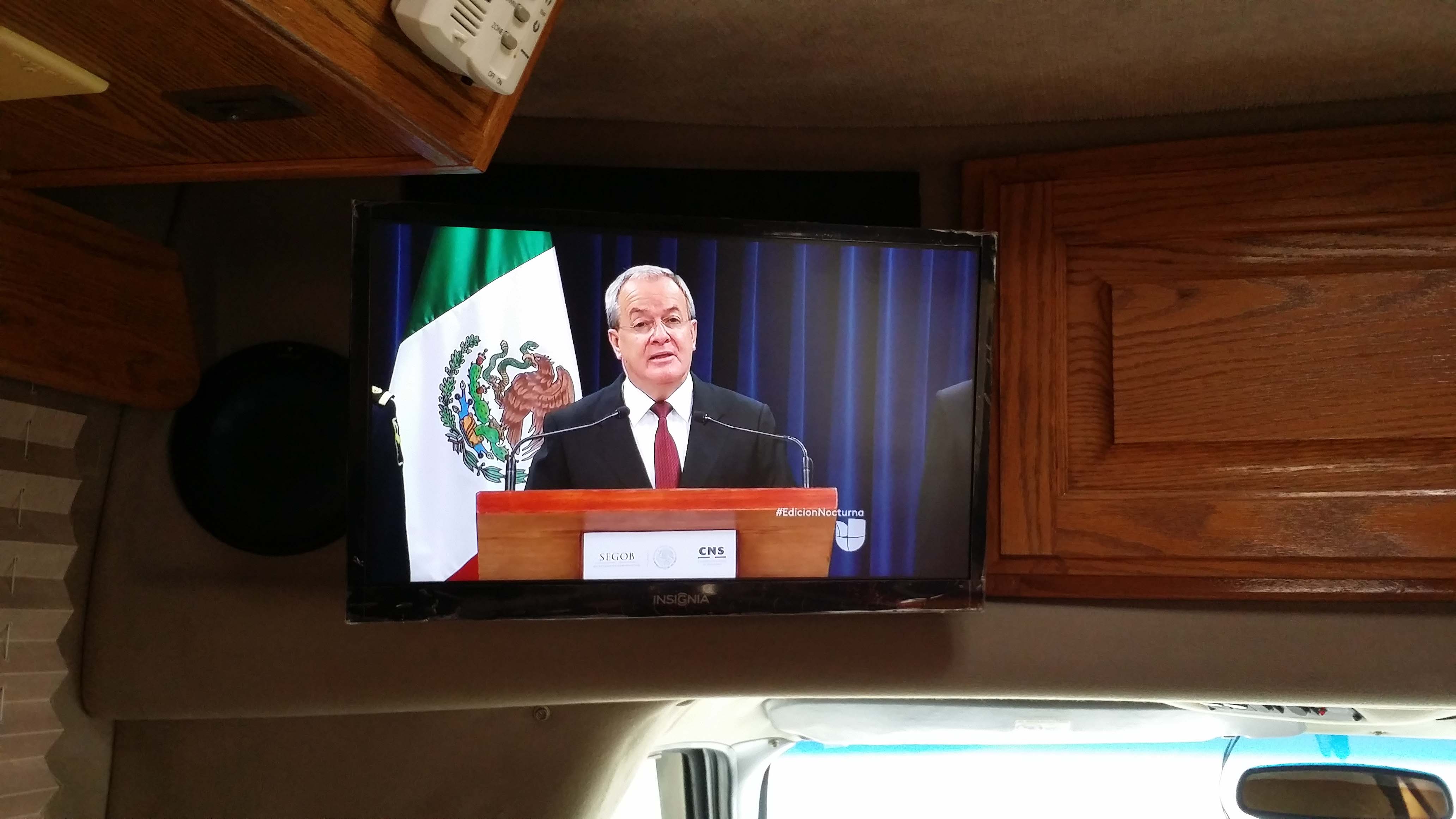

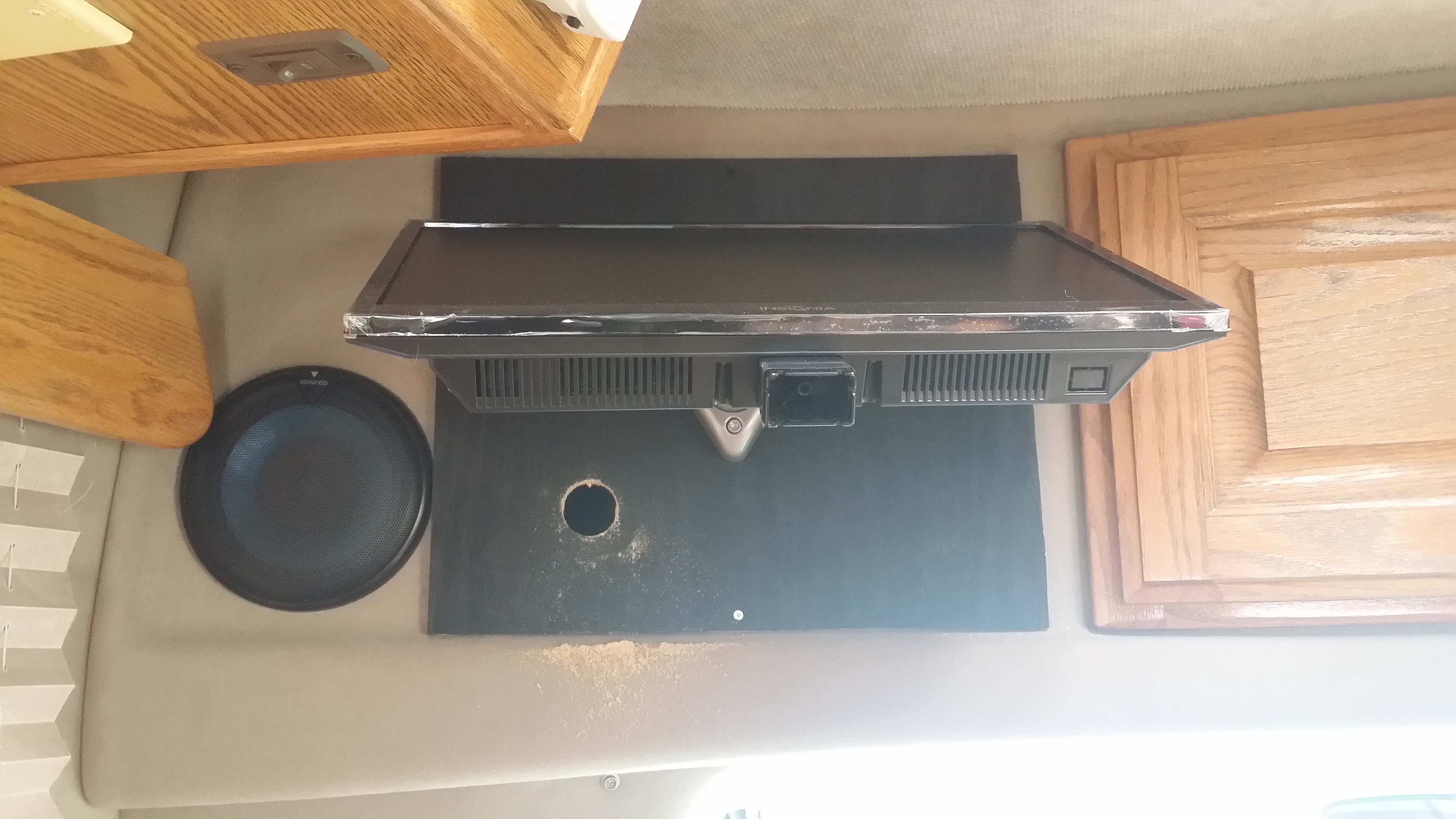

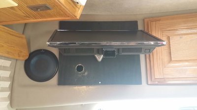

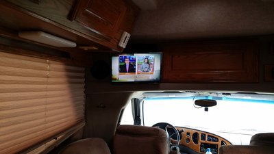

Picture 4 is how the mount goes onto the wood and you can see the other screws I put in to hold it to the cross-member. Picture 5 is the hole I drilled for any cables. I'm considering a grommet or something but I'm not sure any wires will really move around that much. Pic 6 is a close-up after it's all together and getting signal over the air. Univision!
Re: Tv Install
And lastly pic 7, a little further back. I'm pleased with my placement and how the mount articulates on all axis. Between laying on the couch or sitting at the dinette, I have perfect views. I'll have to see how it'll bug me when I need access to the center cabinet. I don't really want to re-drill and I really don't go into that cabinet that often so I might keep things as is.
