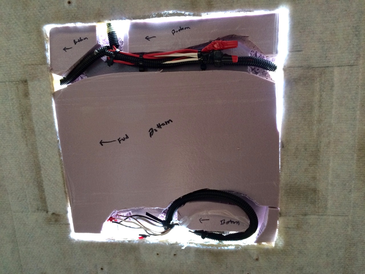

On the inside, there were some wires in the hole. For the Air-con, one piece of Romex type AC wire (comes over from area above stove, through loom in roof), one Cat 5 type cable and one thin wire (for thermostat, came through roof in loom from overcab area near solar controller). They also ran some DC wire that just "happened" to also go through the hole area (the Air-con doesn't project down in the entire hole area, although it covers it all from above). There is a pair of red/white (positive/ground) DC wires that come up through the roof in loom from the main driver's side wiring run that is outboard of the upper cabinets. It starts over about the center of the couch (fore/aft), and runs over to "the hole." In the hole, it splits two ways. One set of red/white go aft, to the ceiling light near the kitchen (in carpeted ceiling), and the other set go forward to the ceiling light and then to the Fantastic vent. (The ceiling light by the door is on the same circuit but that wire comes from over the door).
For the time being, I just used wire ties to "tame" the wires, and then cut two layers of 1/2" extruded polystyrene insulation and friction fit it into the hole. Then I got a piece of foam board (artist type) from Hobby Lobby (happened to find one with a grey "faux something" pattern that just matched the ceiling carpet), put some adhesive "hook" Velcro on it, and stuck it to the ceiling. That covered up not only the hole, but also the flat spots, etc. in the carpet from the Air-con inside section. So that got me tidy looking, insulated, and water-tight. I went with that for around a year while I noodled options. Here is a shot with the wires and insulation in place. The bottom of the photo is the passenger side of the Chinook. So the "bottom" wires are the Air-con related wires, and the "top" wires are the unrelated DC wires.
And here is a not-very-good-but-gives-you-the-idea of the foam board velcroed in place. Stayed up just fine for a year, with no signs of going anywhere. Boy, I can't wait to do something about that yellowed Fantastic Vent. I have already painted those "fake wood" strips on the Thin Lites (there is a thread where I posted about it). [Edited to add: Since taking this photo I used some oxy type carpet cleaner on the inevitable dirt spots in the carpet that coincide with the Air-con outlets. So no more grunge look on the overhead carpet.]

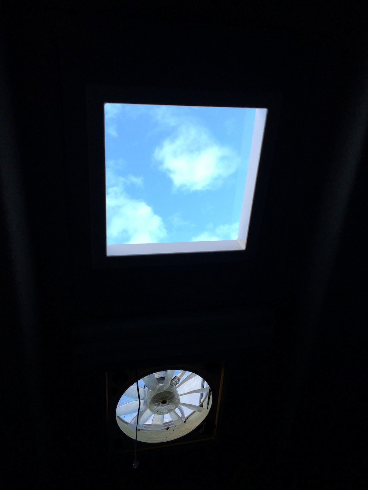

So anyway, during the course of all this, I found that the Air-con hole was in a place that I can easily gaze at while in bed, and I like being able to look up at the stars, etc. So I decided I wanted to try it as a "clear hole" before committing to blocking it off with a solar panel, a solid (yet removable for Air-con reinstall) patch, etc.
Thus I removed the gavanized flashing top piece (all was well with it, btw, watertight and had never budged, so a worthy temp patch), and instead stuck on a sheet of clear acrylic type plastic from Lowe's. Same basic idea as the metal one, but around 18" square. Two side-by-side strips of butyl all around, with corners interlocked. Put it on, then went inside...
Well oh my, was that nice! Glorious, natural light (Concourse side windows are well tinted), and a perfect view of the stars at night from the bed. It was nice! I there and then decided I was not going to cover the hole with a solid patch or a solar panel (I have other places in mind for those) (plus that would have precluded putting Air-con back). Also, making this clear "temporary skylight" last for awhile would give me time to see if I could get the Fantastic Vent ahead of it to stop making noise, and just to see if I feel I want this "skylight" to be operable or if it's fine to have it fixed in place. But would things get too hot...? I lived with it over this past summer. Temps were only mid- to high-80's, but it was sunny all day most of the time. It might (must) have added a bit of heat, but certainly not nearly as much as the side windows, and it was pretty easy to keep things cool with the windows open and Fantastic Vent open.
At any rate, it's good enough to keep in place for awhile. The only fly in the ointment was that I was still staring up through those wires (ugh), and I also didn't want UV rays on the wires, the sides of the cutout (roof core with a caulking layer "buttered" onto it by Chinook), or the butyl up top (through the plastic). Finally, the other day, I decided enough was enough and to do something better!
The stiff Romex type AC wire, I was able to pull on where it comes out over the stove, and thus pull it into the roof at the hole until it was just flush. It could be pulled back out with plyers if the Air-con were going back. The other two small wires (Cat 5 and thermostat wire) could just lie flush. The DC wires I un-wire-nutted and laid out along the sides of the hole and used FTZ crimps to reattach them in the best "lie flat" position. I could have carved into the roof core if necessary, but didn't want to if I didn't have to (I didn't have to as it turned out). I wrapped the wires in some white electrical tape to further protect them from UV coming through. So that was the wires out of the way.

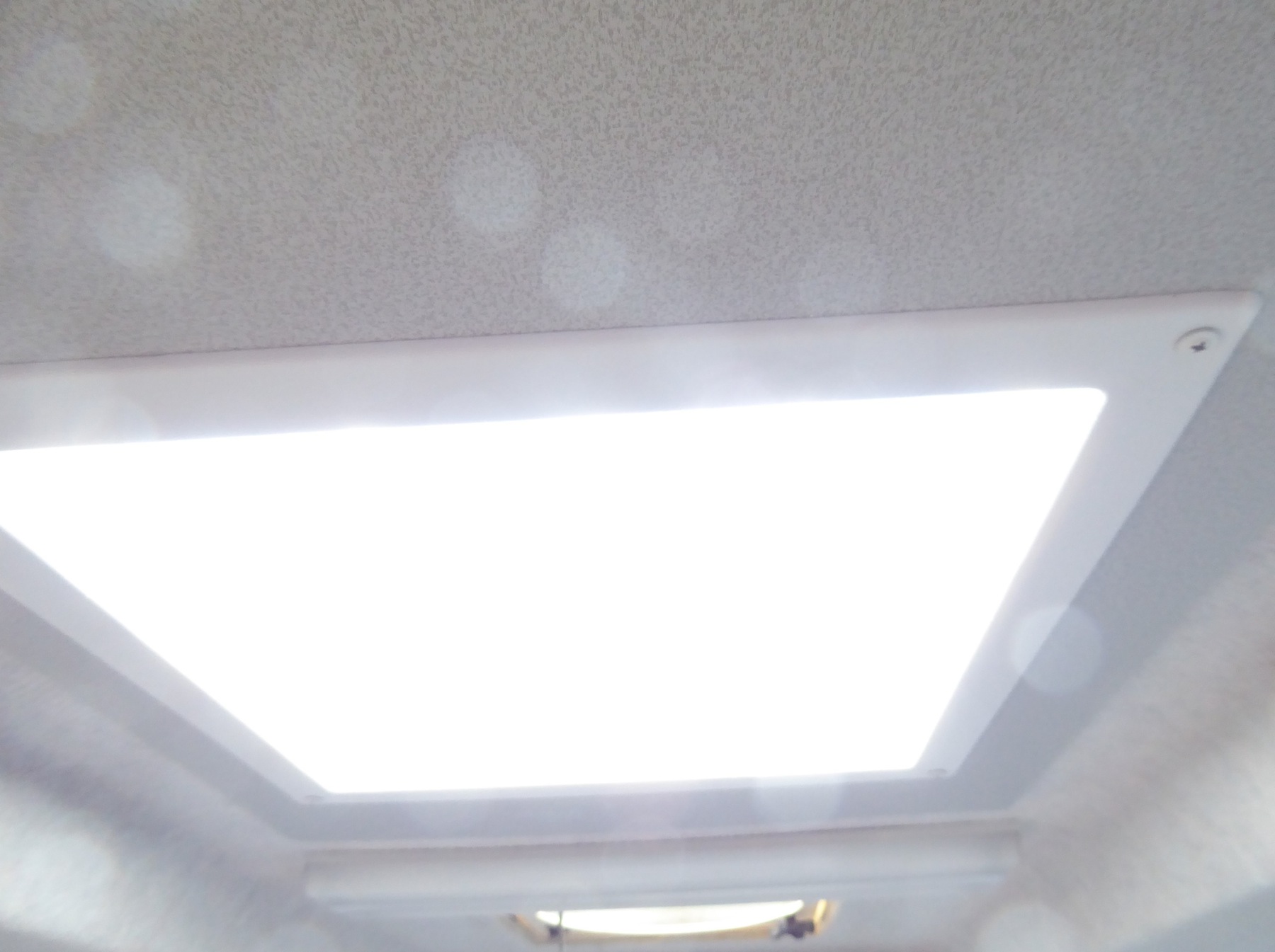

Then I took a Fantastic roof vent garnish (bought it used-but-looked-new for $5 from an RV parts place) and cut it down so that it would juuuuust almost touch the skylight but not quite. I cut a square out of the previously used grey foam board, and then mounted the garnish plus the foam board on the inside. Ah, much tidier! A nice clean look and no more looking through wires.
Now that the garnish was in place, I went up on the roof and used blue tape and paper on the skylight to mask off the area to the inside of the garnish (in other words, the part I can see through from below). With the garnish in place I could see this clearly from the roof side. Then I taped off the roof just to the outside of the edges of the skylight plastic. This left a ~two inch strip of the roof plastic all around the edge of the skylight exposed. I sanded that, cleaned it, and then sprayed it with two coats of white Krylon for plastic. The goal was to cover up with paint all of the part of the skylight that overlapped the roof (and had butyl beneath it), plus the area between the cutout and the garnish flange (thus protecting the wires and the inside of the cutout from UV as well).
Skylight 2.0 Done!

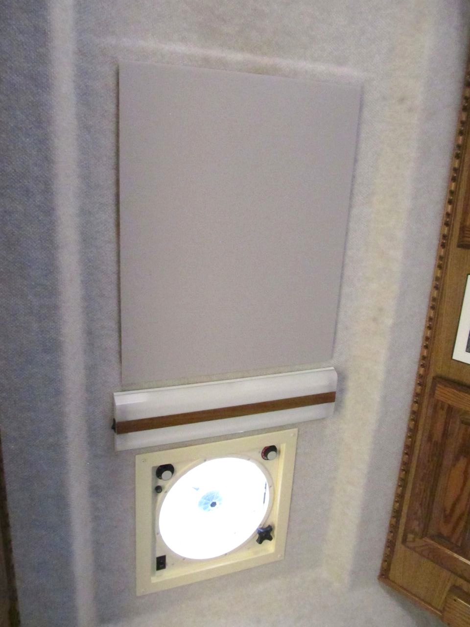

Here are inside views. This first one is very sun-spotted, but it's hard to get a good view of this in the light without that (at least with my photography skills). But it gives you the idea of how the garnish looks on the inside. You can just glimpse the white-painted (previously "walnut") stripe on the Thin Lite cover.

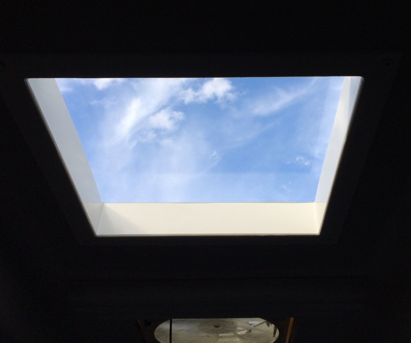

This is how the sky looks, which I really enjoy, especially at night with the stars (but the nice natural light in the interior is much appreciated too):

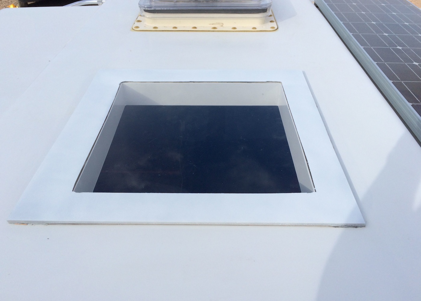

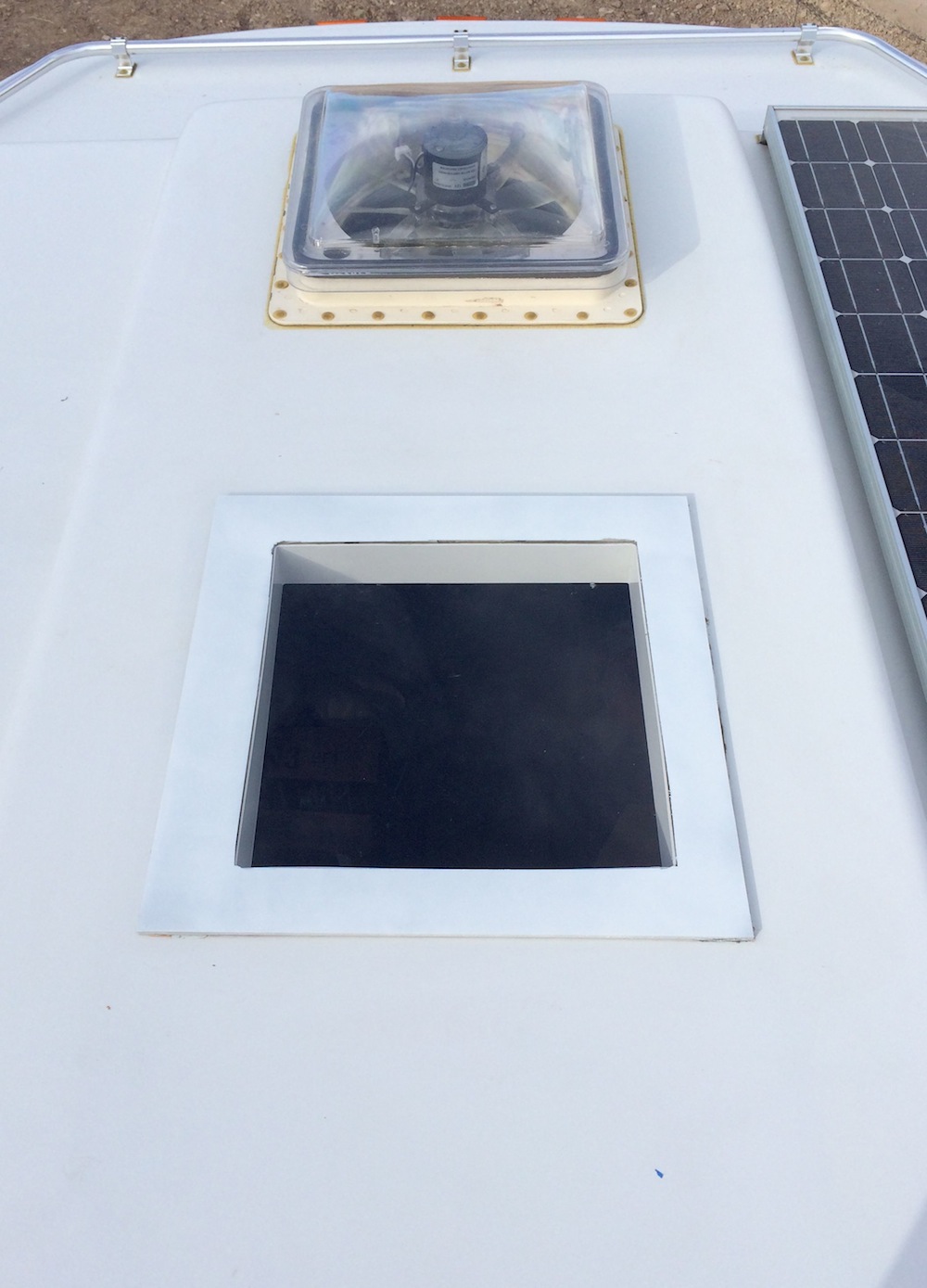

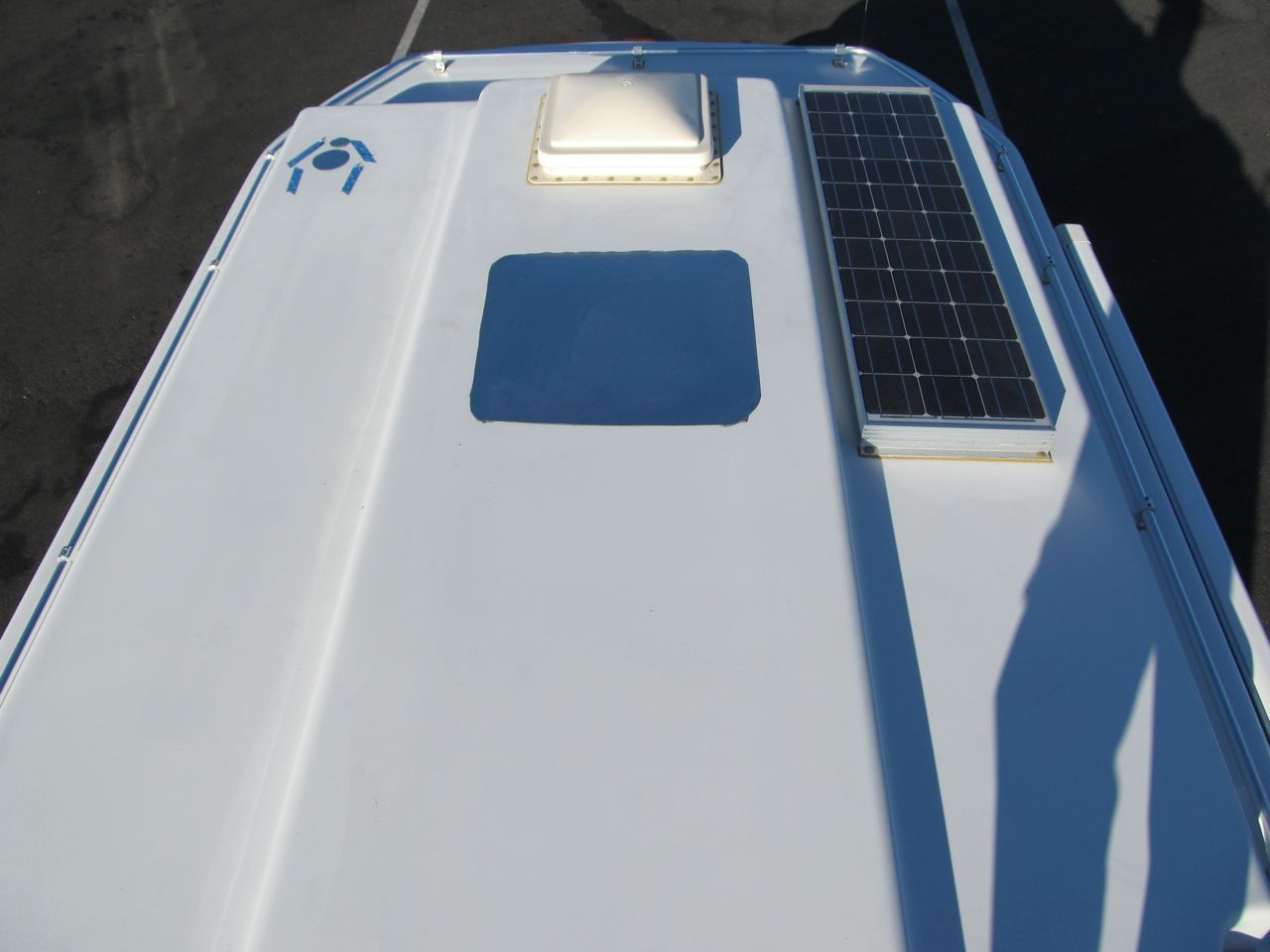

And here is the roof-side view.
Close up:
Skylight is not buckled at the edges, that is just a touch of grey butyl squeeze-out near the corners making it look that way. BTW, there was some very slight sagging of the roof from the Air-con, so I don't mind having that hunka weight off the roof (if I put it back, I'd likely add some reinforcement somehow; otoh, it was up there 14 years and nothing drastic happened).
In time I may upgrade to 3.0 :D Not sure yet what that will be. Likely either leave it the same (with possible substitution of tempered acrylic), put in a marine hatch, or (if I have to) put in a Fantastic Vent and put the skylight where the Fantastic Vent is now (to take care of wind noise, if I can't do it some other way; but that would move the sky view to a less desirable position in the rig)(I think I'll be able to get rid of wind noise somehow).

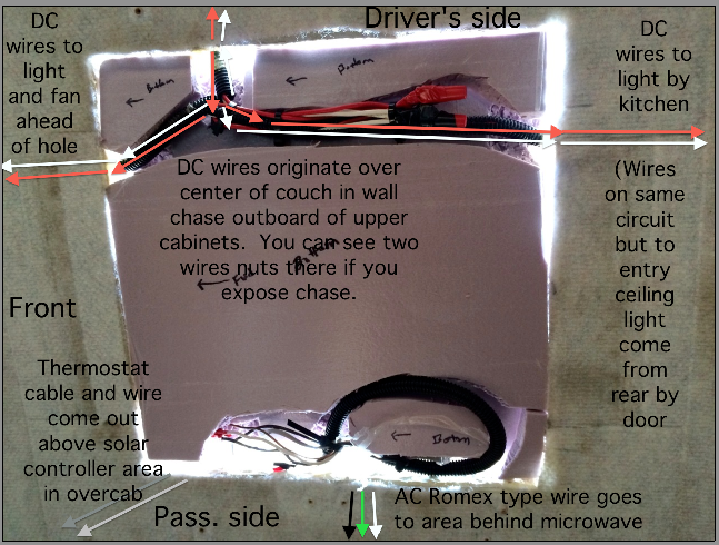

I thought I would add a photo with the wires somewhat labeled. Not sure every year/model would be the same (I was in contact with someone who has a '94 and the Fantastic Vent was nearer the kitchen and the same wires were not in the Air-con hole), but maybe this will help some of us.
Since the Air-con unit doesn't fill the whole hole, like a vent does, there was room for Chinook to run these wires through it.
