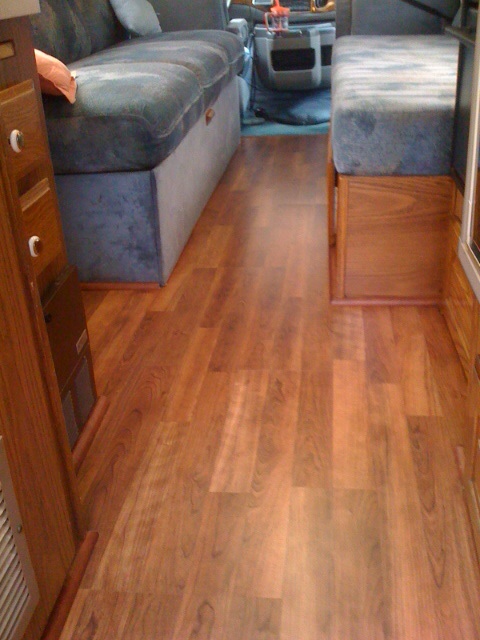

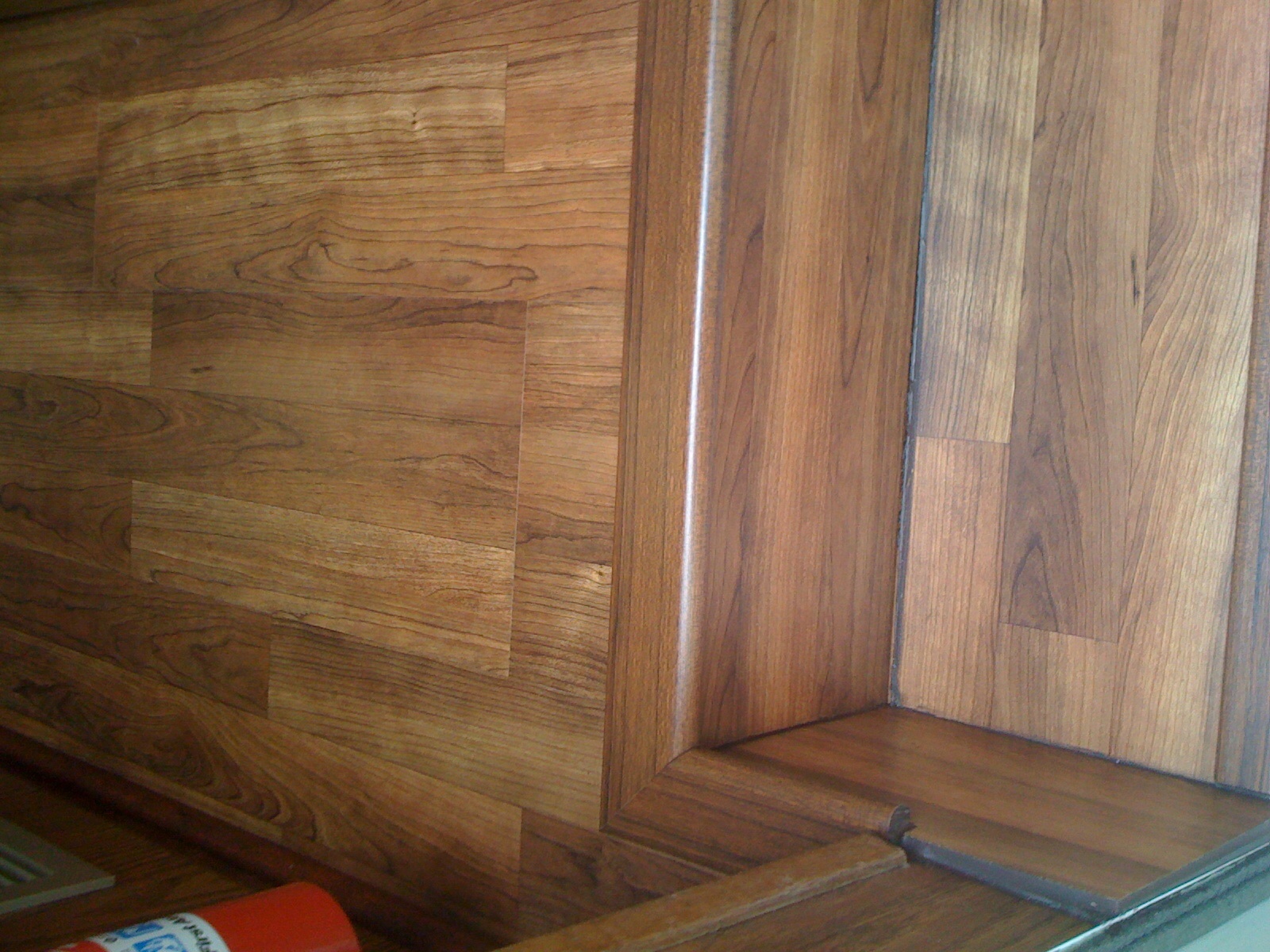

Last year I took out my old dirty blue original rug in my 1997 Concourse and replaced it with laminate flooring. I had a private company which I found online do the work. We ran into problems with a rotten sub-flooring which was damaged by water and ended up having to remove some of the wood under the refrigerator door. I was ultimately pleased with the result. The wood floor is much easier to keep clean. I keep a throw rug at the sink area and at the top of the step to help catch dirt.

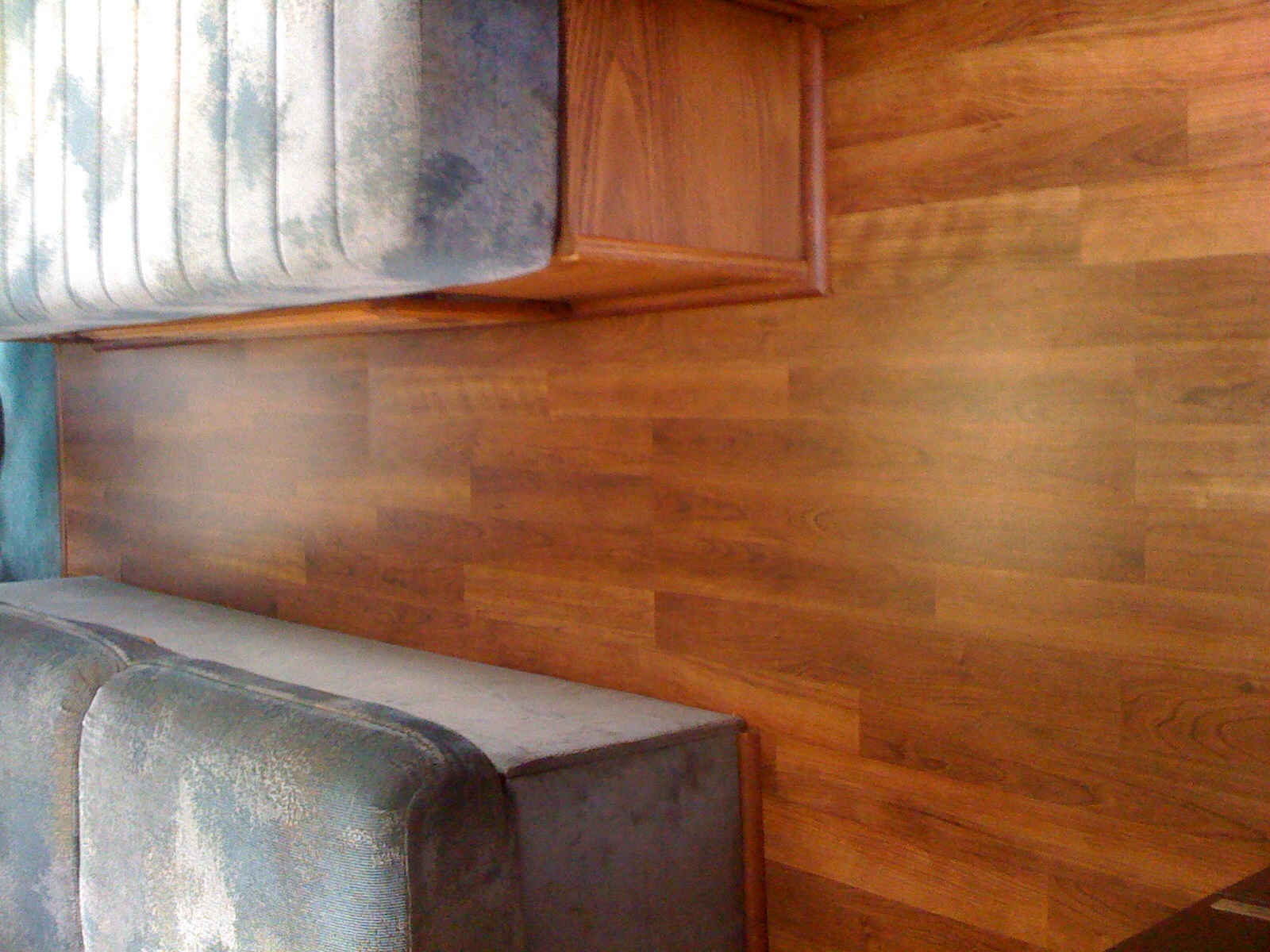

Beautiful flooring. I was thinking to run the boards side to side rather than long ways. There's no denying this is beautiful though.

I really like the fore-and-aft layout, but that's just a personal choice. I cannot WAIT to do my rig. The carpet's in nice shape (came to me with the "grandma and grandpa clear plastic dotted covering so it was virgin underneath :D), so I didn't put it right at the top of the priority list, but these photos .... I think it just *has* to move up my list. Wow.
I'm going to "tip" a couple of them so they are right-side up. I SO appreciate your going through the hair-tearing so we can see them -- I'm sure others do too.
Edited to add: I decided not to tip the sideways photos because I have a 250kb size limit for photos I can upload here, and I see those are 600kb (hmm, Manitou must have special privileges :D ). So rather than shrink them way down and take away detail, probably better for folks to save them and then rotate them on their own computers (thus preserving the larger size and more detail).
I have a couple of questions for you:
1) What did you do about any bolt heads you came across?
2) Do you remember the brand/type of flooring?
Although I'm sure you were not thrilled to discover it, good thing you caught and fixed the rot under the refrigerator. Having read about this issue, I took a good look at the compartment behind the refrigerator access door on the outside of the rig. Now there's an area that could use improvement. Geez. I have made some "temporary but they will last awhile until I do something else" improvements to that area but it's definitely a weak point. I've looked at how they handle it on other rigs and come to the conclusion that it's one of those areas with lots of potential for bad ideas and just hoping water doesn't get in on the part of builders (unrealistic). I'm still on the fence about keeping the propane refrigerator or going to a 12/110 only one, so will probably not do anything more involved until that time (electric-only does not need that extensive outside venting).
Back to your flooring... did I say "Wow"!
I hope you will post more mod photos! I really enjoy them, and especially since you have another "late-90's Classic Blue Stripes" Chinook 8-) Actually the first Chinook I looked at was a 1997 with a blue interior, but it was a Premier (at that time I ended up buying a different type of rig, but I came back to the Chinook this past January and bought my Concourse). I noticed you have a twin couch/bed layout - don't see those too often. And it also looks as though you did a console upgrade (so did I). I bet your rig came with the late-90's Ford "self launching cupholder" console :roll:
