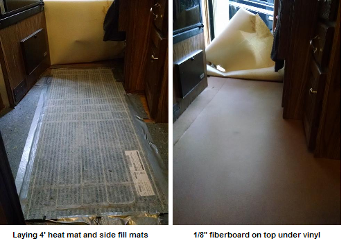

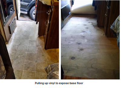

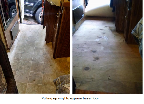

Since I had planned on doing this someday even back when I installed the rear flooring a year ago, it was pretty easy to undo the caulking, pull it out from under the walls, fold it back, and get back to a bare floor. (I didn't glue it down; I only used some double-sided carpet tape here and there.)
Then I laid the heat mat at an angle to cover the walk back to the bath, edged it with the fake mat to keep the floor level, oh and routed out a little floor spot for the temperature sensor, and ran all the wires under the sink cabinet. Next I overlaid it with the hardboard (aka fiberboard).

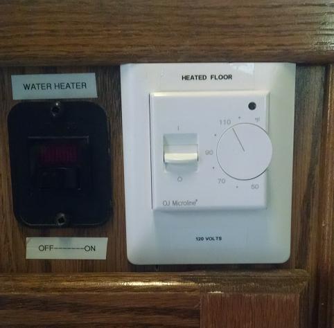

Finally, I replaced the original flooring on top (not pictured). I then modified the thermostat cover to fit next to the hot water heater switch on my sink cabinet, by slicing off one edge to fit above the cabinet door and under the sink border:

Okay, so the results: using an IR temperature gun, I found that after a few minutes with the 'stat set to high (110 degrees), the areas directly over the wires heated up to 85 degrees, which is (according to everything I've read on the web) the ideal max temperature to have under vinyl, carpet or laminate. I'm looking forward to winter for the first time :)
