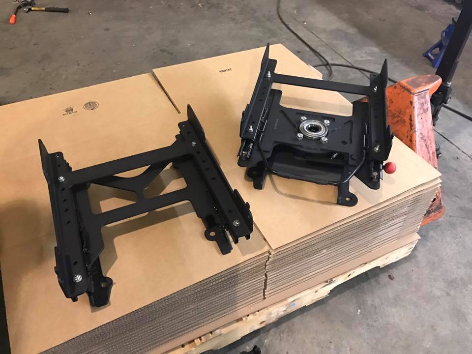

How are the Sienna seats attached so they swivel?

Re: Willy's Mods Phase 2!
What year Toyota Sienna did your seats come out of? Are they powered?

I think they are from 2004- current second row seats. That's the best part, they are not power so it so easy to install them.HoosierB wrote:What year Toyota Sienna did your seats come out of? Are they powered?
You have to buy a swivel base, Ujoint 4x4 out of NC makes custom brackets made to mount them as front seats in a ford e350 chassis.pdemarest wrote:How are the Sienna seats attached so they swivel?

Those are the same bases that I bought (from another vendor). *REALLY* nice bit of kit.
But the manual factor is one reason I decided not to go ahead with the Siennas: In the end, I just didn't want to give up my power driver's seat. Not that I mind adjusting manually, but the power seats give adjustments that the manual ones don't have (raise front of seat cushion, for example, or raise or lower whole seat). And too, I just like to move it around a bit when driving on longer trips, which is handy to do with power..
That said, they were really nice seats. And if my original Flexsteel driver/passenger seats were worn out or uncomfortable, I might have made a different choice.

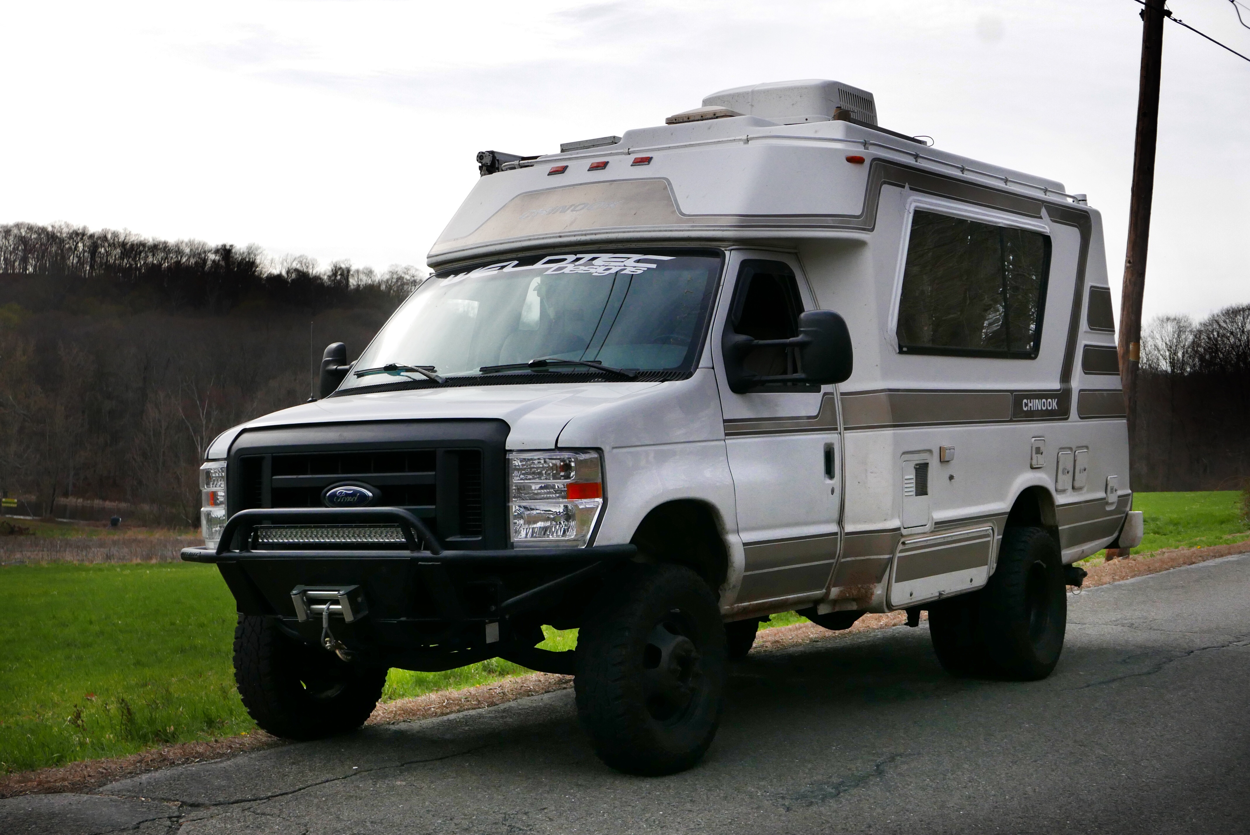

Haven't had much time to work on the Chinook. I did install a TV and today I test fitted my new wheels! Need to machine up some spacers for the rear hopefully this week.

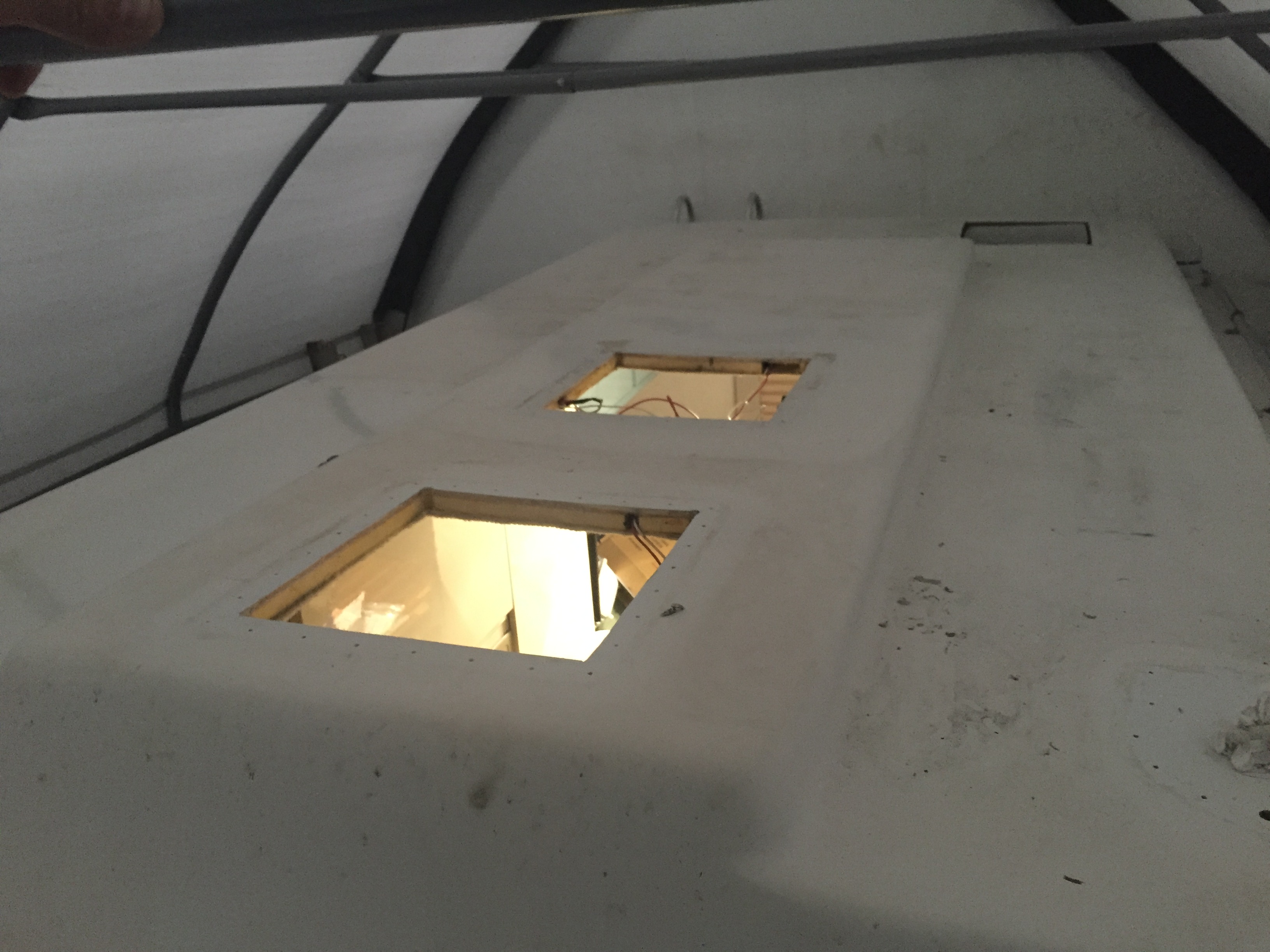

Been slowly collecting parts to overhaul the roof! That includes two new 100 watt solar panel's, new Maxxfan, brackets to build a roof rack,etc. Finally got around to stripping everything off the roof and will be preparing for painting the roof before everything goes back on. Well maybe everything...
Fighting with the wife over putting back the AC unit or not. We rarely hookup and don't like running the generator so it's kind of pointless. Out of our three x-country trips last year and all our local trips with the chinook we used the AC once to cool down the dogs after a hot mid day hike. That is he main reason she wants to keep it, for the dogs haha. Honestly the main reason I want to get rid of it is for aesthetics. I hate how it looks atop the rig, also right down the center would be a way better spot to build the roof rack to hold the surf boards. If she wins I will most likely buy a new AC unit, one of the low profile ones.
Last thing I need to order are two marine deck hatches. One for the bathroom where the current vent fan is shot. The second one I'm going to cut a new hole in the roof 19 x 19 as access to the roof from inside and a nice skylight to let lots of natural light in. Think I'm going to go with Lewmar low profile deck hatch, a little pricey but not sure of a good alternative.

Great roof photo!

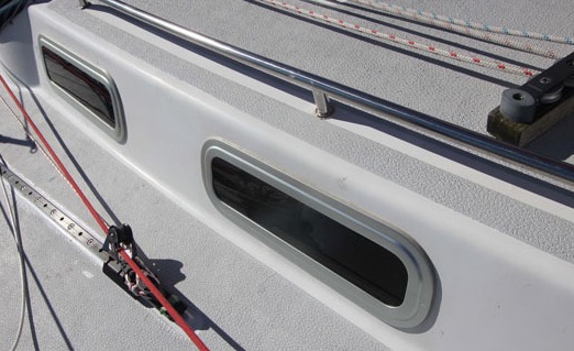

Speaking of letting in light, I've sometimes thought that it's too bad the wedding cake top isn't an inch or so taller...
... as then there'd be room to install some long thin marine portlights along the vertical edges, to let in light and optionally air.
Something like this:
