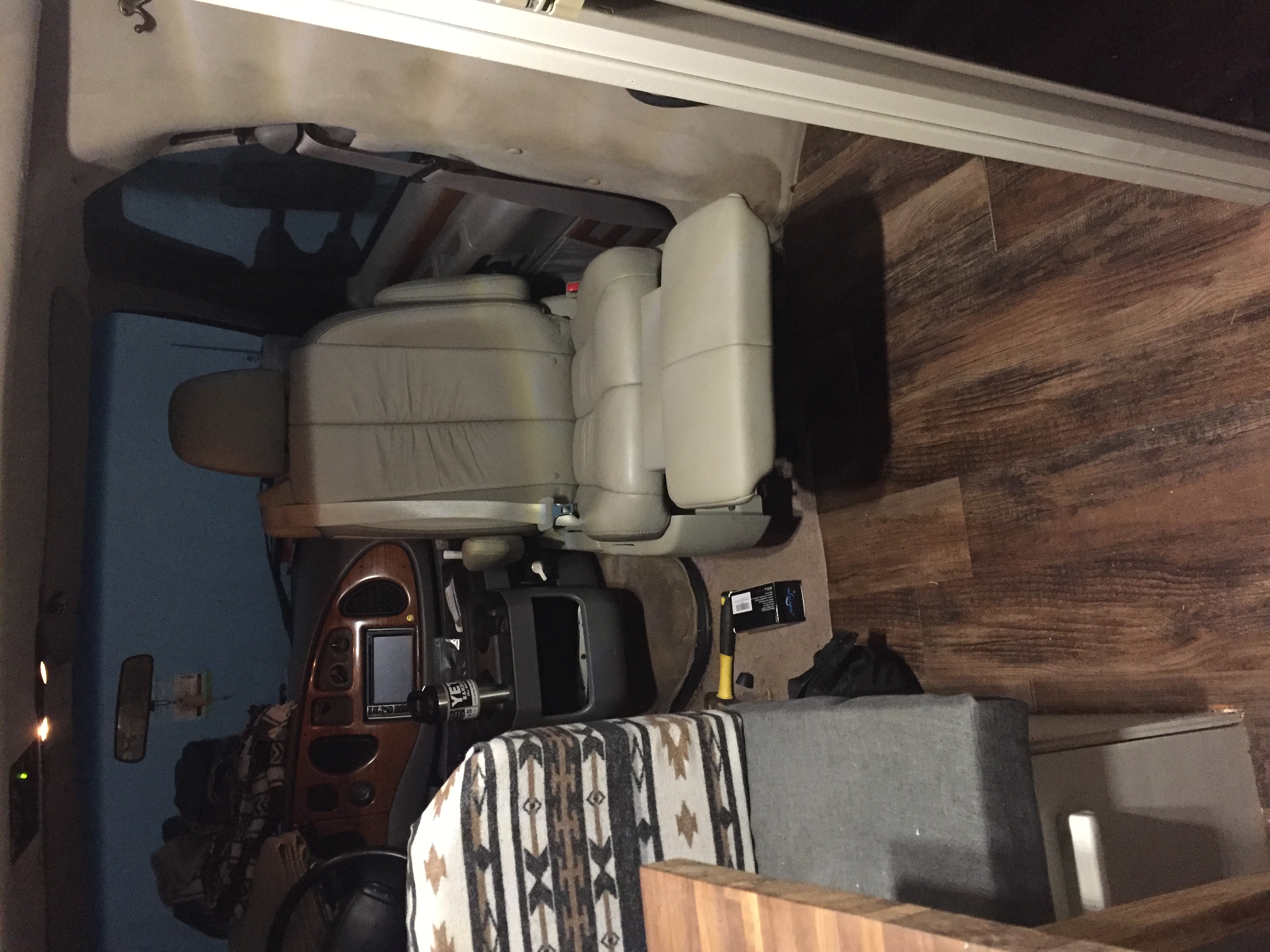

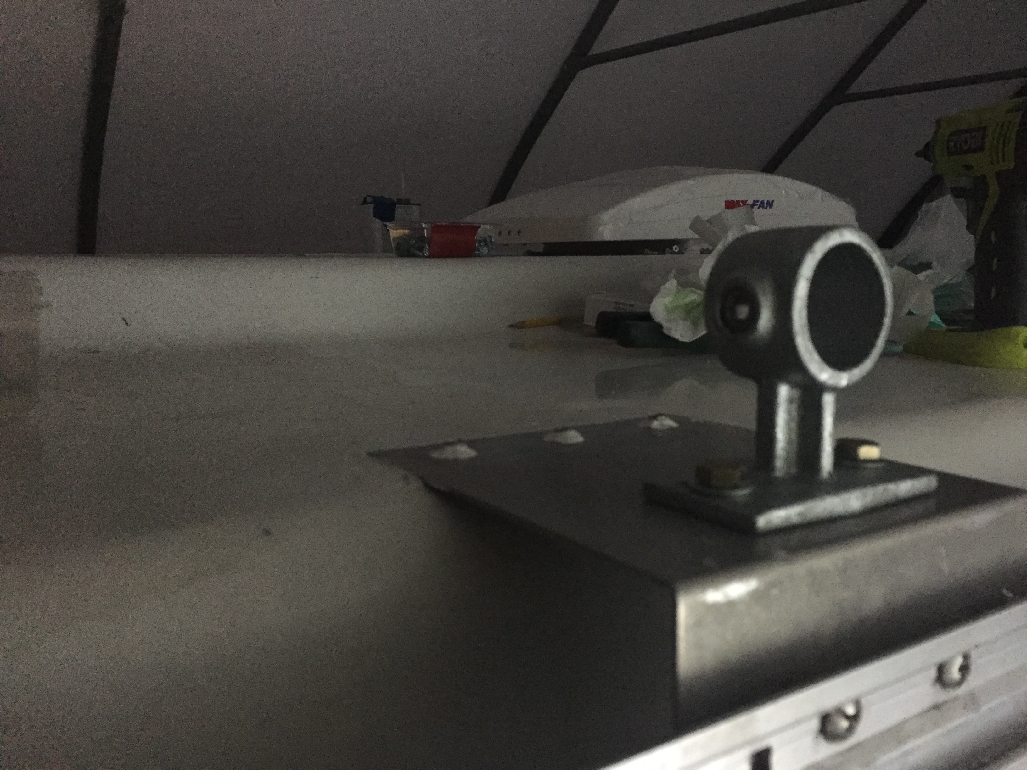

Got the seat brackets fixed (they arrived broken) and ready to go. Also started mounting the hardware for the roof rack!

How much were the base adapters?Willywalderbeast wrote:Oh also got the Sienna seats in!
Any problems with the seat belts or anything else? (doesn't the driver belt have to swap sides?)

I'll be interested to hear where Willy got the bases and the process. When I bought them (a couple of years ago and then I didn't end up using them), I read through the instructions (included photos) and while it looked like there was a fair amount to do (including small metal cuts, etc.), none of it looked too hard. Just methodical this and that and checking off a list.
The bases I bought had you remove the Sienna seat belts and use the stock Ford belts and Ford pre-tensioner. (I think that might be necessary to keep the air bag system functioning correctly.)
