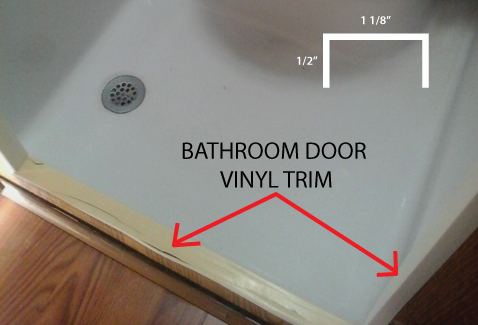

Trying to source new bath door opening vinyl trim. Appears to be a semi-rigid U-channel. Mine has yellowed and cracked. (the dimensions are approximate)

I and others have used this part for the bathroom door trim replacement:HoosierB wrote:Trying to source new bath door opening vinyl trim. Appears to be a semi-rigid U-channel. Mine has yellowed and cracked. (the dimensions are approximate)
ACP - Acoustic Ceiling Wall bracket part number 150-008
https://www.amazon.com/gp/product/B000H ... UTF8&psc=1
You can't tell from the Amazon picture but it is a white square channel piece of plastic that is close in dimensions to the original molding. (in the Amazon picture, it is the part that is screwed to the wall, not the part the "installer" is working with.) It is slightly wider than the original, but not much. My threshold was totally missing when we bought our Chinook, and the MDF "wood" had swelled up like a sponge, so the oversize fit snugly when I used this trim.

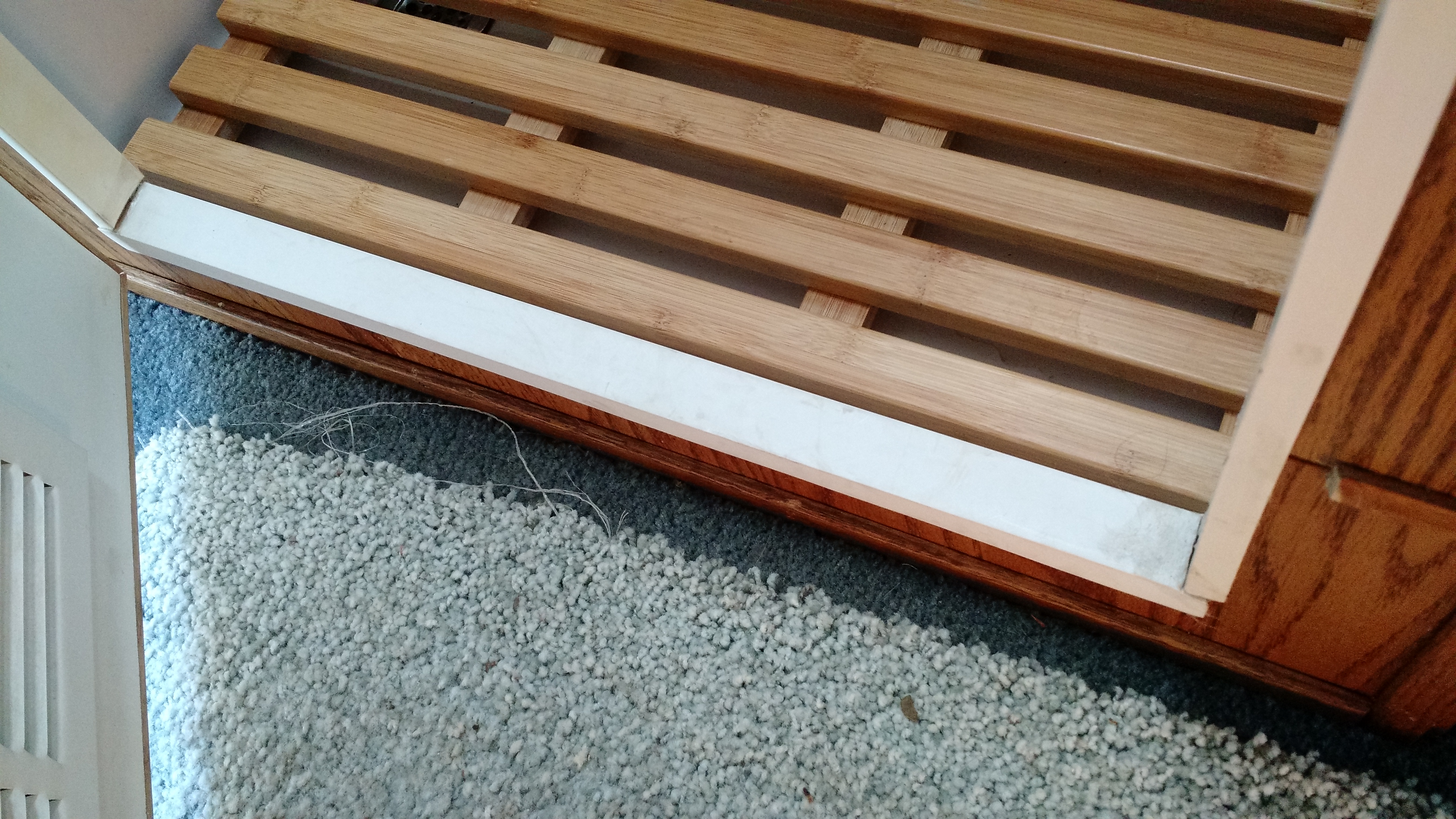

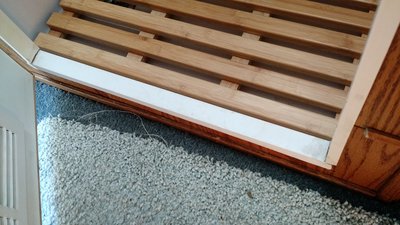

After a while, the MDF pretty much rotted out, and I replaced much of the lower wall around the shower with a real solid oak panel, so moisture wouldn't hurt in the future. Here is a picture of the threshold trim replaced (you can see the seam where the new oak wall meets the old about 6 inches up on the right). I actually bought some pieces to replace the sides and top trim, but the original trim was still pretty good and fit better, so I didn't use them.

Clay: Thanks for the "ceiling bracket" info! The local home improvement store sells that exact item. I will pick it up tomorrow.

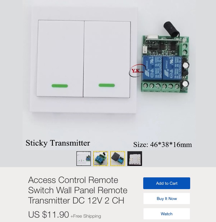

2. Use a 12v wireless switch set. The wall switch runs off a battery just like a key fob, and can be stuck anywhere. The wireless receiver and relay(s) runs off the light wiring.
Here's one on eBay with two switches and two relays, perfect for the bath light and fan, or two sets of lights. There are also lots of variations with key fobs and dimmers. Fobs can also be wall mounted. My main cabin overhead lights are each on a wireless dimmer receiver, all programmed to respond to the same fob.
Some come with two fobs, which allows you to use the extra fob as a second remote control at the other end of the cabin, just like having a set of threeway switches in your house.
