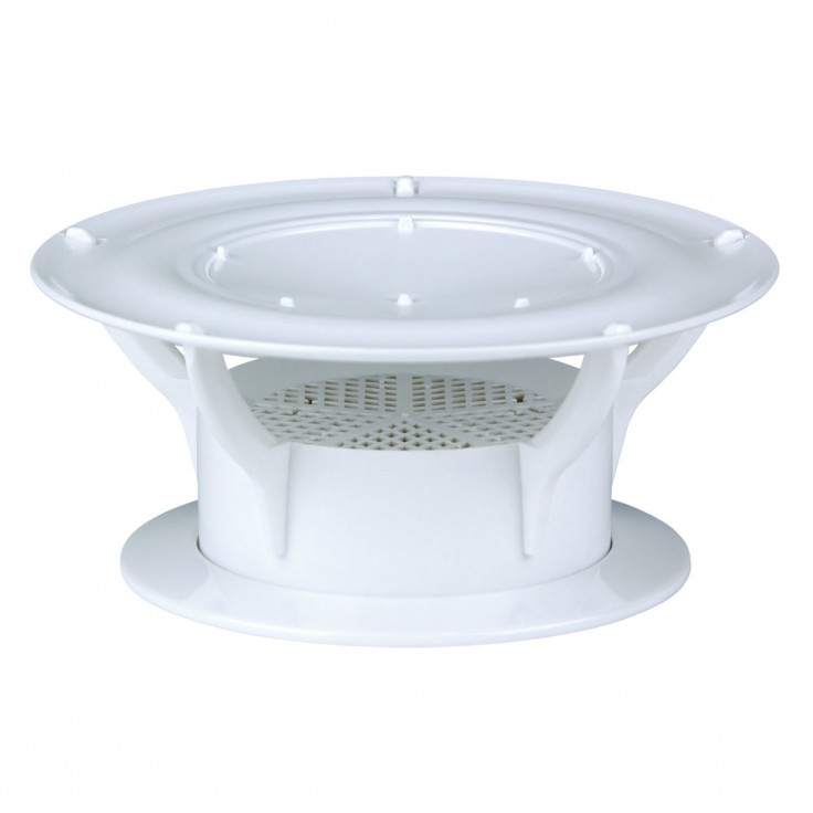

Has anyone replaced their holding tank roof vent cap with a Lippert 360 Siphon Vent Cap? Claims to extract tank odors with as little as a 2.5mph breeze. Any installation tips and performance results would be welcome.

BG... I was wondering the same, hence my post. Apparently under certain conditions a "back pressure" may be created causing the gasses to blow back into the coach.
I was considering this mod as more "preventive maintenance" than anything else since my vent cap needs replacing.
Here is the Lippert Components product explanation:
The 360 Siphon® RV holding tank vent cap remove odors from the source — the holding tanks — and exhausts them out the roof vent before they have a chance to invade the RV living space. By design, the patented 360 Siphon can only create an updraft, expelling odors and fostering an oxygen-rich environment to speed up waste breakdown. Even environmentally-friendly tank additives can take up to 48 hours after use to fully oxygenate a standard holding tank. The 360 Siphon acts immediately after installation in any wind condition (with or without a breeze) to provide the ideal environment for proper decomposition, so caustic chemicals and perfumed cover-ups are no longer needed.

I just replaced my aging and rather ugly “Cyclone” sewer vent and researched several options. I did look at the Lippert Components #389381 360 Siphon Roof Vent but not all reviews were positive. Problems claimed were brittle plastic and trapping water. Personally I thought the “siphon” claim a bit gimmicky, just like the supposedly innovative “cyclone” design.
So in accord with my ‘back to basics’ theme I ended up with the generic American Hardware Plumbing Cap #V-015C. It is all metal, low profile and only $7. It uses 5 #8 1” screws and fit perfectly after I cut the inner black ABS vent pipe 1” shorter. There was a void under the roof line where the pipe exited that I filled with styrofoam insulation.

I put one on my rig after the initial post, mostly because the old cap was knocked off by a tree branch that ran in front of me (also cracking my A/C shroud - those darned branches!). Can't tell if there's any difference because I didn't have any sewer smell before but it appears that it will keep the rain out.

FYI update: Plastic is not brittle. Very well made. No evidence of water leaking. It works. It's a vent cap of improved design... simple upgrade replacement if OEM is trashed.
