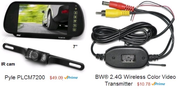

Search the forum for backup camera. E.g. this thread:
viewtopic.php?f=8&t=48&hilit=camera&start=0
Two years ago I bought something similar to Colorider, plus wireless trans/recvrs are dirt cheap these days, too.
File comment: pyle camera

Oooo. Thanks for the memory jog.
Like you, I ordered an extension video cable in case the wireless didn't work, and it had that extra wire. Like you, I figured I could use it to power the camera from the overhead cab switch I installed for my mirror-LCD-display.
As it turned out, the wireless worked fine hooked up to the backup lights, so I have not installed the extension wire.
However, I've often thought of changing the wireless transmitter to be connected to the running lights instead of the backup lights. That way I could just use those to turn it on all the time.
