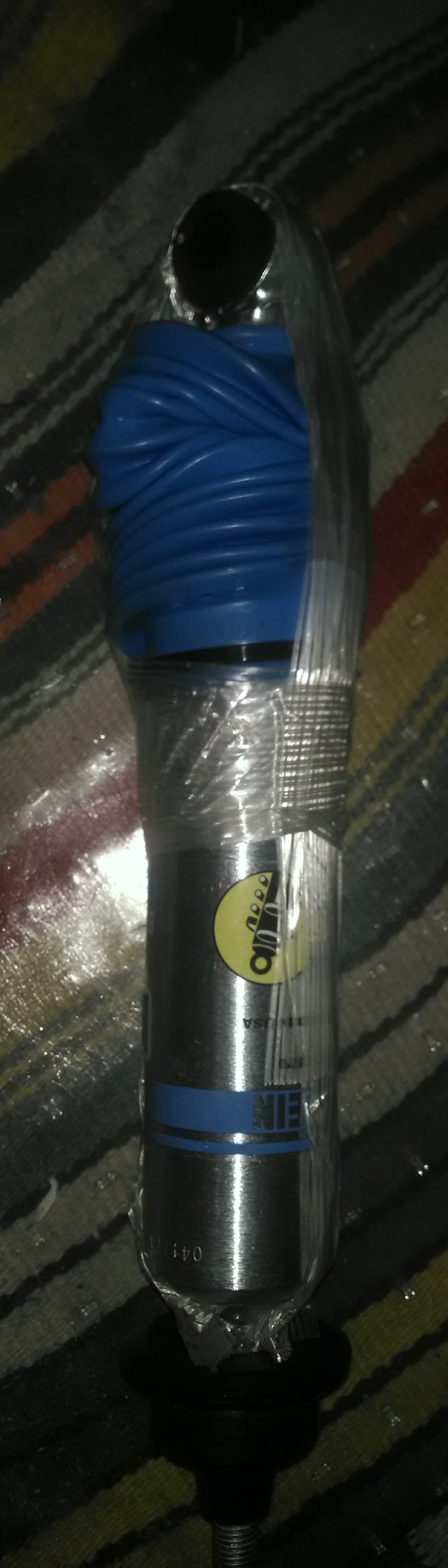

Anyway, mine are now installed! Only took about an hour and a half, partly on putting back the sway bar, and greatly due to figuring out how to compress the shocks for installation. (Gas shocks auto-extend to their full length, making it impossible to install them without manually compressing them, which is an often frustrating task. I am no longer strong enough to do that while under the rig, and Bilstein doesn't send them compressed and tied up like some makers apparently do.)
I've previously had my daughter tie them with string or wire while I pushed down, but this time I finally figured out a way to do it myself without the shock expanding on me while I try to hold and tie it with the same hands, an act that is nearly impossible.
Instead, I stood them each on the floor, pointy end down, and using a cushion, sat on the rounded end until it collapsed to its minimum height. This left my hands free. I previously had wrapped Scotch packing tape (the clear kind with embedded reinforcement strips) around the round bottom, and once compressed, I pulled the tape ends tight against the shock body and wrapped another precut piece around the shock to hold those tape wings in place. Looks like this:
It was now fairly easy to press the round bottoms onto the bottom suspension bolts, then slice the tape with a box cutter and guide the expanding shock up into the top mounting hole.
Btw, duct tape didn't work. The shock expansion was powerful enough to tear it apart. But not the reinforced shipping tape!
