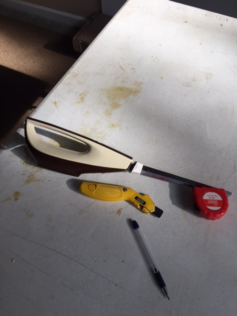

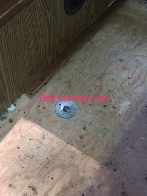

Here's the new $60.00 floor which could have been $40.00 but I fouled up a couple of cuts. The 36 year old electric knife was a great tool to use. Bolts on the floor were no issue using the Traffic Master Travertine Activity Floor Tiles from Home Depot.

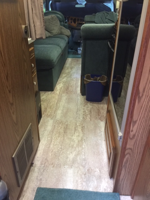

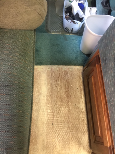

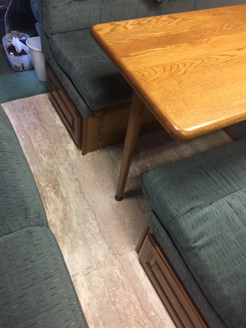

This is the finished project. Not bad.

What did you use the knife for? Removal? Trimming of new? I have what looks like that exact same knife (I use it for cutting foam).

Looks great! Especially impressed with how the cab carpet, to rear tile piece was done without needing a transition strip.

I didn't have any sand under the carpet thank goodness. Only a few staples to remove and then push the remaining carpet back underneath the seats and walls so it wouldn't show. The yellow razor knife cut the carpet with ease as long as I kept a sharp blade in the handle. The electric knife was used to cut the foam squares instead of the razor knife, it provided a cleaner cut. I didn't remove the dinette seats. The bathroom wall wasn't square so I had to use some small pieces of foam as fillers. Two sided tape was used where the squares met at the interlocking section. I'm using a round rubber floor protector to keep the dinette leg from making an indentation in the foam.
