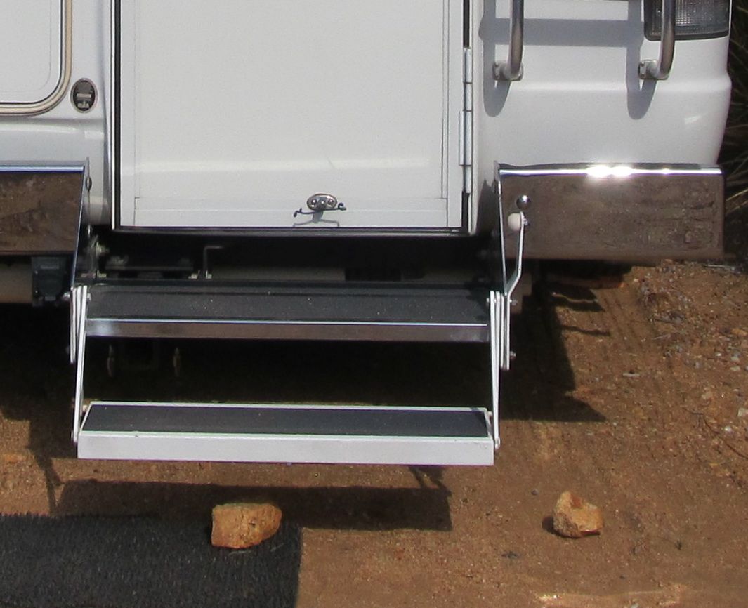

Here's a crop of mine, just for the record. All stock except for the added Gear Tie. As you can see (I hope), the post/ball thingie is on the lower edge of the door, and the rubber receiver is on a metal arm that projects up from the step edge/frame/piece. The twist-tie looking thing that's on the post/ball is a gear tie that I just keep twisted on the post all the time (replace with another every six months or so). When door is open, I twist the two ends around the flat vertical metal arm where the rubber stopper is. Totally bullet proof so far, but I do shut the door in high winds anyway just because even though it won't slam, a door at 90º to the rest of the coach is catching a lot of wind stress. I don't want it to get bent out of shape somehow.
So Scott, do you not have the "side pieces" on the steps? They keep my door from opening much further even if I remove the metal arm (tried it just to see earlier on).

Mine looks dimensionally identical to yours. I don't have the external door latching hardware, though. With the door open to max, I just wedge the wood piece into the space between the bottom of the door and the tread of the first step.
PostPosted: August 11th, 2017, 11:12 am
Posts: 2027
Ah, I see now. I did take that vertical stop bracket off once and I could open the door a titch further before it hit the step "sidewall," so that must be how you are doing it. I have considered having a welder take a notch out of the step sidewall (then re-reinforcing it somehow, hence welder) so I could open the door further (then maybe secure it to the ladder), but aven't actually done anything about it. My Gear Tie solution works well (maybe too well and I've gotten lazy?), but I still wish the door opened further (not for going in and out, but for propping open).
