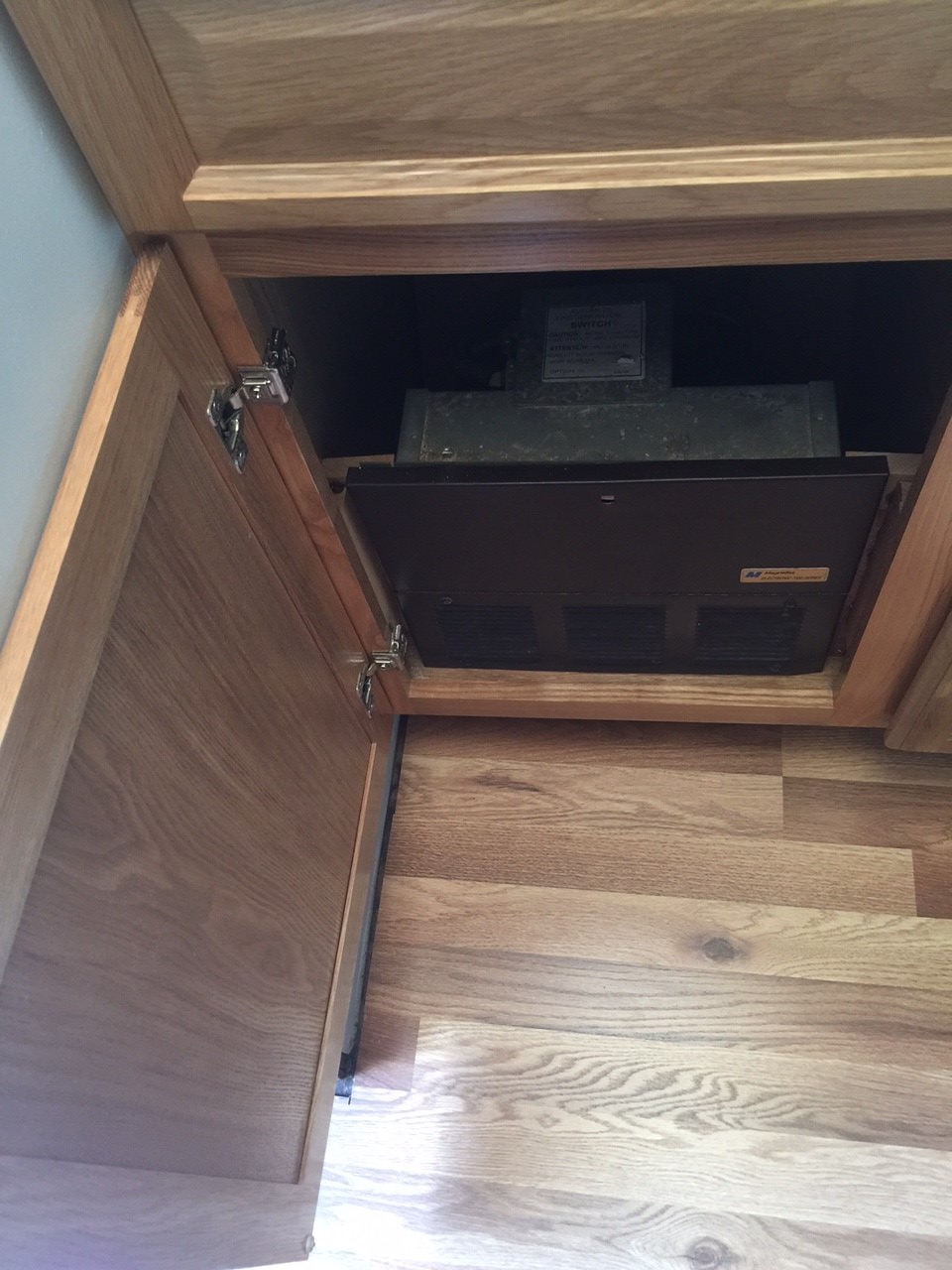

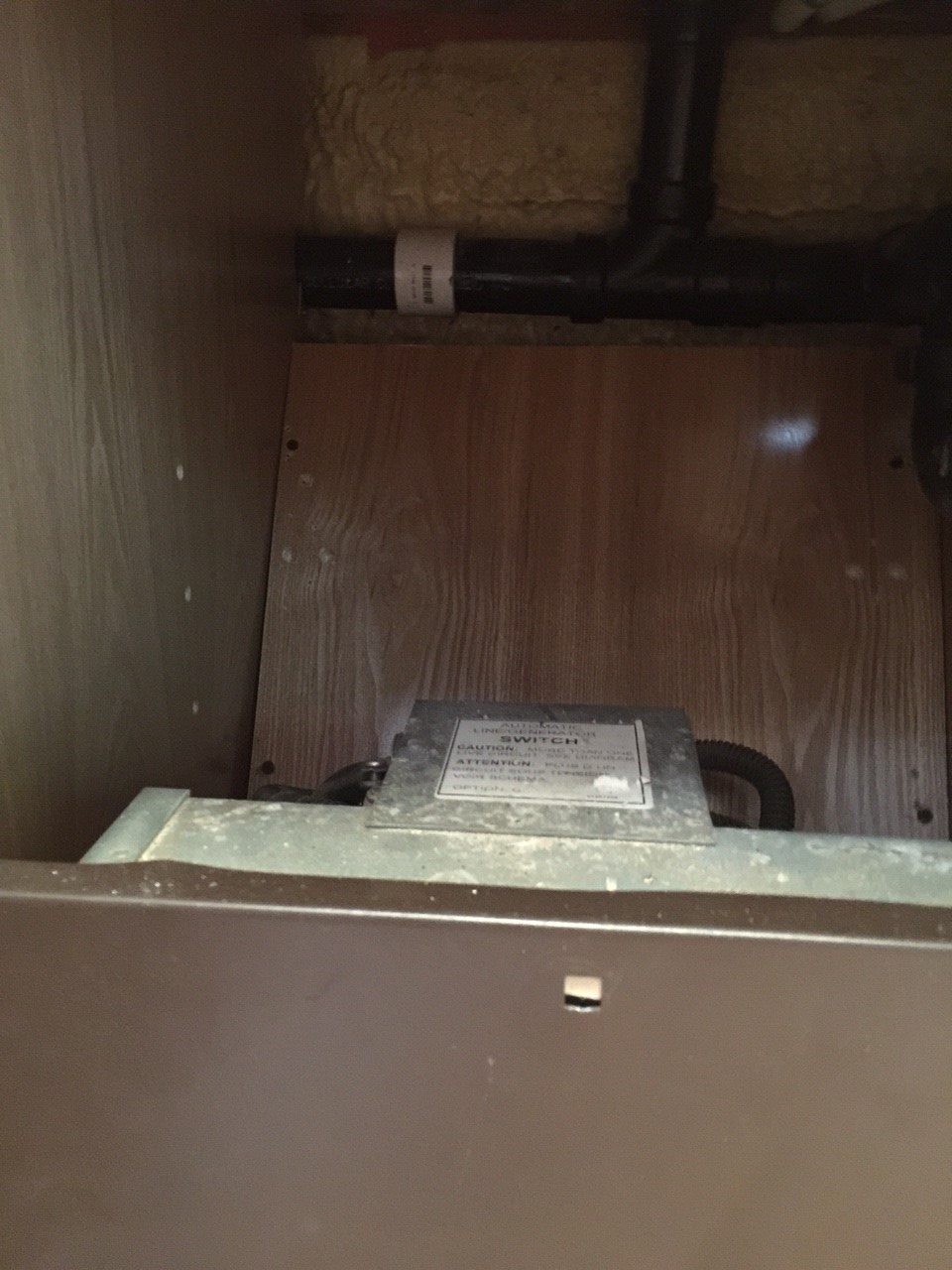

I asked my husband what they used to secure the cabinets to the wall, and he said they wedged a 2 x 4 on the wall where the two cabinets join together. The right is bracketed to the "all purpose board" discussed in earlier posts. I didn't get a picture of that side, but will. As I posted earlier, these are RTA country oak cabinets. The seem to be very solidly built. Each individual piece in the cabinet was modified in some way - cutting around obstacles.
We were able to fit the panel box inside of the cabinet with the door, and close the door! Much nicer look IMO.

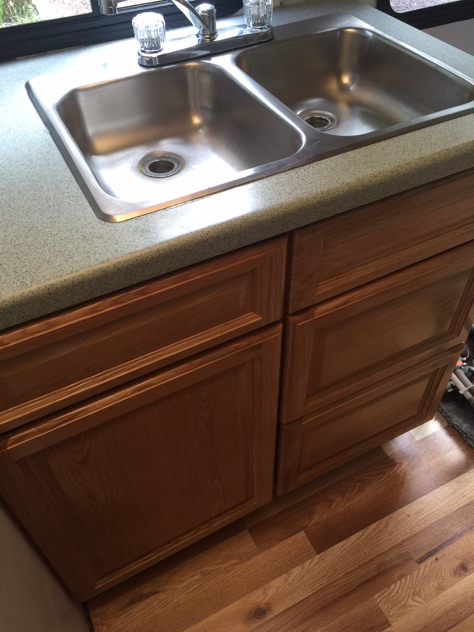

More pics of kitchen cabinets installed.
On cabinet with door, the drawer is just a front that pulls down to hold the sponges, etc. - the same as the original configuration.

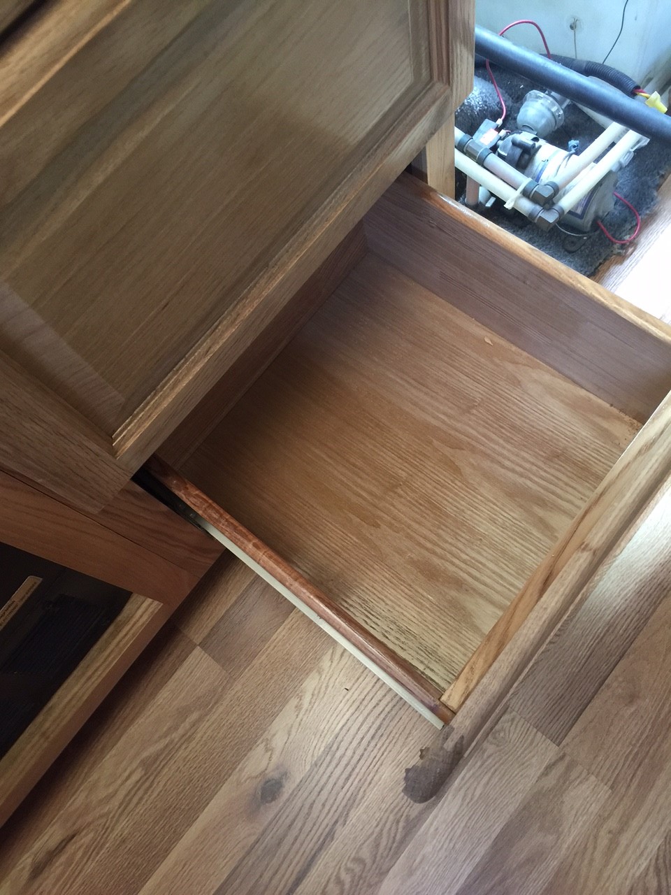

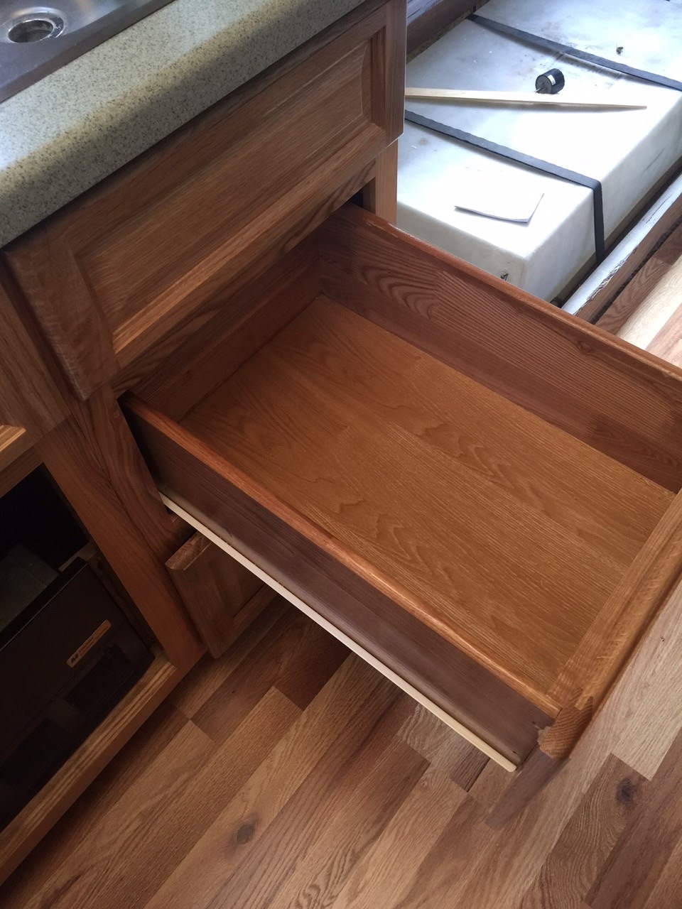

On the cabinet with the drawers, the top one is non-functional and a front only. The bottom two drawers are fully functional. The middle one comes out full length, and the bottom one was shortened, as were the drawer slides. We have pulls and latches that we haven't installed yet.
As I mentioned in my previous post, this work was quite intensive and involved a lot of measuring and cutting as they went. It took two men (husband and carpenter friend) 5 hours to get everything done, including re-installing the countertop and sink. And, they worked like demons!

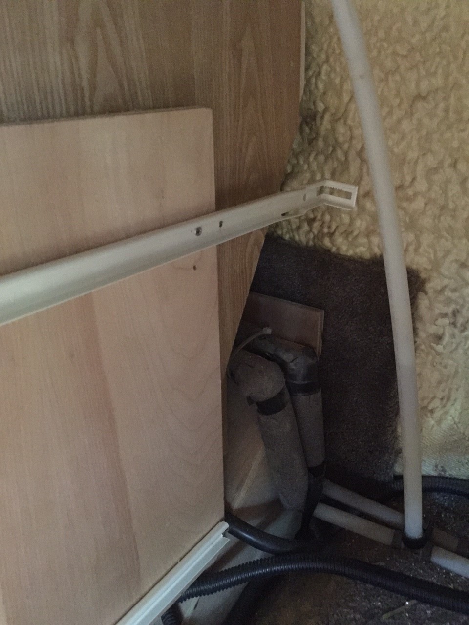

File comment: This image shows shortened drawer glides and support board installed to hold the glides. Here you can also see how cabinet was cut around obstacles.
File comment: This is shortened bottom deep drawer.
File comment: This is middle drawer.

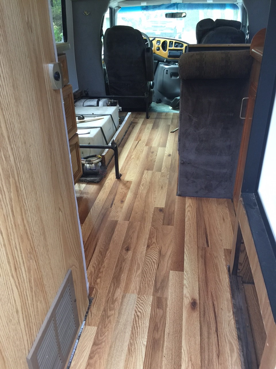

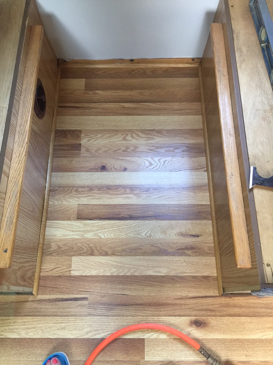

Now, some pics of the new flooring - this makes the most difference IMO, really brightens the whole place up! My husband did all of this work himself. I forgot to ask him to time it, but 2 days working 3-4 hours each. The hardest part was getting the finished threshold piece cut and installed between cab and coach - there is a small difference in height there. That took him about 2 hours. He still has to finish the trim. We're not using the Pergo quarter round product, just stained wood quarter round that is nailed with finish nails.
BTW, this is one of very few patterns that resemble the old style 2-3" hardwood floors. Most of the patterns seem to resemble wider planks today - and that is what is in our 5th wheel. But we like this pattern much more because of the variation in the "wood". This pattern is called Haley Oak. It might be too busy for some, but we thought the variation would match the different oak coloring in the cabinetry and fake oak laminate.

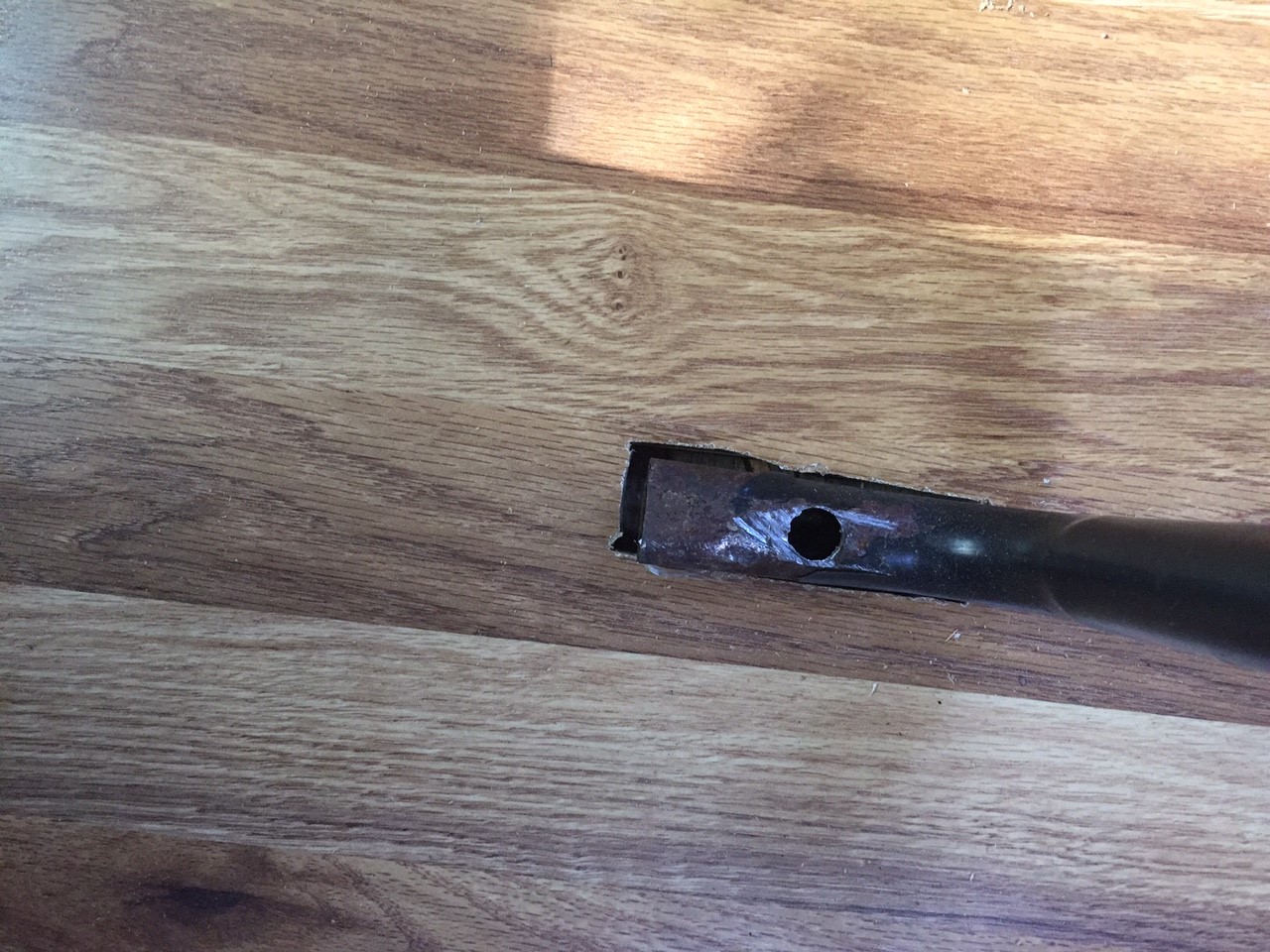

File comment: Here you can see where he cut out holes for the couch brackets.

Posts: 154
I have a question on the couch bracket. Did you remove the bolt and take out the bracket for you to install the planks? I tried to see if the bolt is removable, but it seems like there is a nut under the chassis that spins with the bolt, and so I stopped, trying to to drop/lost the nut.
