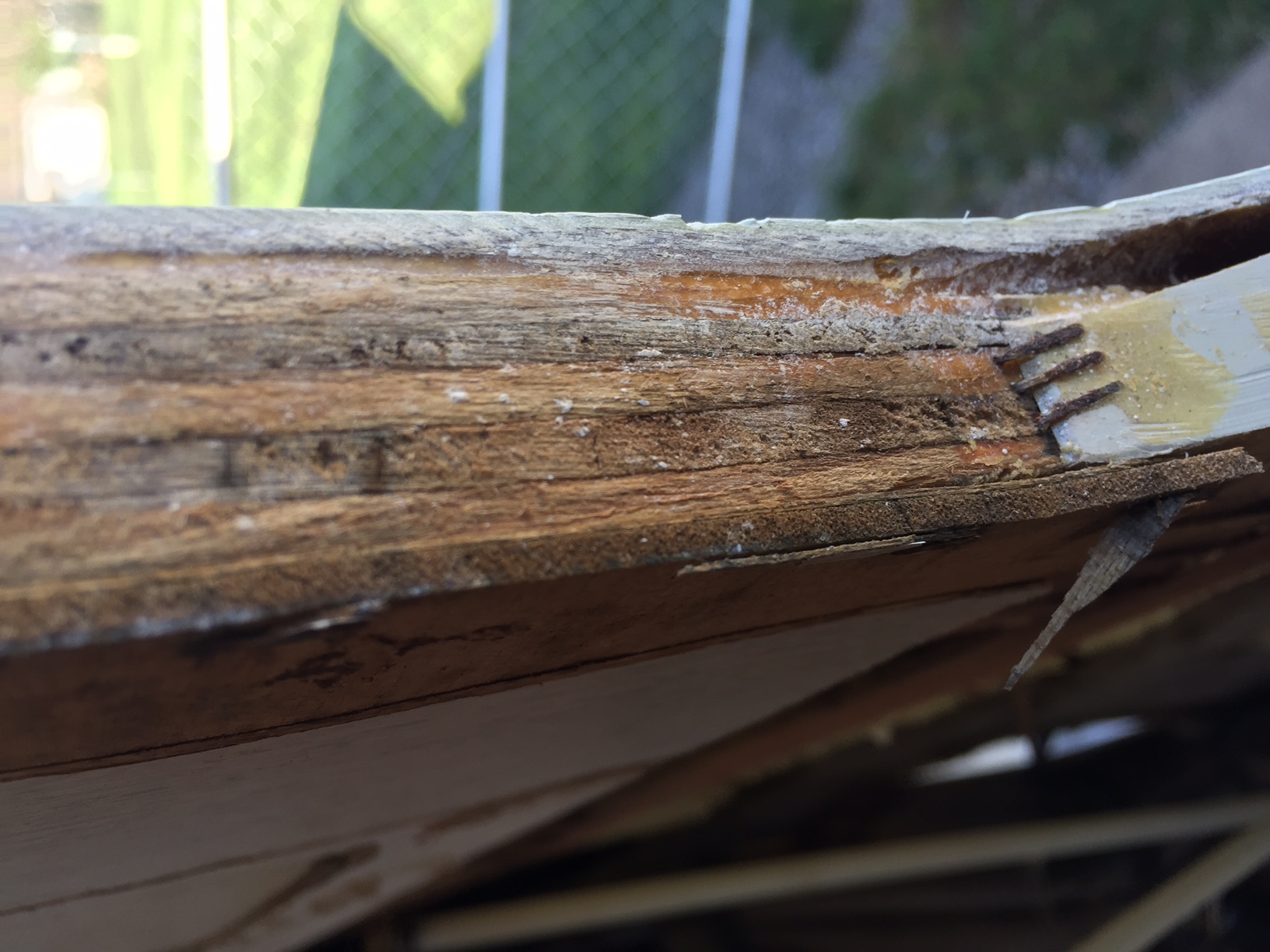

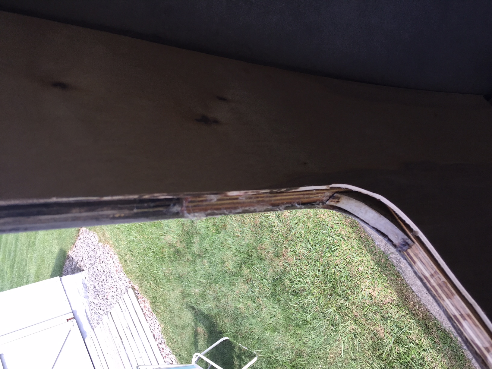

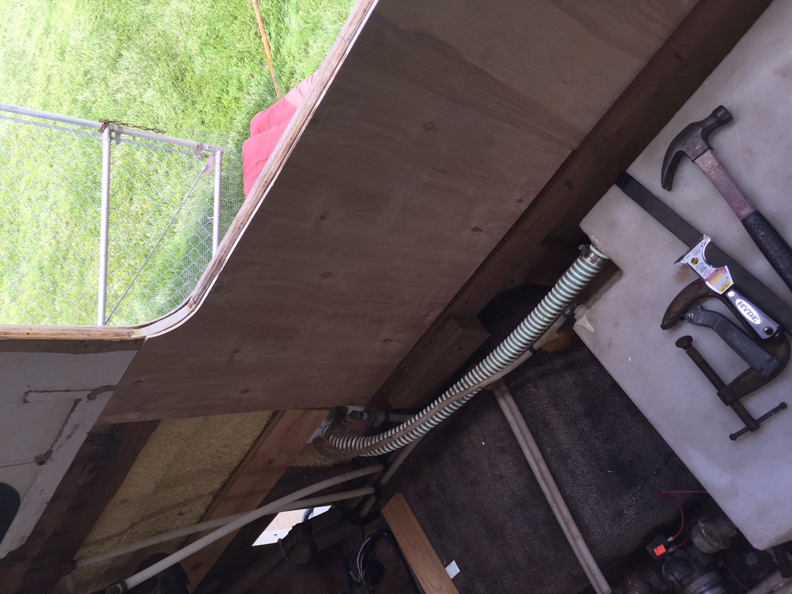

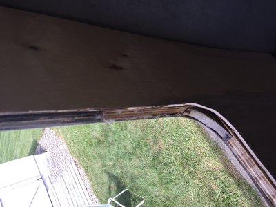

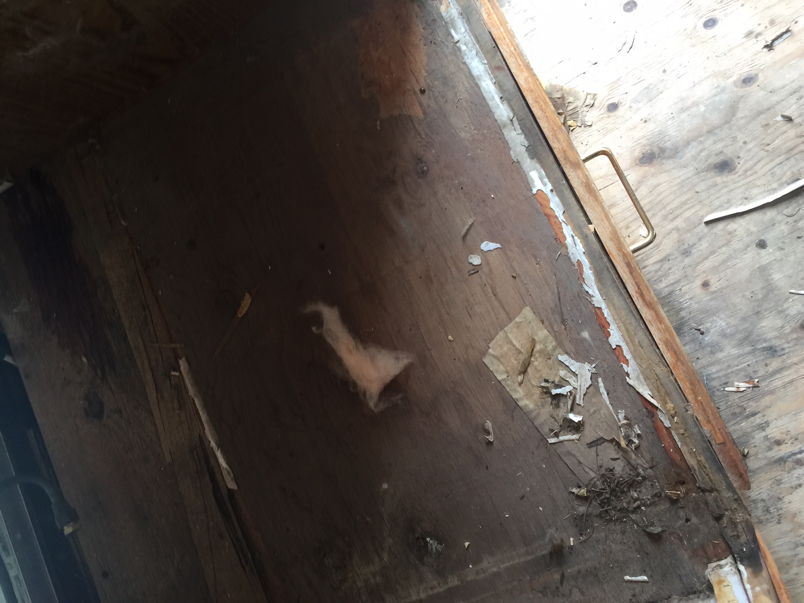

Post #3 Windows and Wall, continued. I’ve already detailed the actual work for this part, so this post is mostly pics.
Re: reply about marine epoxy v. resin. There is indeed a difference in epoxy v. resin. Epoxy is stronger and used by professionals for repairing fiberglass, but since we were doing interior work and not repairing the actual fiberglass, I believe the Bondo resin will hold up just fine for our purpose, which was to replace having nothing to nail the replacement wood onto. Epoxy is also significantly more expensive, harder to find, and more complicated to work with. If we needed to repair the exterior of our bass boat (fiberglass), I believe we would not attempt this work at all and take it to a professional for peace of mind. Also, I’m betting that neither resin or epoxy was used in the initial construction of the Chinook.
In these pics, you can see the window framing; one side not repaired, other side repaired. You can also see the new luan pieces nailed in place. When I view these in Preview they need rotated, but when I click on the actual image, they show up correctly.

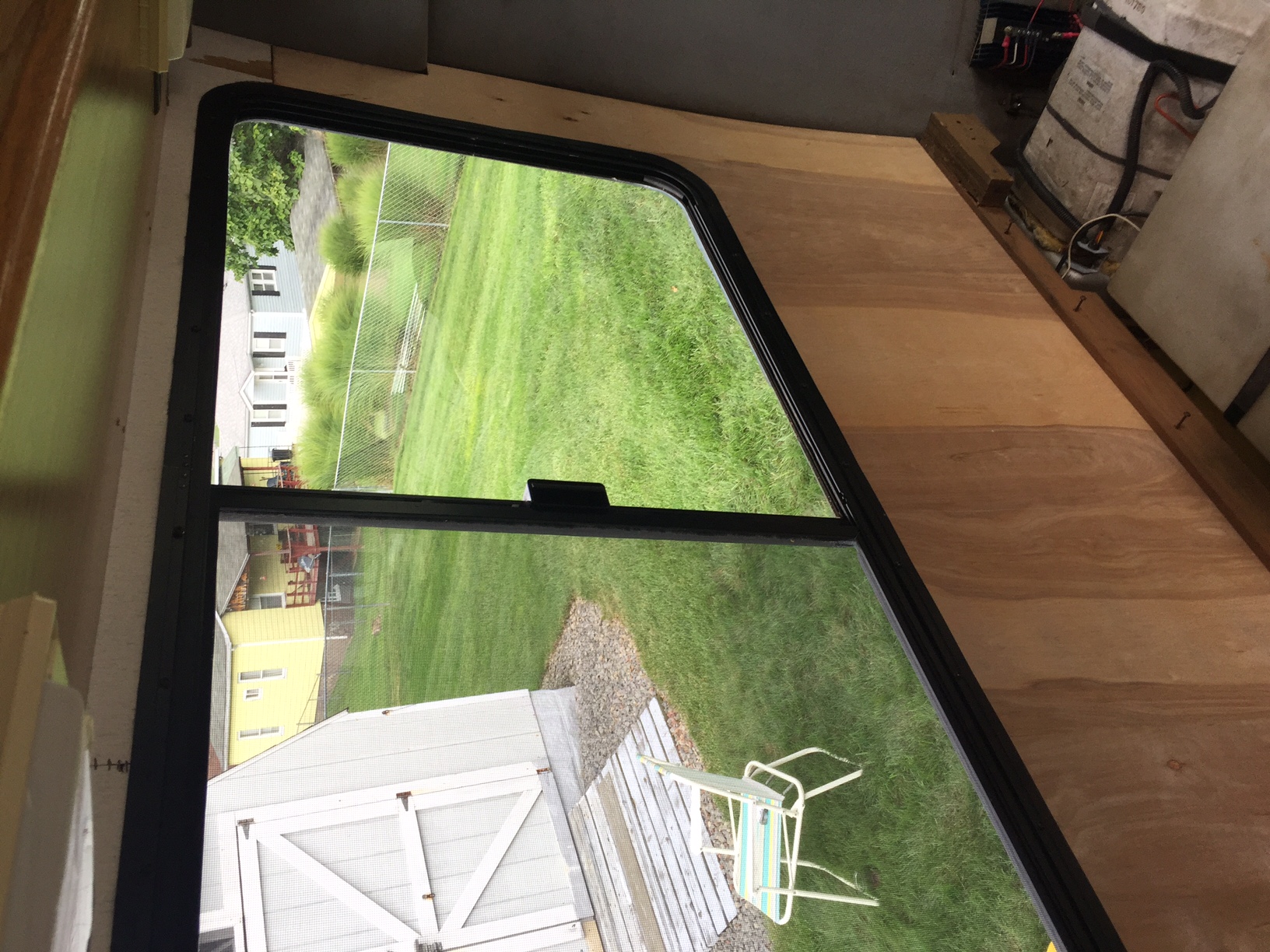

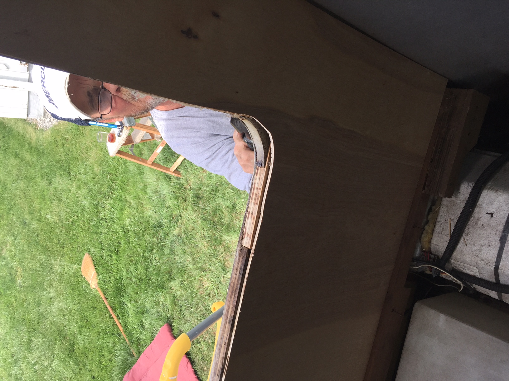

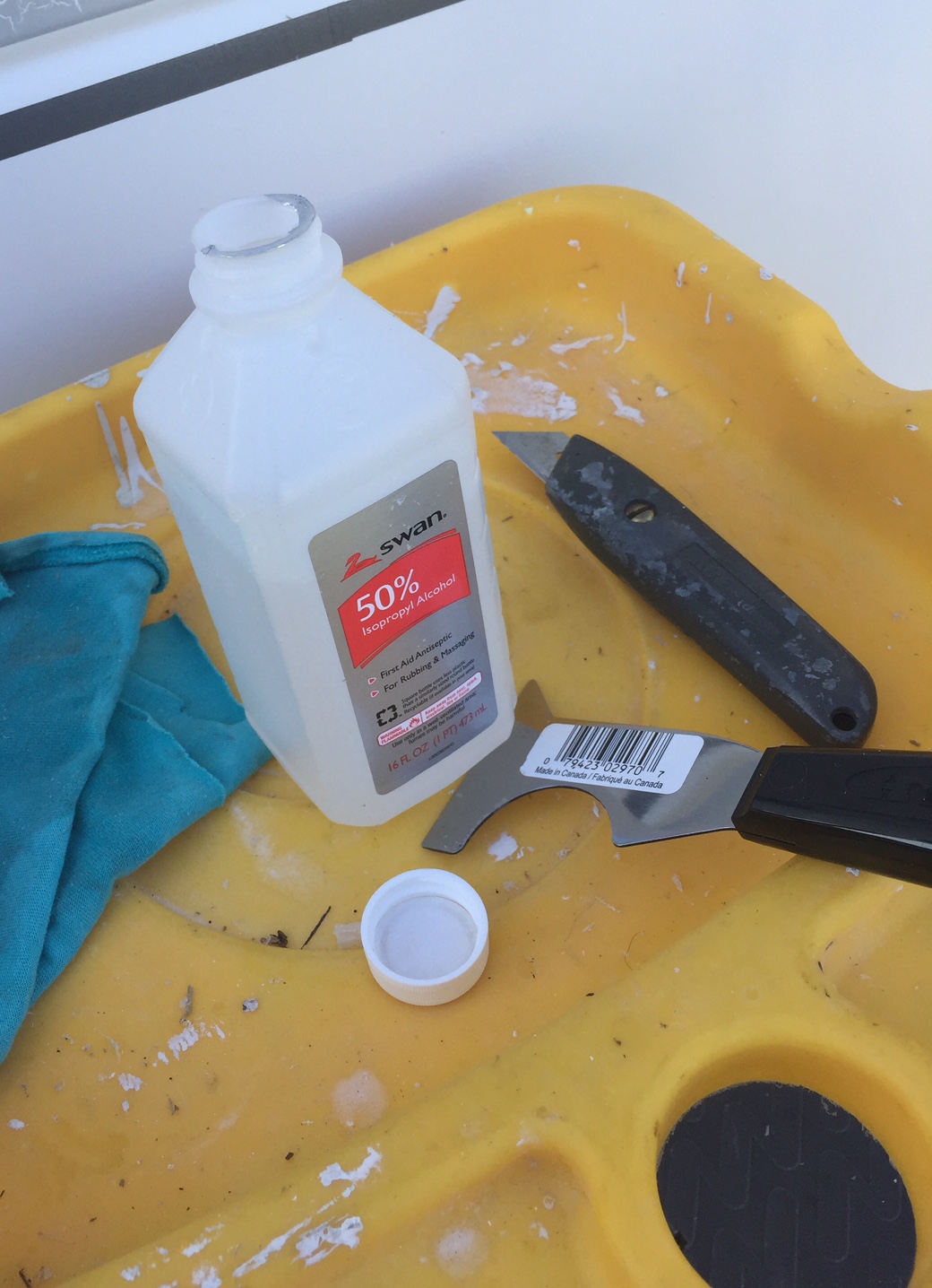

Post #4: Re-installing window.
In the first post, I detailed how we removed the window. BTW, we learned this by watching a You Tube video. The internet is truly an amazing thing!
1) Break outside silicone seal with sharp utility knife.
2) Unscrew all of the little screws inside and remove the frame; make sure someone is holding the window outside - the Premiere has smaller windows than the Concourse from the pictures I've seen, so if you're doing a Concourse, you will definitely need two or more people to hold window on outside.
3) Wiggle the window loose and set safely aside.
4) Use rubbing alcohol, some kind of sharp blade (we used the 5 in 1 or 7 in 1 tool or maybe it is a 6 in 1 ), and a soft rag to remove all traces of silicone outside. This could take a while!
5) Apply Butyl Tape around the exterior opening. We used 3/4" wide. You can get this online at any RV parts store - Camping World - and it's very inexpensive. The tape can be a little tricky and sticky to work with, but once you get the hang of it, it's pretty easy.
6) Two people on outside position the window lightly; do not press hard just yet.
7) With one person inside and another one outside, re-position the window in place; we had to adjust slightly so don't press hard into place until you are sure it's where you need it. It sort of falls into place, you can feel it when it's lined up just right.
8) Now line up all of the holes with the frame and start screwing screws back in place. Person outside should still be holding window.
9) Once you're sure it's in place and the screws are lining up, then press hard into place. You should see the tape squeezing out of the sides. The video we watched said this is what you want.
10) By this time, it's all secured.
11) The video we watched said you don't really need additional caulking, but we added a bead of it anyway. We didn't use a regular silicon caulk, but rather a special formulation for RVs bought online via Camping World.

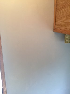

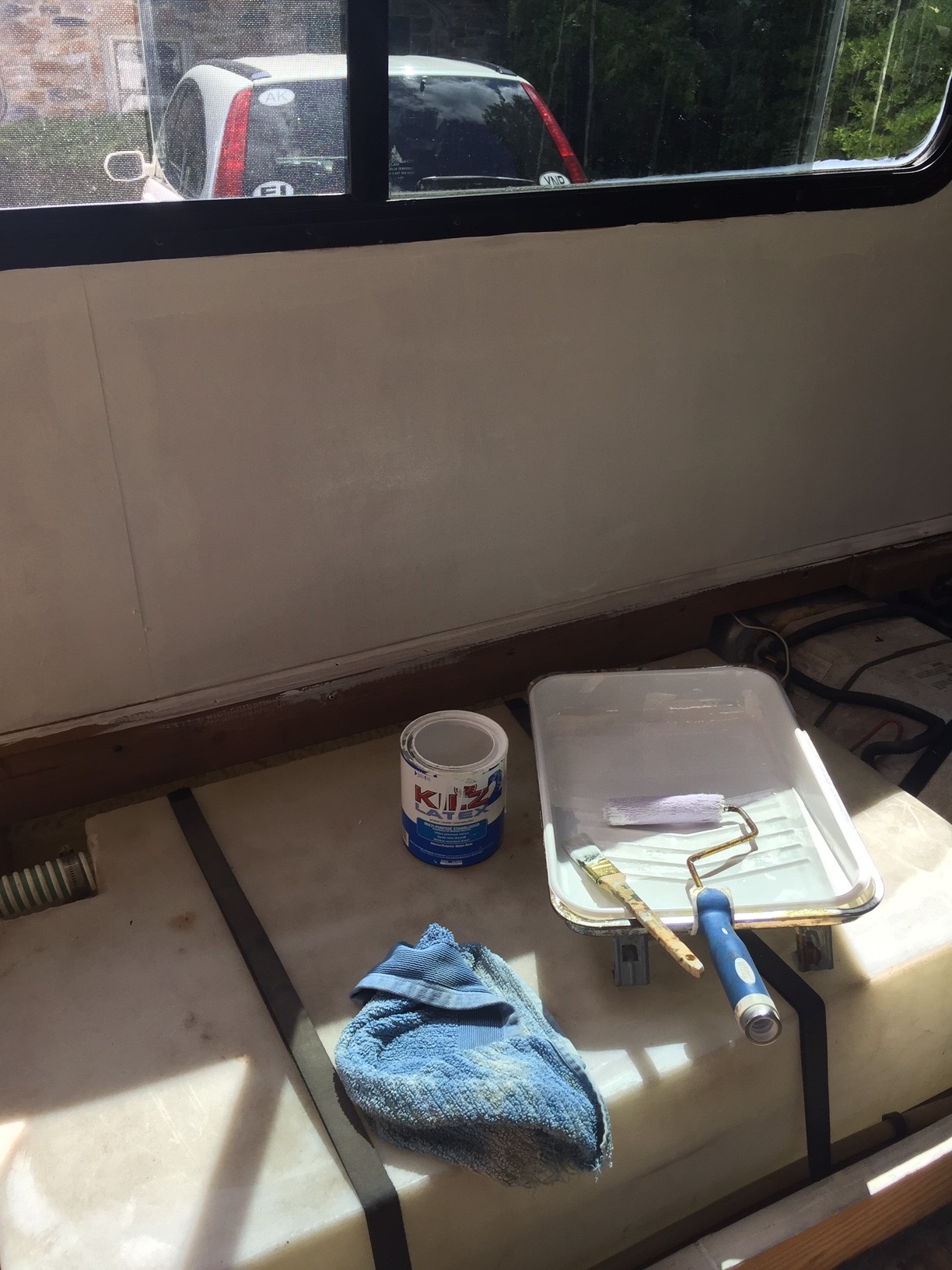

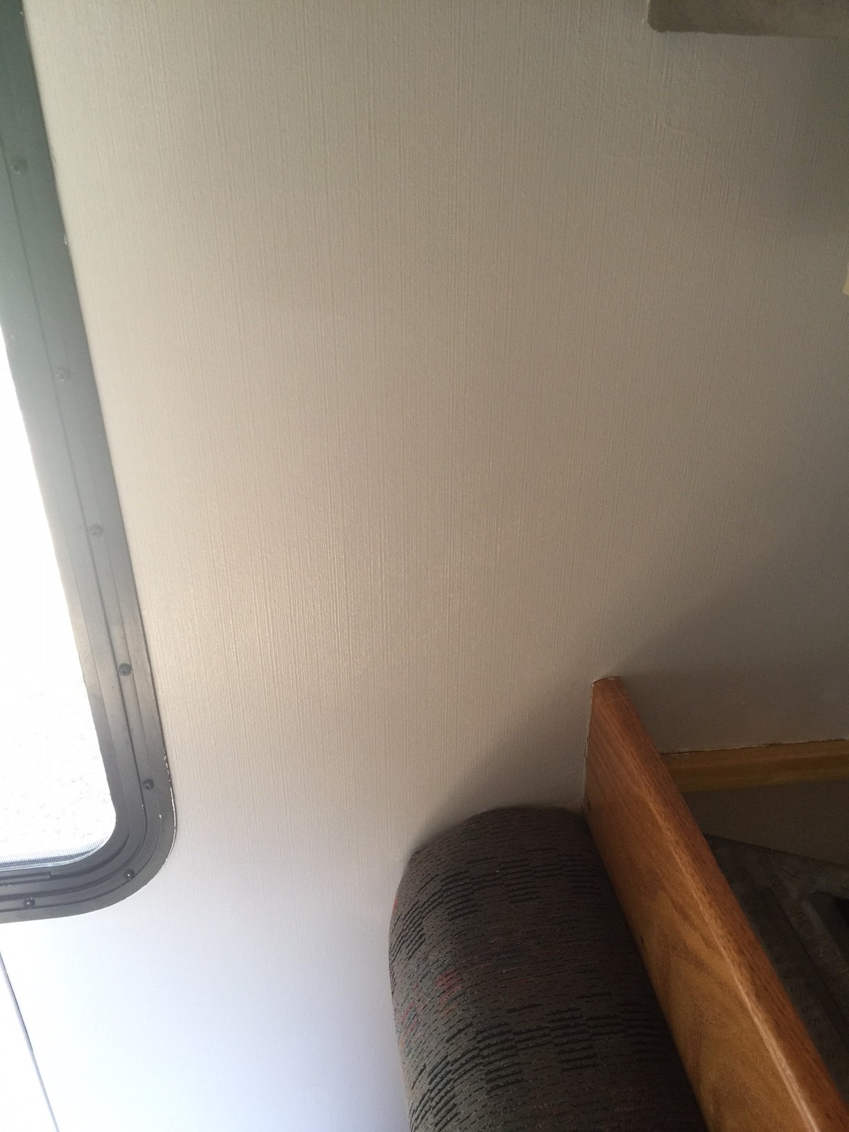

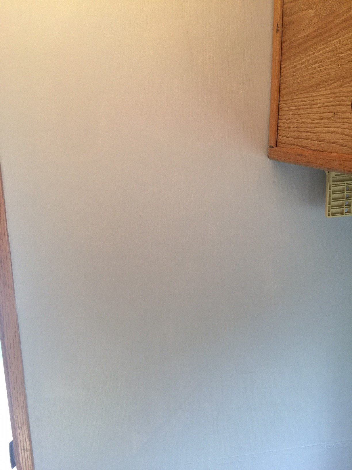

Next Post, Painting Interior.
1) Patch holes with patching compound, let dry til next day.
2) Sand patching compound areas.
3) Wash all walls with white vinegar and water mix (1/2 and 1/2 in spray bottle).
4) Apply TSP solution to all walls with rag, to add grip.
5) Lightly sand walls with fine grade sanding block to add grip.
6) Wash all walls again with white vinegar mix
7) Prime all walls one coat with latex based KILZ (oil based is better, but too noxious and too long to dry.) Two coats of primer to luan area.
8) Paint all walls with one coat of Behr brand latex paint in a satin finish, light silvery color that sort of matches ceiling. Pictures show it a little whiter than I think it really is. But I chose the color also because I thought it blended nicely with the old wallpaper color of cream with silvery blue flecks, just in case the flecks started to show through, but they haven't yet.
9) Next day, touched up where needed and where missed - it was early evening when I did the first coat, and I missed some spots. The paint dried darker, so it was easy to see where it needed touched up.
I did not tape off most of the trim or windows, just cut in carefully with a good angle brush. I did tape off around the stove area because it is just an awkward space to work in.

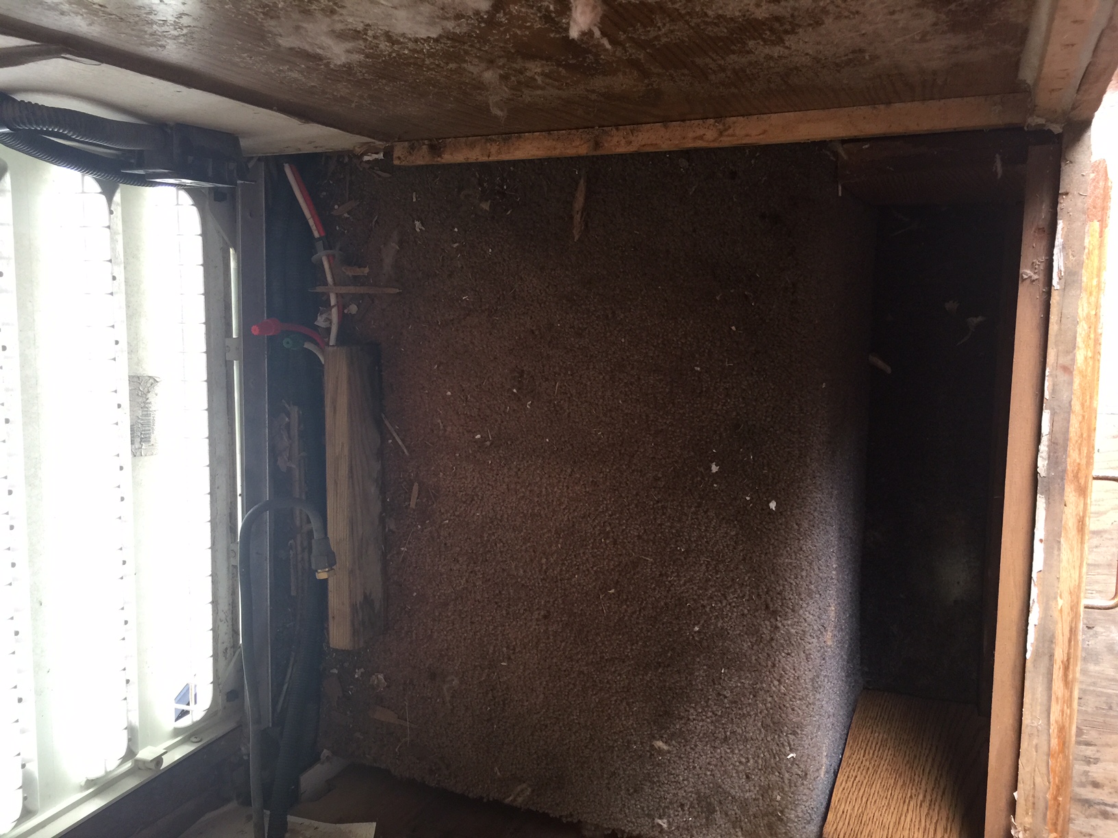

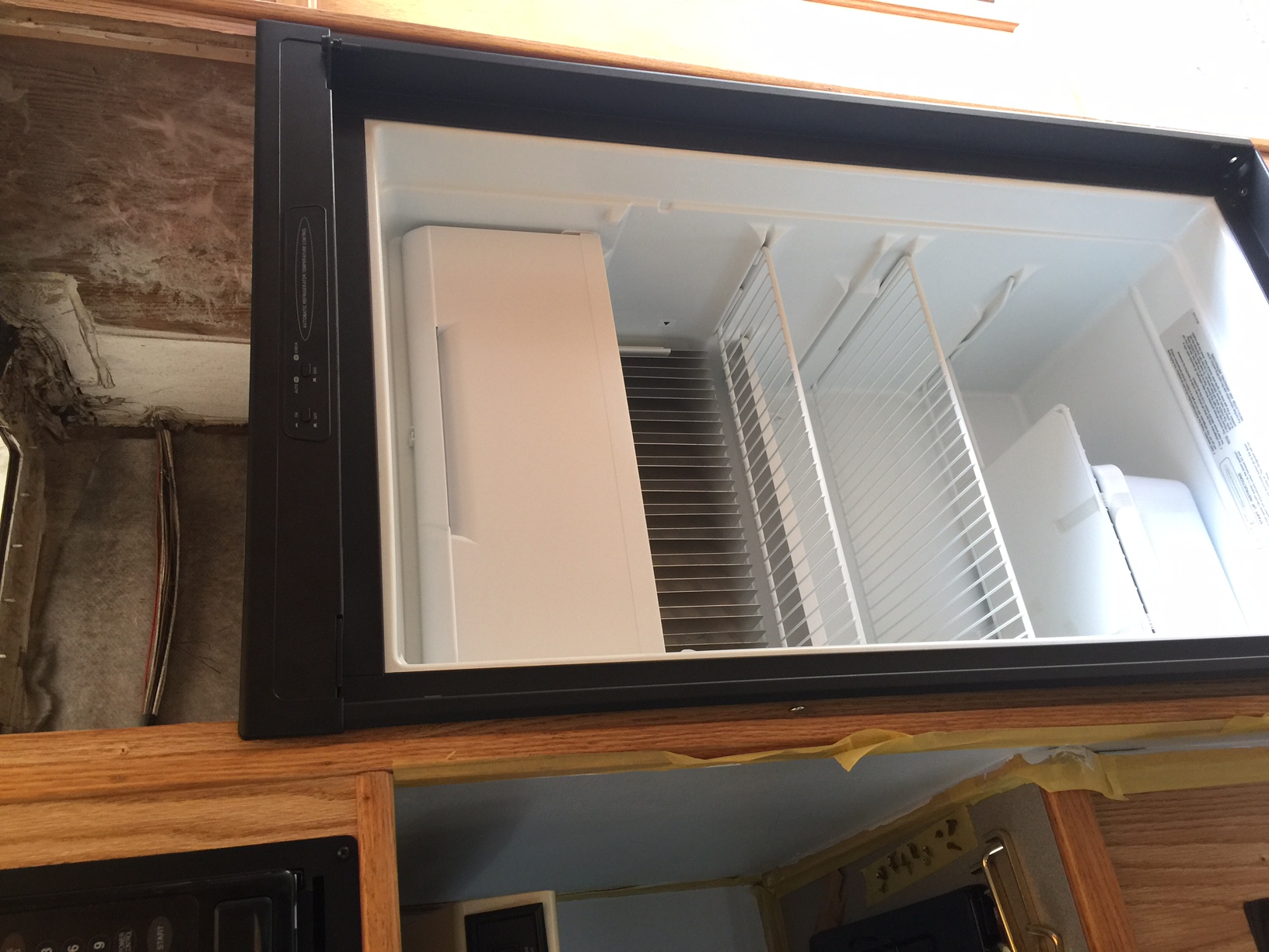

Next Post....Setting the new fridge in place.
I thought some of you might be interested in how we were able to get the new single door, 2 way, 5 cubic foot Dometic fridge in place.
The previous owner had, at some point, removed the original fridge, and I don't know how that was done. I read the post about using a Sawzall to cut up or demo a fridge so as to be able to get it out the door, but I don't know how removal was done on our model. When my mother bought it, the previous owner had installed two very small 110 V dorm fridges stacked on top of one another. Their width did not take up the entire width of the cut out, and he/she had installed a 2x4 on the side as a filler. They had also removed the top cabinet.
First my husband replaced both the bottom platform the fridge sits on and the support framing for the platform.
Even before we had the rv at home, I had ordered the fridge - big mistake. I had measured the cut out opening, but not the door! and the door is only 22 inches wide and the hallway is only 22 inches wide. The model I ordered measured 24" at the smallest side, including the coils. We thought...well...just remove the face frame and door. Door is easily removed; face frame cannot be removed!
Oh, woe were we!! On this forum, I thought I had read about owners removing cab doors and entire windows to get the fridge inside. I must have misread because the fridge easily fit THROUGH one side of the open kitchen/couch side window. We simply slid open the window and popped out the screen frame. We then had more than enough room to slide the fridge through. It did take 4 of us - 2 inside and 2 outside to lift it up and through and put upright. And then 2 to place it in the existing opening and it fits perfectly!
I wish I had a pic, but I was one of the 4.
Lesson learned....measure everything first. Other lesson learned...Chinooks have a very narrow outside door. And one more lesson learned, we probably should have ordered the smaller 4 cubic foot size, which might have been the original size in the Premiere model? But it all worked out in the end. Total time, 2-3 hours? Most of it hmmmm....hawing around.
