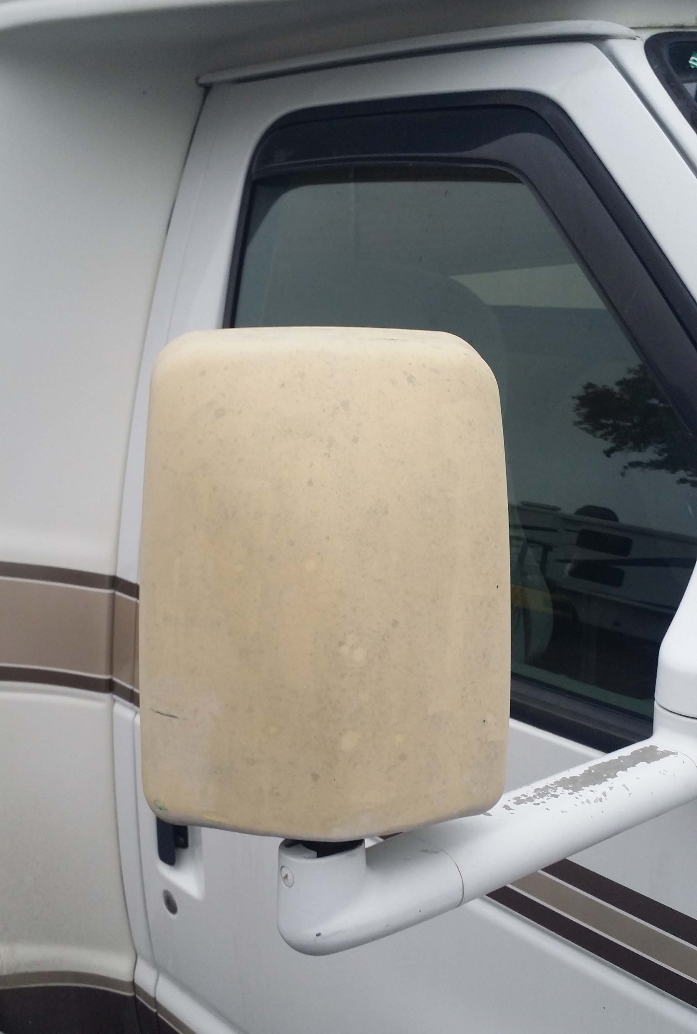

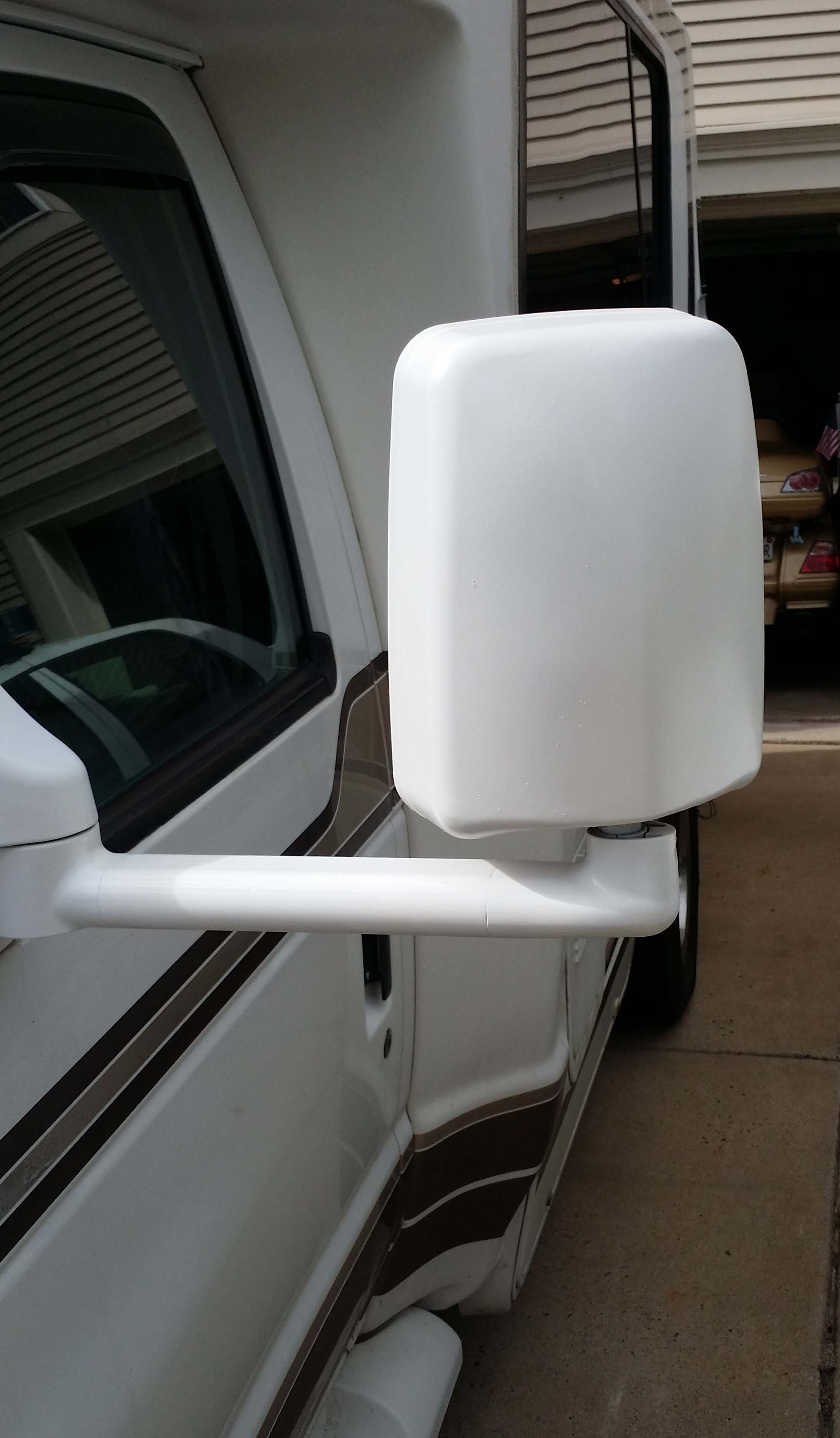

My mirrors came looking pretty yellowed and crappy and it's been bothering me since I've had it. To try a cheap fix, I bought some white, Rustoleum paint/primer and it worked well. I sanded the mirrors and wiped them off with a wet cloth. I then taped (blue painter's tape) newspaper to the doors, windows, and body around the mirrors. Lastly, I held up a big piece of cardboard to block most of the over-spray since it was a little windy. I used 3 coats and am very satisfied with the work, knowing it doesn't look professional, but much better to me. I realize the pictures are of 2 different sides, but the colors of both were the same before and after.
