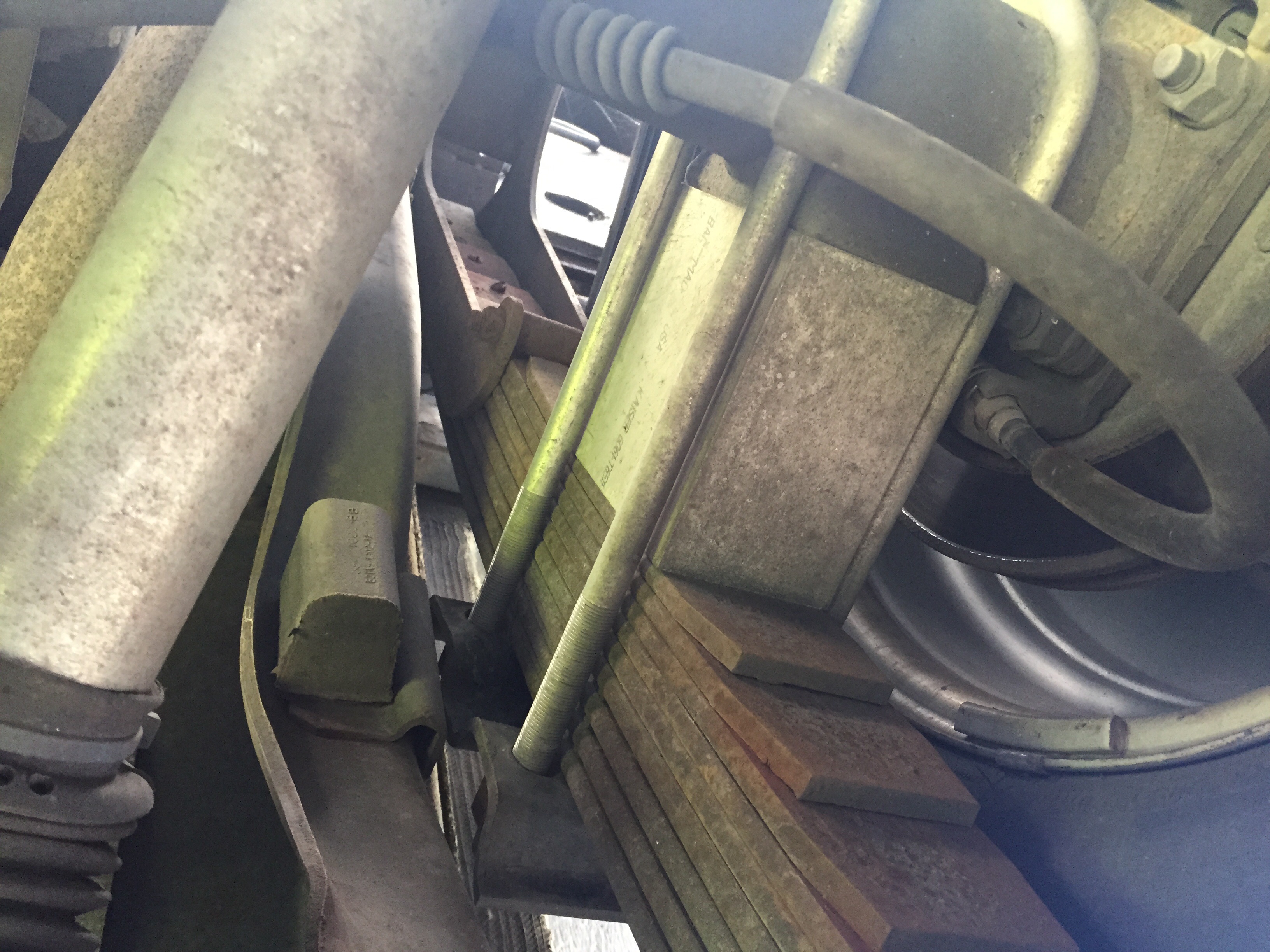

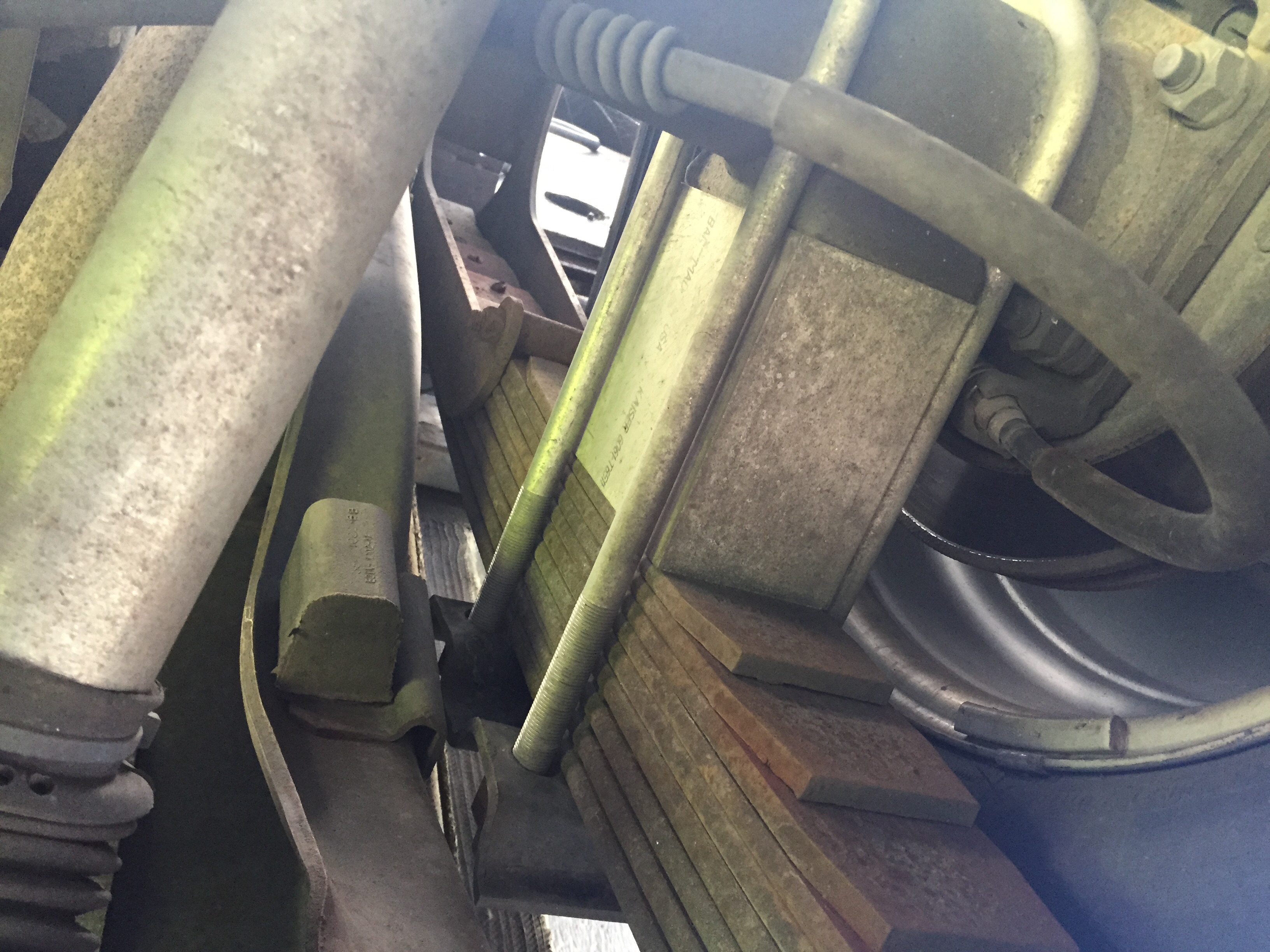

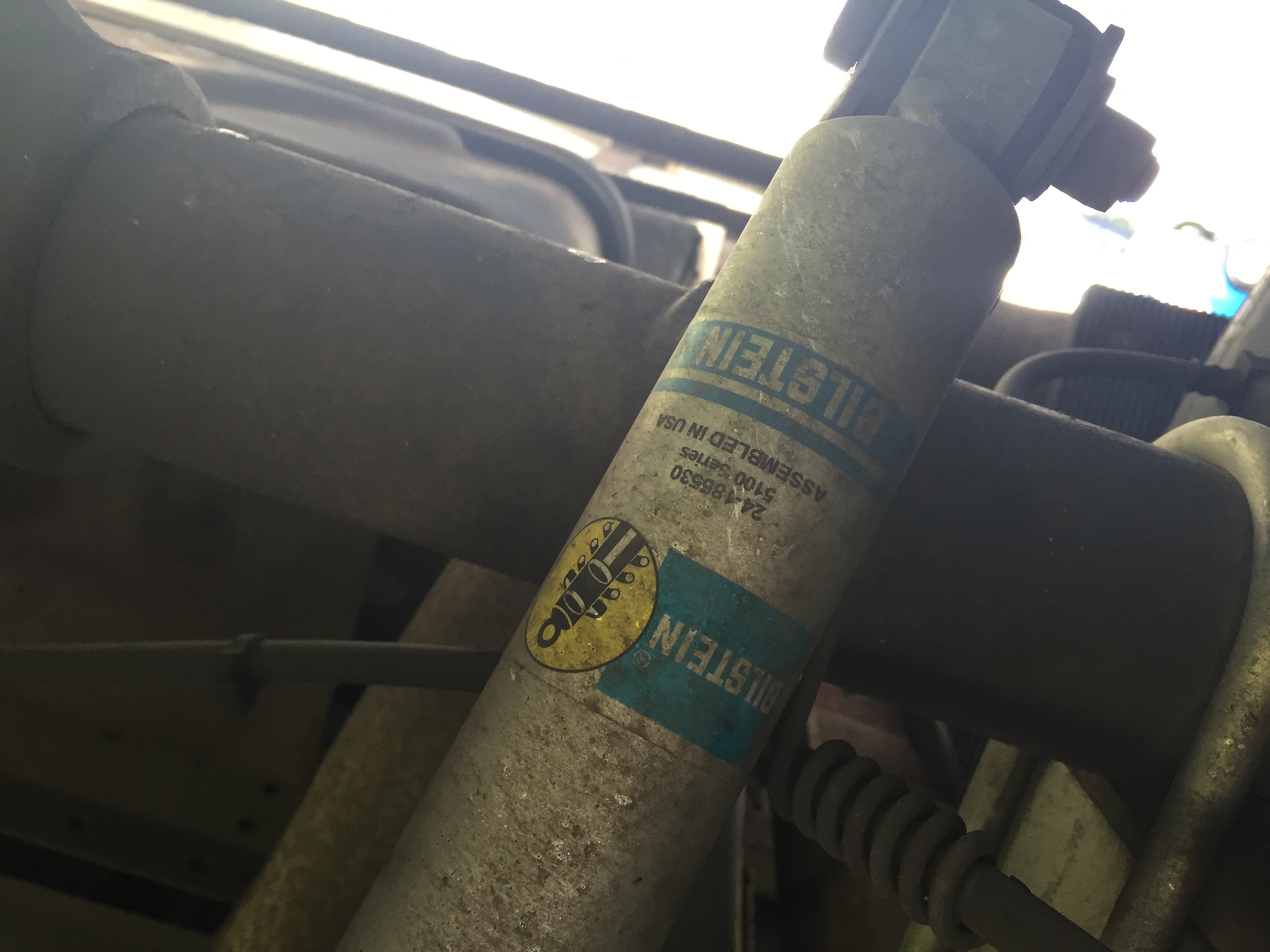

Anyway.. Finally got some pics of my rear springs. Looks like I have 9 leaves. Your rig looks higher in the back than mine. Oddly though, my spacers look taller than yours. I guess your springs are just that much stiffer.
