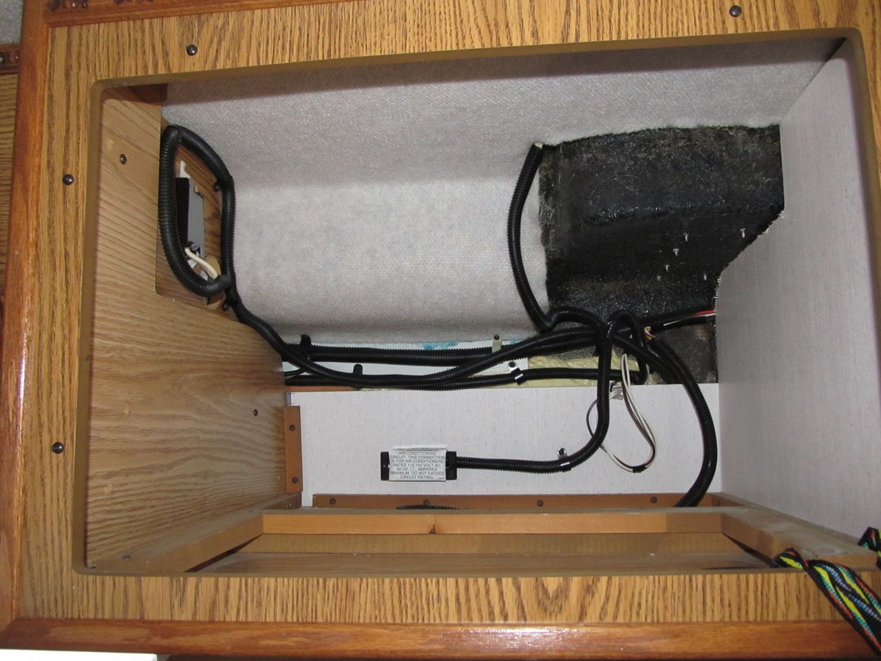

The microwave (at least in my 1999 Concourse) is held in place by six screws around the perimeter, going through the microwave flange and into the cabinetry behind. I removed those and then just put them back into the holes in the cabinetry, for safe keeping and because I prefer the look to holes or patches. The electrical connection is made by a regular "plug" plugged into an outlet. There is an opening in the left side of the cabinet (as you face the microwave door) and the cord goes through that and then plugs into the face of an outlet, which is in the adjacent upper cabinet. Remove the six screws, unplug it and it pulls right out.

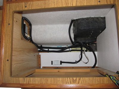

Here is the compartment just after pulling out the microwave (ignore the multi colored strap you can just see in the lower right corner; that was holding my refrigerator doors open before I got the Dometic Airing Position Cards™). You can see four of the six attachment screws back in place around the outside of the compartment (black screw heads).

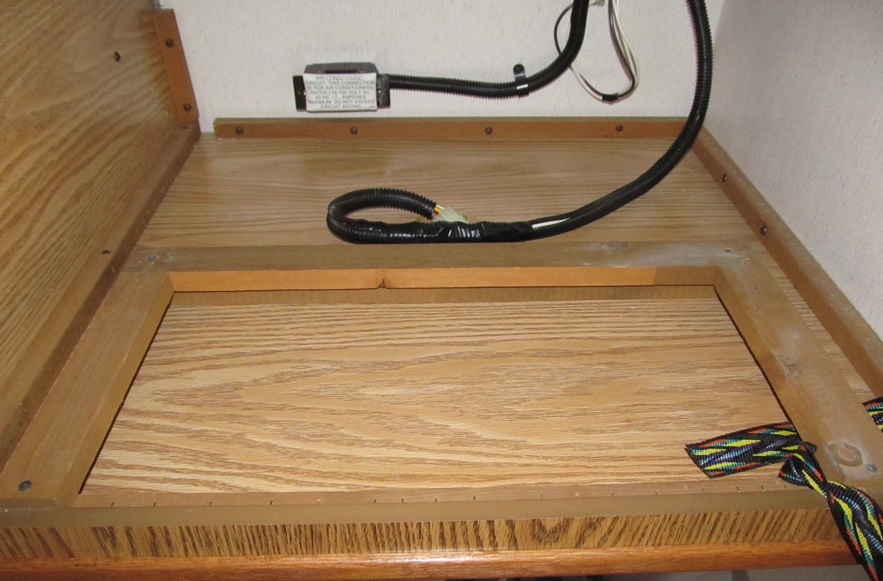

Here is another view, showing the bottom of the compartment. The wire loom that is looped around on the bottom is the wiring that leads down and out into to the range hood/command central display.

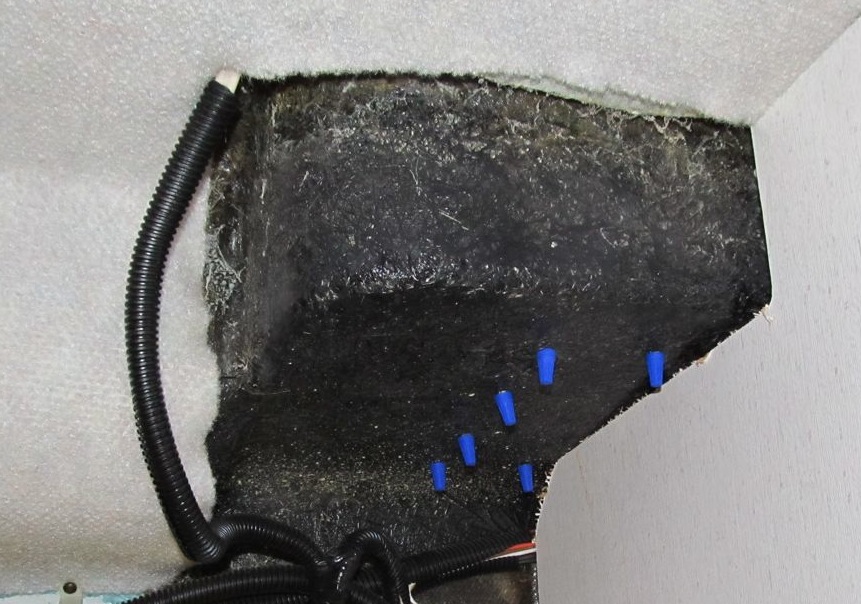

I thought about various things I could do with the compartment: Drawers, shelves, etc. Obviously there are lots of options, many of which would involve a "nice finish" to the inside area. But for starters I decided I would store soft things in it (clothing/linens/etc.) which meant I didn't really have to do much to change it while I tried it out. The first thing I did was put some wire nuts on the protruding ends of the refrigerator ceiling vent fasteners, just so nothing would snag on them.

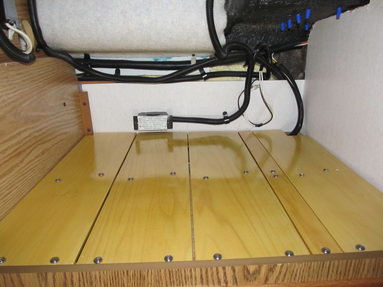

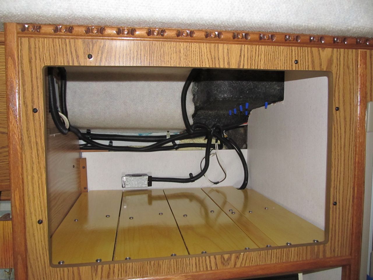

Next, I decided that even though I wasn't going to get too fancy (yet), I did want it to be tidy and to have a nice platform to set things on. I also didn't want the wire loom leading to the range hood to be disturbed. To that end I went to Home Depot and got some alder hobby boards (these are really thin boards, 1/4" if I remember correctly). These are very light weight and take up almost no space, but are plenty strong. I put a few coats of varnish on them and then attached them to the existing 1" x 2" "floor framing" of the compartment with stainless screws and finishing washers. You can't see it here, but I re-routed the loop of range hood wiring so it looped back instead of forward, which allowed it to tuck nicely out of the way (by this I mean I simply picked it up and set it back down the other way, nothing major). Here is the very simple compartment floor after I fastened it in place.
A closer view:

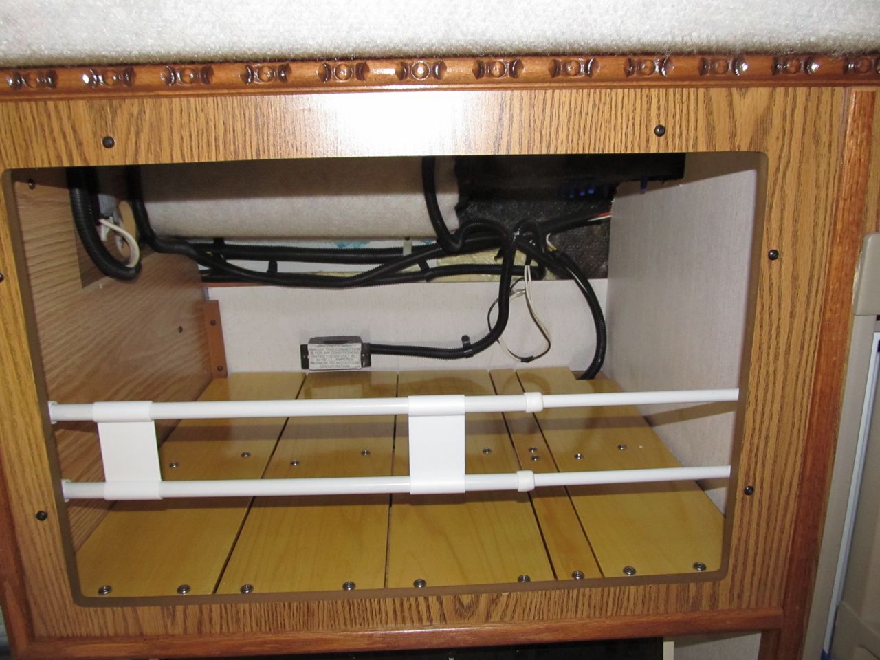

In keeping with "do it simply for now, try it out, and then make any further decisions," I didn't fabricate or buy doors for the opening (but may do in future). So I needed a way to keep things from falling out. Wal-Mart (and I'm sure other places) have this double/adjustable tension bar in their camping department that is meant for refrigerators. If I remember correctly it is made by Camco. It popped right in and has done the job perfectly.

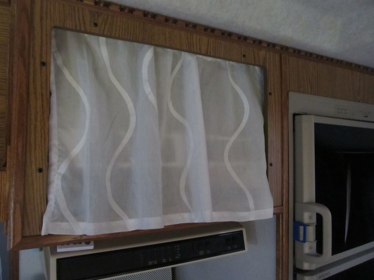

A friend zipped me up a curtain by making a few seams in a leftover piece of fabric. Even though I wasn't going to make doors (yet), I didn't want a cluttered look right in front of my face all the time. A single tension bar holds it in place (Wal-Mart curtain department, and I'm sure many other places). Like the "refrigerator bar" shown above, it has springs inside and rubber feet on the ends. You just twist it until it is slightly longer than the right length, and then tension plus the rubber feet keep it in place. The compartment has wooden corner boards that they both rest nicely on. The light fabric suits me just fine for now, and the space feels more spacious without a microwave in my face (plus it is a HUGE storage compartment - there was a lot of wasted space behind the microwave oven). I pulled everything out of the compartment today to take the photos, and I could not believe the size of the pile! The compartment swallowed it all up again easily when I was done :D

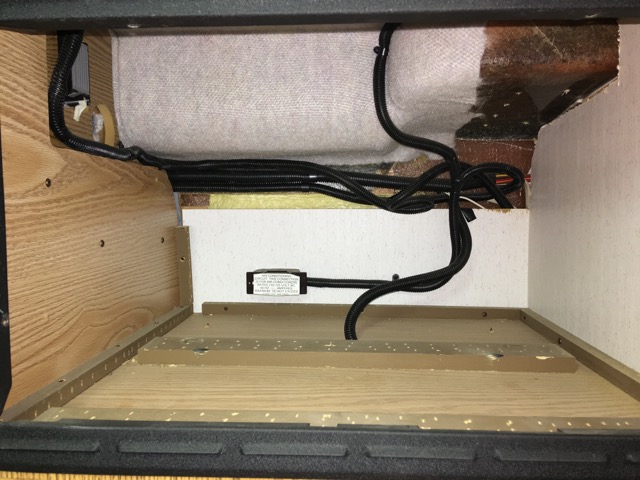

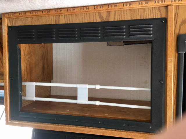

Another one bites the sawdust…… just finished re-purposing my microwave cabinet following safe footsteps through the minefield others kindly left here. I used a piece of 3’ x 1’ oak-veneer shelving from (where else) ACE hardware, cut short to 24 1/4” to fit lengthwise. The offcut was used to cover the AC junction box for the microwave as you can see in the “before” picture.
My inner perfectionist visualized a Chris Craft mahogany deck finish but the lazy practical side won out. Oh, the refrigerator bar - kudos to BG. I chose not to utilize the full depth owing to the convoluted ceiling. The back air space is sealed off with a thick slab of styrofoam pressed in place for insulation to the outside behind the fridge.
This roomy cabinet will be perfect to set out my morning tea kit above a kettle on the stove. I usually get up around 4am and need a strong brew of English Breakfast to get going. I daren’t turn on lights to rouse "she who must be obeyed" so it’s nice to have a cabinet at head height and not grope around clattering through congested kitchen trapdoors. Naturally my wife has other ideas involving linens, towels, flower arrangement and suchlike :roll:
