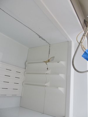

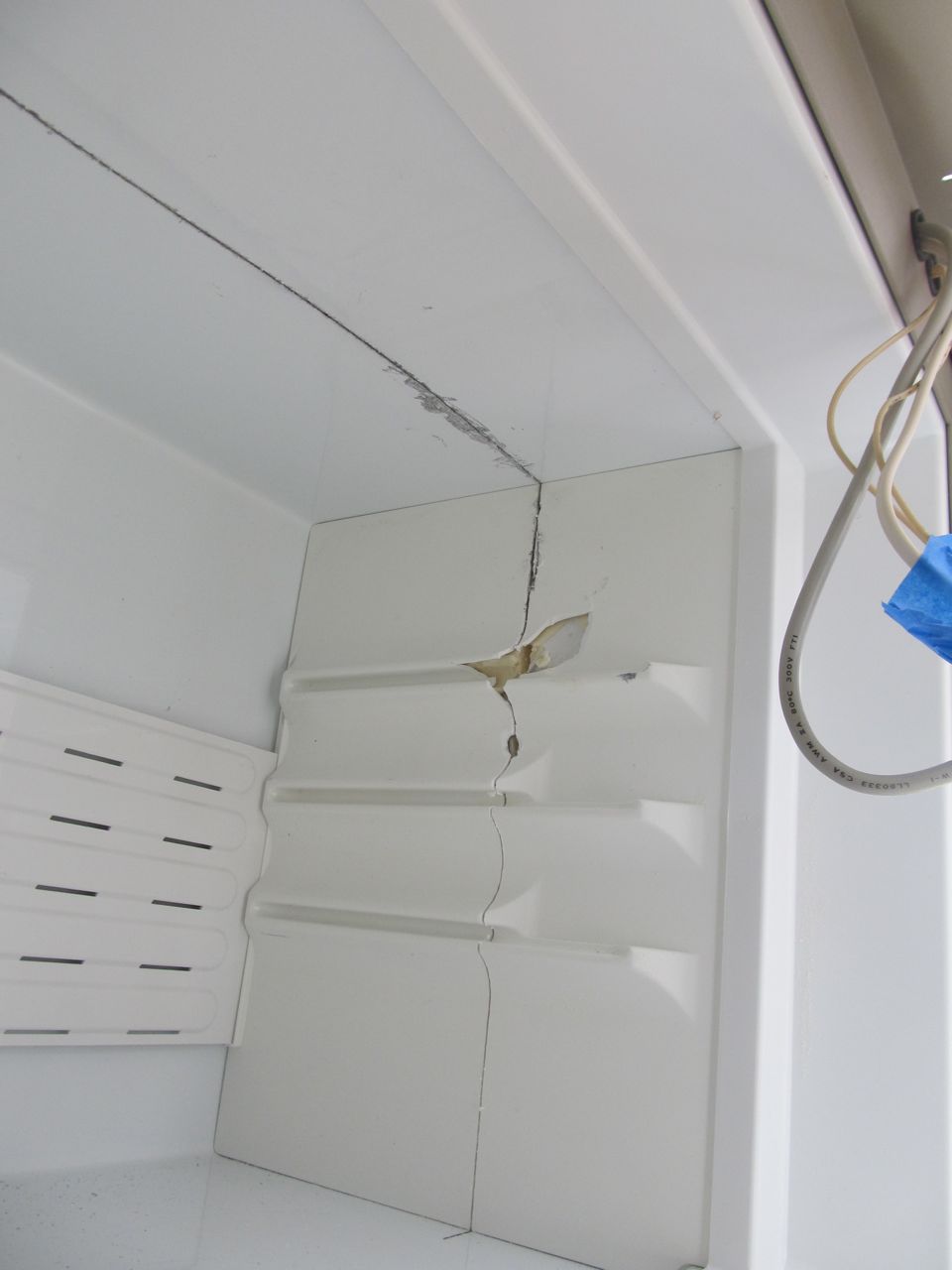

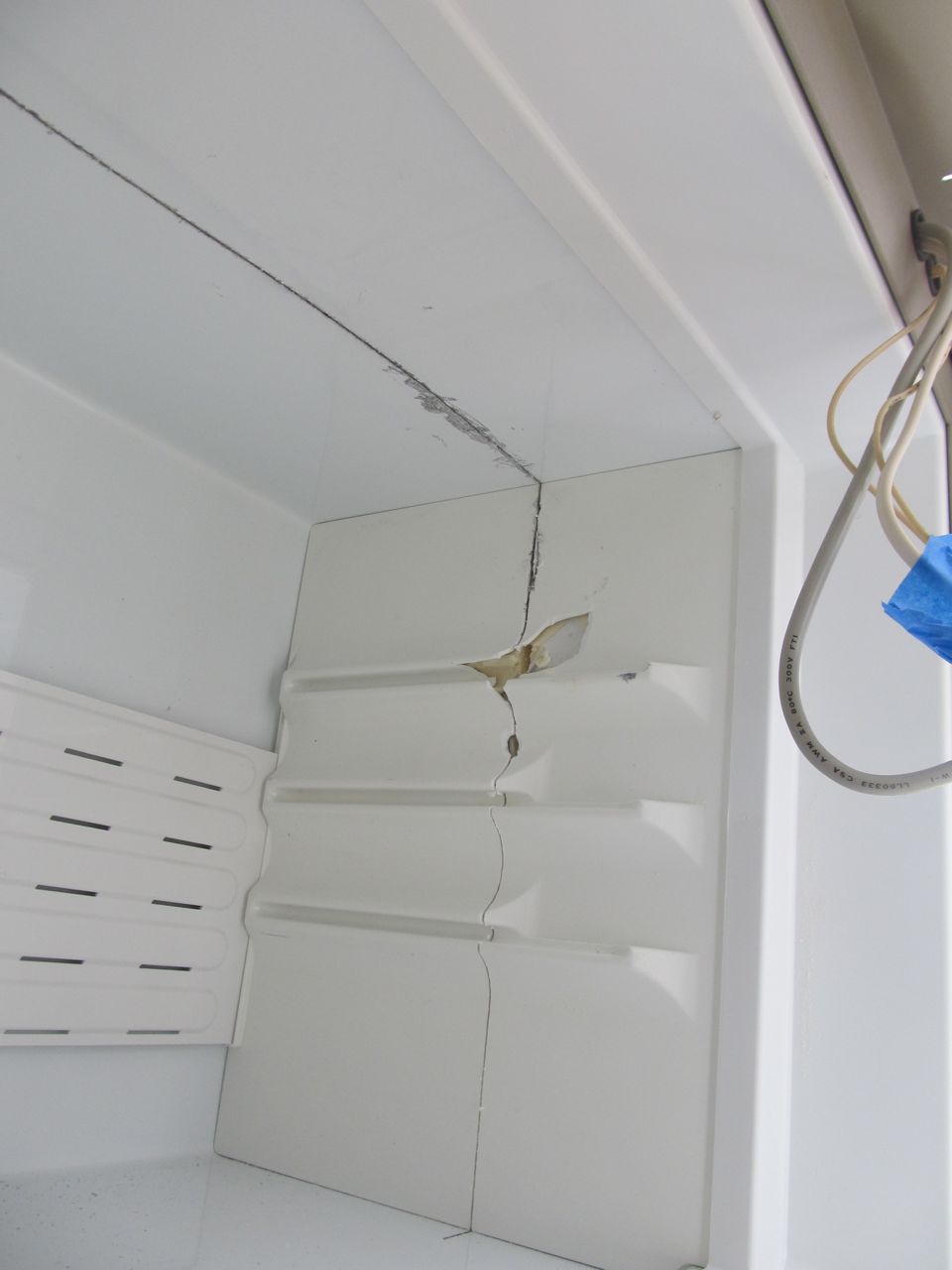

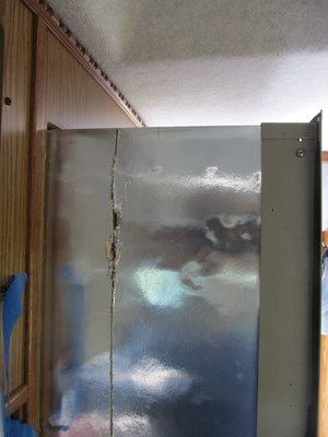

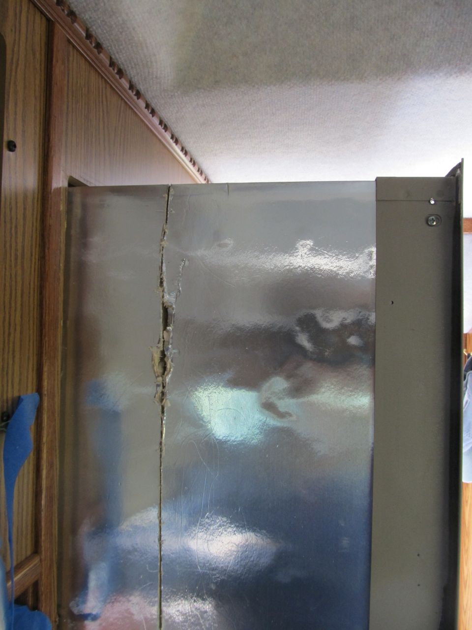

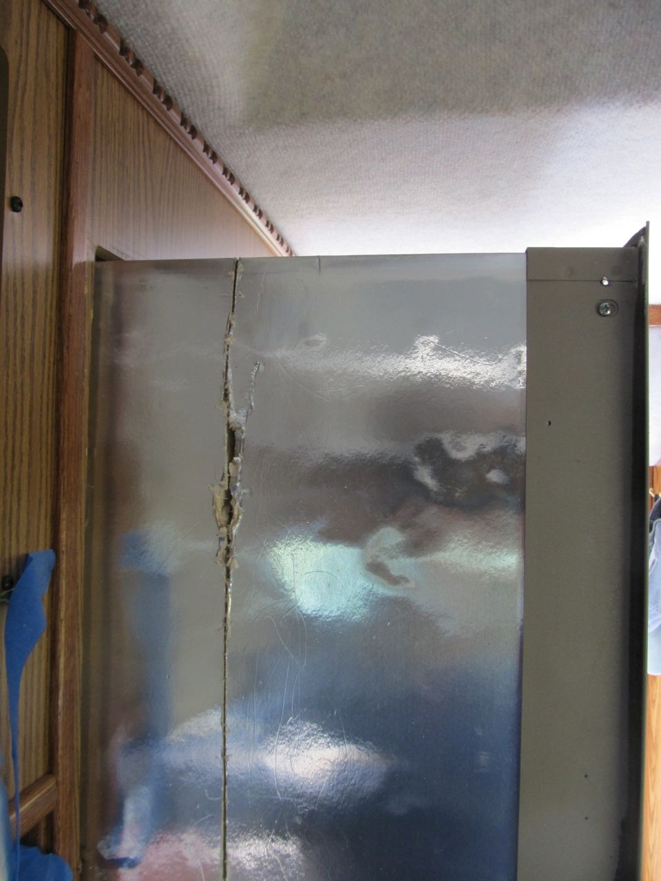

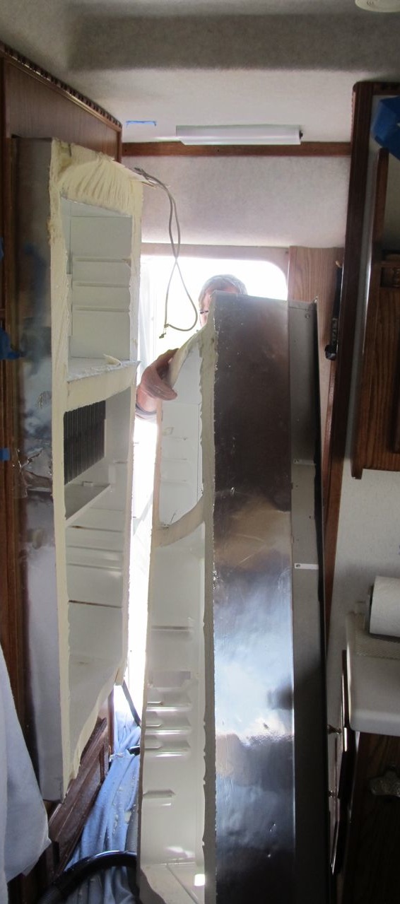

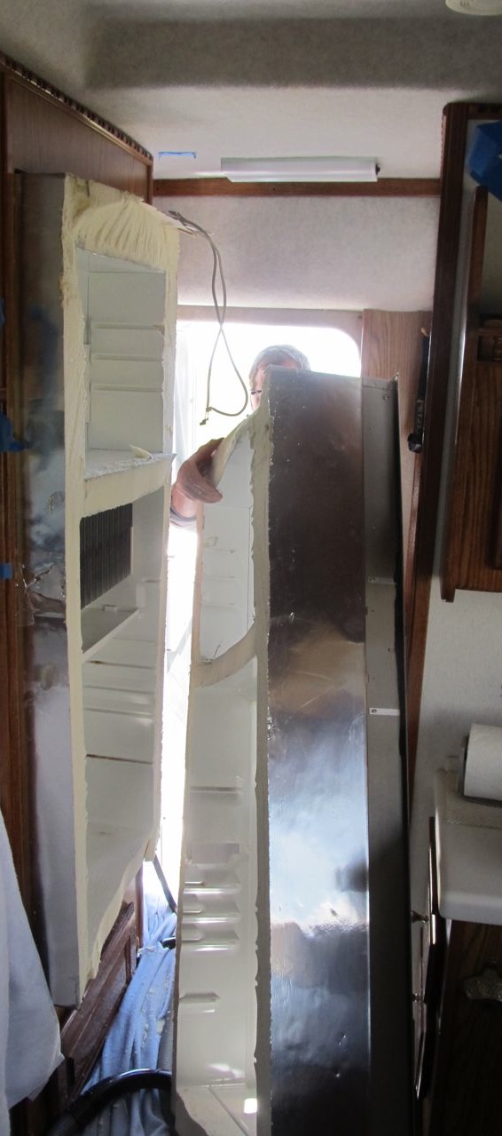

A few pics from removal of original Dometic RM3663 in my Concourse.
1) Pull out about 12" and apply Sawzall (or equivalent). On this refrigerator the line shown doesn't intersect anything "juicy."
2) Zip, zip!
3) Easily take your two slim refrigerator halves out the back door :mrgreen:
Easily remove two slim refrigerators via rear door.jpg [ 135.03 KiB | Viewed 773 times ]
Obviously this only applies if you are not trying to save the refrigerator. Mine was in very good condition, so I did consider less destructive means, but in the end wasn't willing to risk my back, remove a window, and/or scratch up the Chinook in order to save it. (Especially since the new one would easily fit in the back door.)
I did spend 45 minutes or so capping off the gas line (and testing for leaks), removing the screws holding it in place, and removing the shelves and various plastic baskets and such (which are now in another Chinooker's Dometic). But the actual "operation" depicted above probably took less than 30 minutes.
The carcass was hauled away by someone from Craigslist who wanted to tape it back together and use it at a cabin (or something like that).
I got the idea to cut it in half from reading a truck camper forum -- they have similarly constricted rear doors so can be a source of good tips.
Edited to add: I think I just remembered that pdemarest might have a side door model? Or am I thinking of someone else.... Of course even then the door might not be generously wide.
