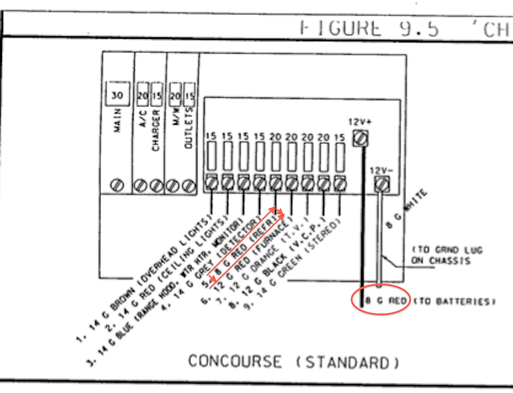

One thing to be aware of, if the wire gauge measures the outside of the insulation is that that can vary. Also there is SAE, AWG, etc. I forget what year you have (sorry!), but it shows as 8AWG on al of the electrical diagrams I've seen (granted they don't show as much for the later years). Mine is definitely 8 gauge. Stranded, but not the finer tined marine strands - more of a coarse bare copper stranding (with red insulation).
Oh, wait, duh - it should be printed on the side of the insulation. I might have a photo...
Well, the photos I can find show the lettering but not the actual section where the AWG size is listed. But it's not too hard to find. It's white lettering on the red insulation. There will be a lot of numbers you don't care about, but at intervals it will say "8AWG" (or whatever the size is). It's also interesting to note the temp rating, as that affects ampacity (not that you care about that in this case). Most of the wire I've seen Chinook use is rated 105ºC, which is good.
You could look at the stub behind the refrigerator, or where it comes into the fuse box (Brown Box), or where it goes into the LVD, or where it arrives at the batteries (at least on my rig these were all 8AWG, as the manual shows also.
PS: Here is the fuse panel diagram from the 2000 manual (Concourse shown). I highlighted the 8 gauge for the fridge circuit and to/from the batteries. It's the same in mine. One handy thing is that now that I have superseded both of those wires, I have them to use for other circuits. Ah, a nice big 8AWG going up to the driver's pillar area and over to the passenger side too!

Hey Blue - yep, its 8 gauge wire. The contractor I use on my house is also going to be doing some work on my Premier repairing some water damage, putting in some laminate flooring, building a cabinet door to close off the opening that was left from removing the television, etc. I'll probably have him run the new wire since I'm going to pull the fridge out to better insulate the area as well as to put some Dynamat around the generator enclosure. When boating season ends I'll have the winter for upgrades/modifications and then we will head out on a two week trip to Yellowstone, South Dakota and Montana. Hope to have our 2 year old German Shepard "tamed" enough by then to take him with us. If you think a Chinook is "compact" try adding a 115lb dog to the mix!
Re: 110 Volt Fridge
Sounds like a great plan. Yeah, you pull the fridge back out, but you accomplish a bunch of things that will have great rewards (insulation, eliminate gobs of voltage drop, sound deaden generator box).
