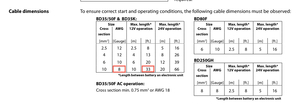

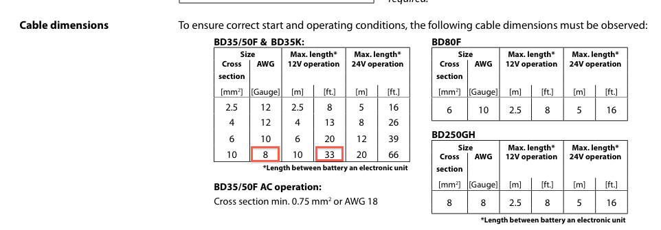

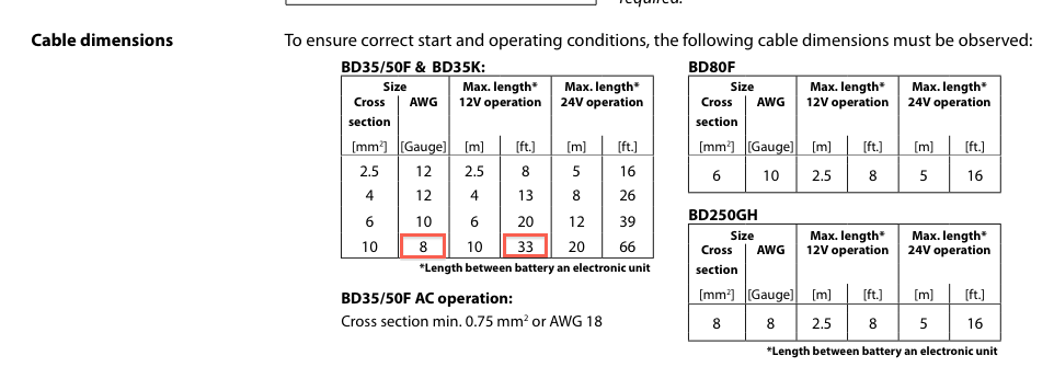

I'm still a bit skeptical about the wiring. The thing is, the electronic control units are sensitive to voltage drop, and in my understanding they can quit working if they have to "overcome" it all the time. The old absorption fridge likely didn't have any "fancy" electronic controlled things (certainly not a variable compressor), so it could live with the voltage drop.
Here is the chart from Danfosses .pdf that includes the BD50:
The attachment Danfoss wire.png is no longer available
So this shows that the maximum run from the compressor to the battery, with 8AWG is 33'. Presuming your Chinook is wired like the others, you would have an 8AWG run of around 60' from the compressor to the battery, with the second 30' sharing loads with all of the other Chinook electricals (because a ~30' run of 8AWG serves the entire DC fuse panel in the brown box). That's about twice as much as they recommend (plus it supplies other loads). So...?
Here is where I got the screen shot from:
http://files.danfoss.com/TechnicalInfo/ ... 00c802.pdf

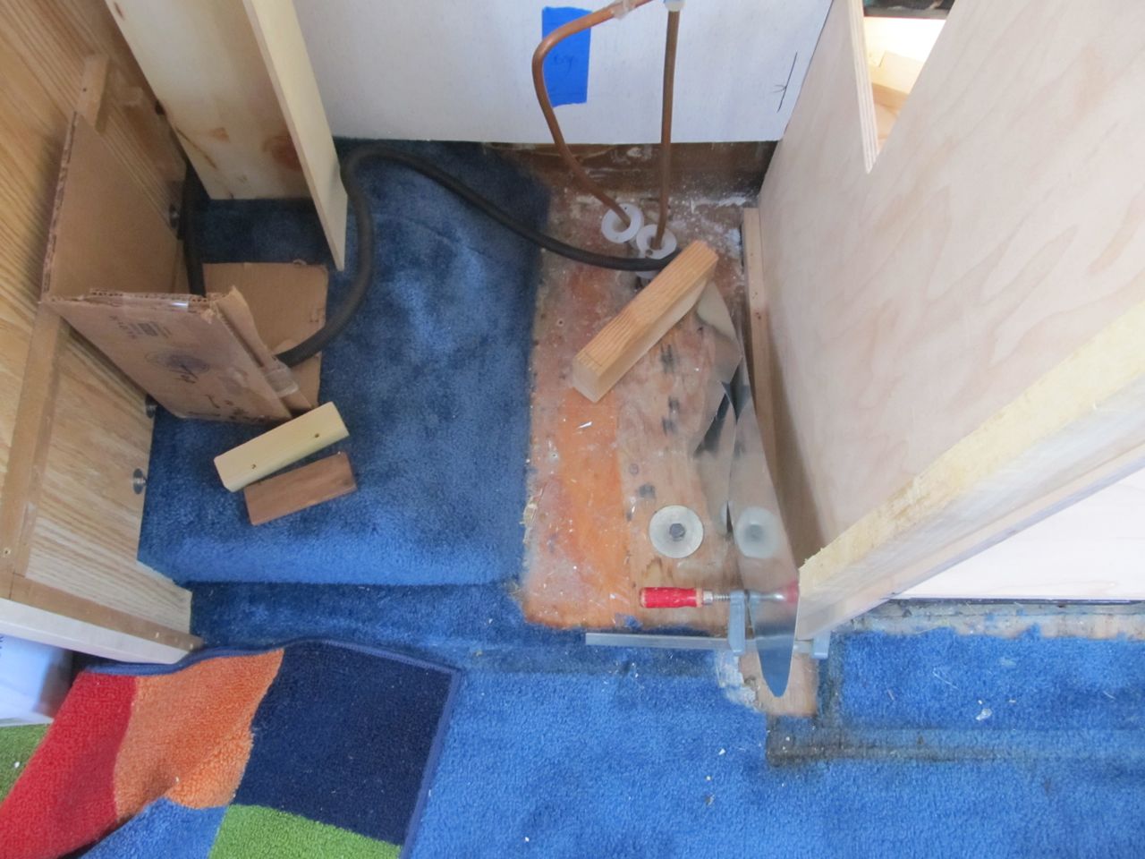

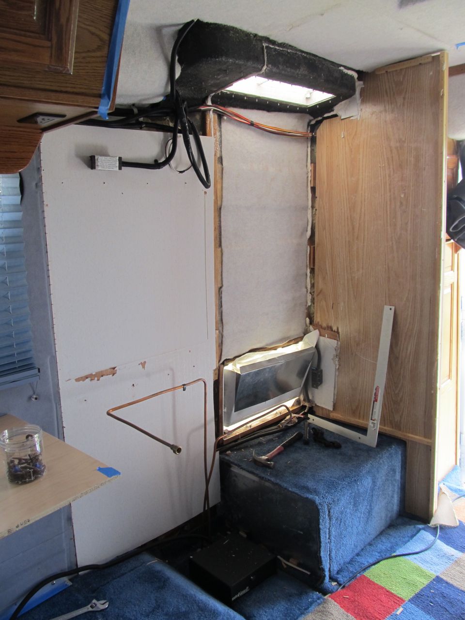

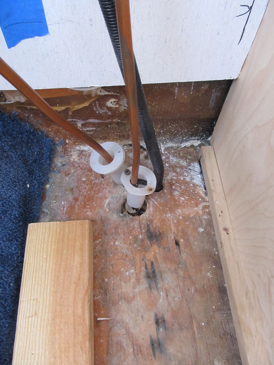

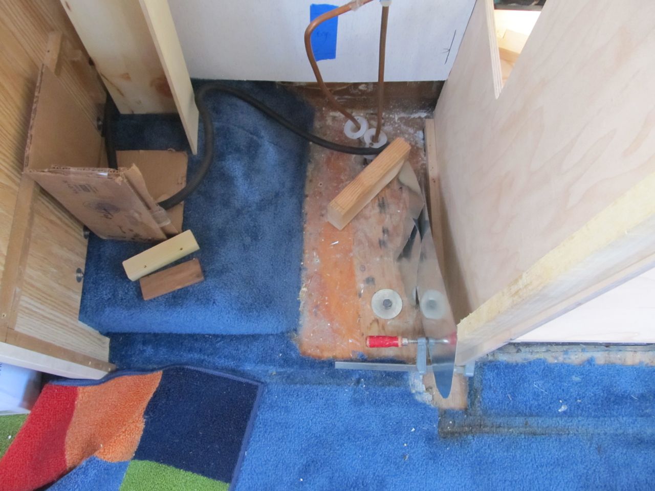

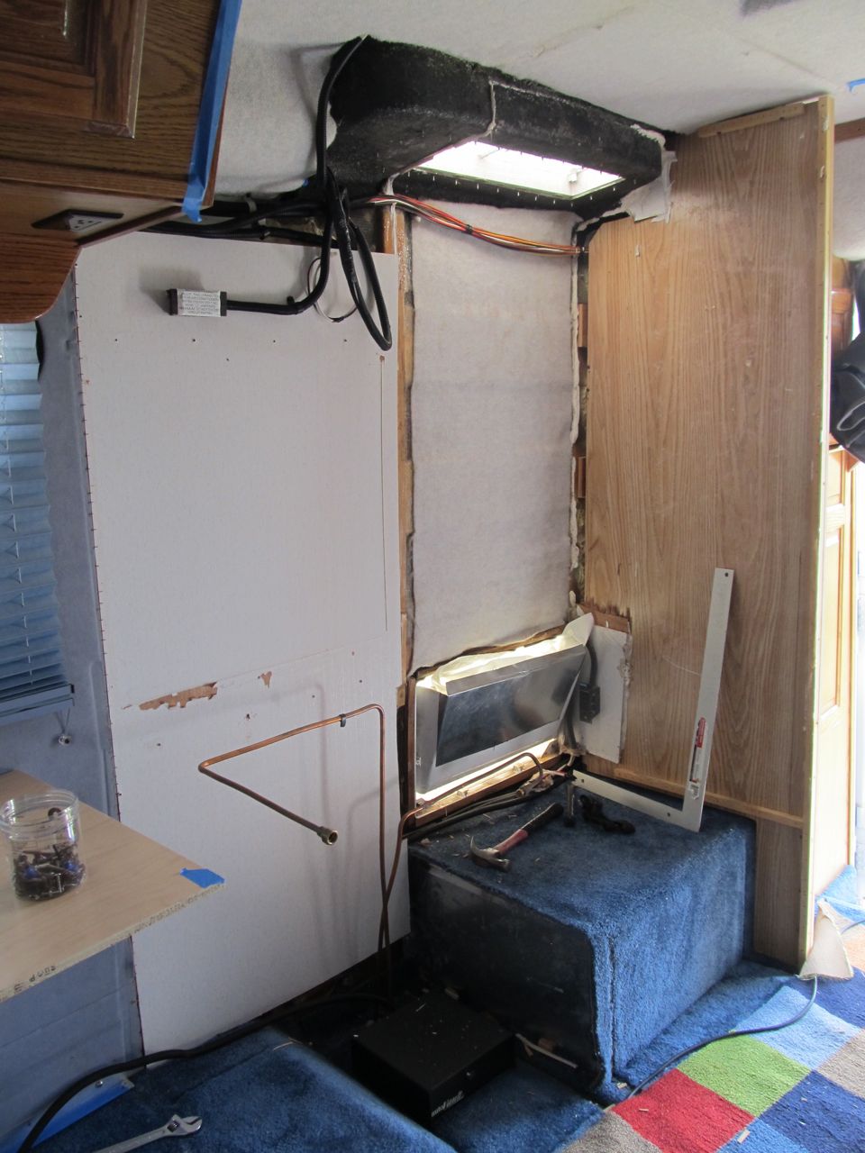

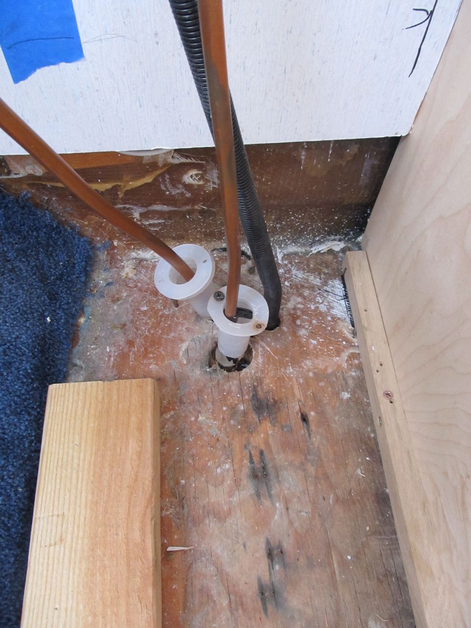

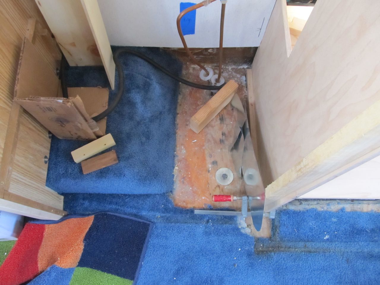

Anyway, with that long preamble, I plan to run through the floor, probably using the hole that the original fridge drain tube went through (as I don't think my new fridge has a drain tube). However if the fridge does have a drain tube, I'll just make a new hole in that same area. There are already three holes in the floor there from Chinook: One for the original refrigerator drain tube, and two for the stove and fridge propane lines. To access this area, I removed the range (because I had an oven), and then the false wall behind the range. Then the holes are in plain sight there. Here are three photos that show it (pardon the construction mess). This is on my '99:
Here is the overview. Refrigerator and stove are out. The carpeted box is the generator enclosure (which is made of metal under the carpet).

Closer look at stove compartment. You can see the three lines/holes. The black one is the original refrigerator drain.
And the super close look. Those white "grommets" were originally set into the floor, btw.
I'll give Chinook props for not having any propane joints in the coach (except for the ones you obviously have to have at the appliances). All the other joints are beneath the coach, as they should be. That way any leaks can relatively safely drain away (propane sinks). I just helped a friend get his other-brand Ford cutaway RV ready to pass on to the next owner, and although it is a "good" brand, there were propane pipe joints galore in the coach. And not only in the coach, but in normally inaccessible places. Boo.

Just to clarify, the three holes are behind (outboard of) the stove, not the fridge. The fridge compartment sidewalls (at least in stock configuration) are fitted pretty tightly and then sealed with caulk (as they are supposed to be when you have combustion going on behind an absorption fridge - it's supposed to be sealed off from the living area).
I don't know if you have an oven (or what has changed over years), but my range (stovetop with oven) had a false wall behind (outboard) of it. In other words, the oven was around 17" deep from front to back, and then there was a paneling wall there, and behind that a ~6" "secret compartment." The two propane lines and the fridge drain were in this compartment (which has been removed in my photos).
