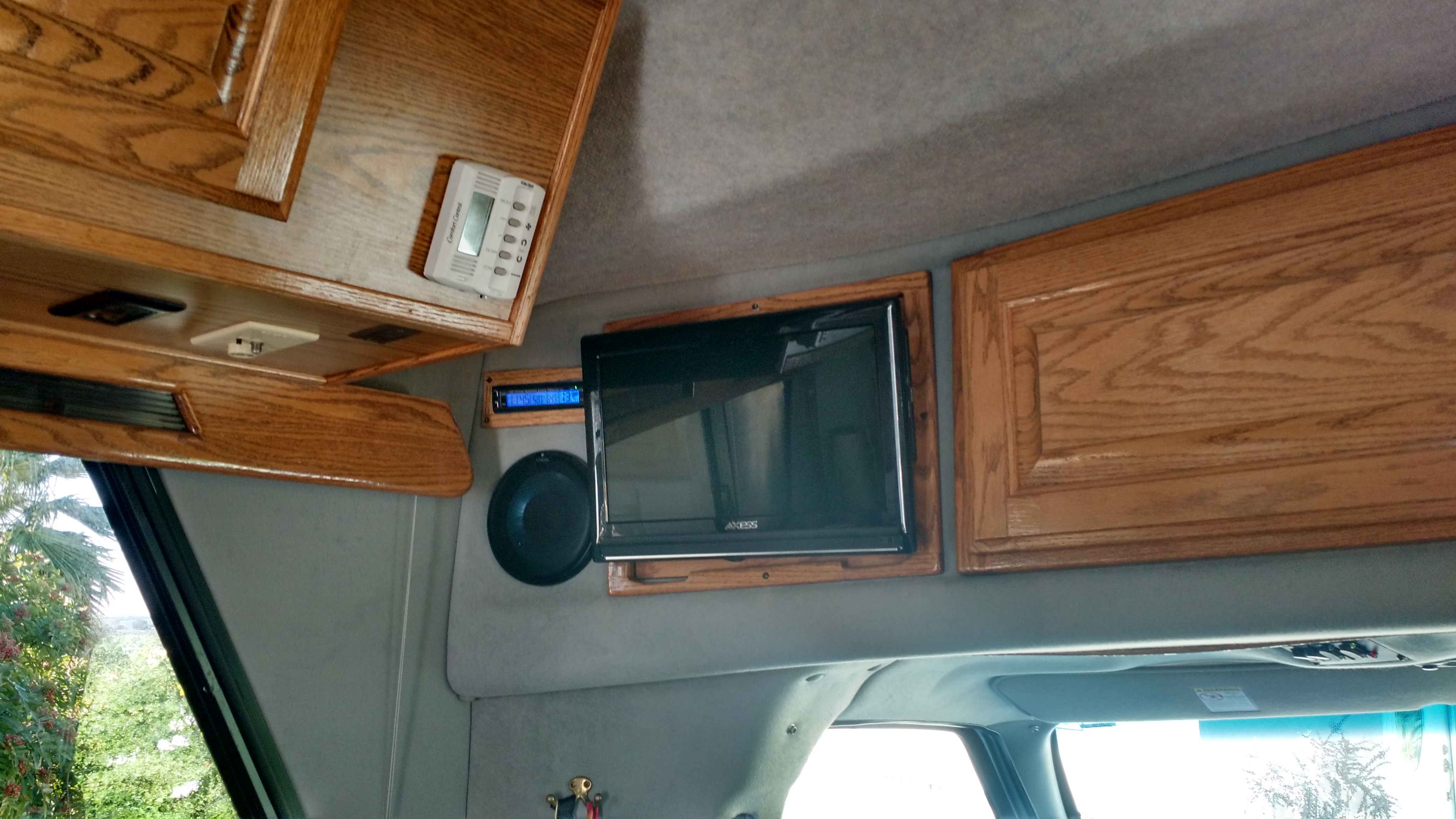

I installed a small 12 volt flat screen TV/DVD combo in place of the tv. I then installed a Double Din AM/FM/DVD player in place of the old VCR. Instead of using the DVD in the TV I use The one from the AM/FM/DVD as I wired it through the house speakers which provides good sound. I'm very happy with the set up. Pretty simple and basic.
EDIT: I just wanted to add that the rocker switch in the third picture was installed to act kinda like an ignition switch where the unit can be turned on and off without losing constant power.

Steve - very slick what you did with the VCR hole. Looks stock.

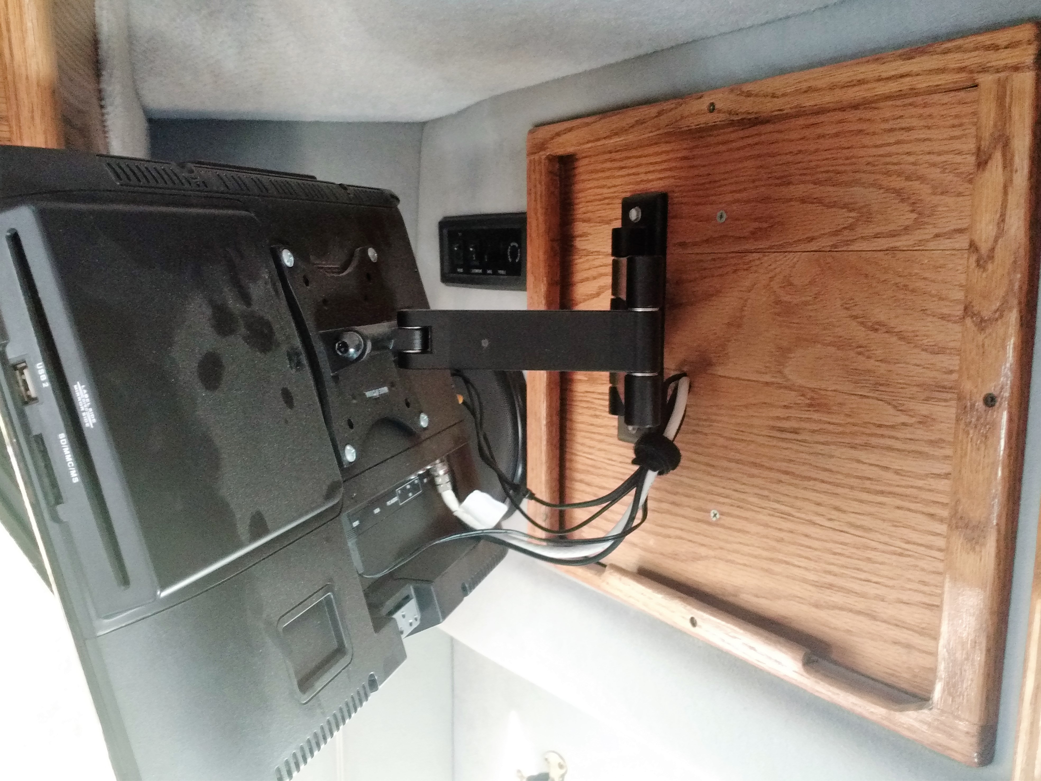

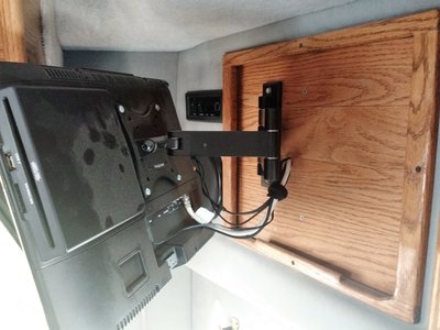

Thanks Scott. Not a lot of choices out there for 12V TV's! Thanks for the heads up on the wires I'll check mine. I installed a J Box w/ 12V cigarette lighter type outlet in the overhead and plug it in only when it is used. When I removed the old TV I filled the hole with some birch plywood and installed an old mount I had on hand. The DVD player required a larger opening but was easily made to look original with a router and some varathane.Scott wrote:I bought one of these units. I never mounted it because we very rarely use it. But on those rare occasions, I'd just set it on one of the beds and lean it up against one of the cab seats. The picture is fine, the DVD drive works well, and it's easy to use. I'm not an A/V guy, so. The supplied 12v cord melted after about 15 minutes (gage way too small, surprisingly). I replaced the wires with heavier stuff, and all was well again.

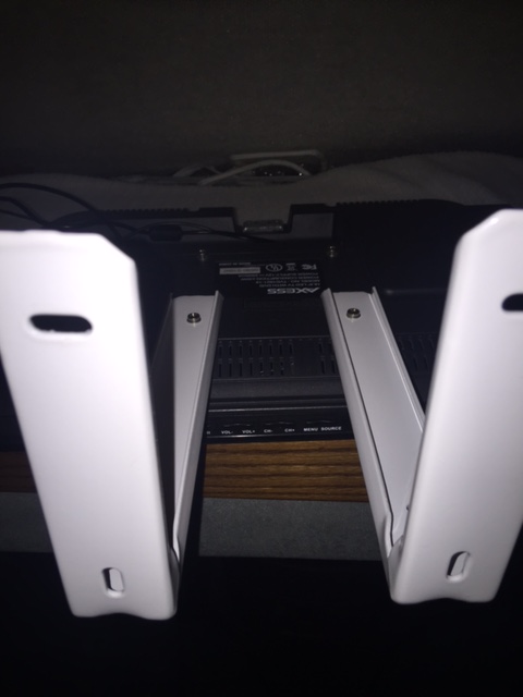

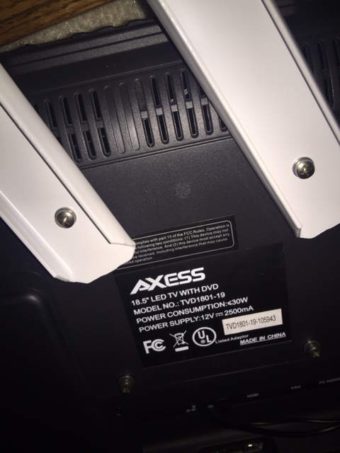

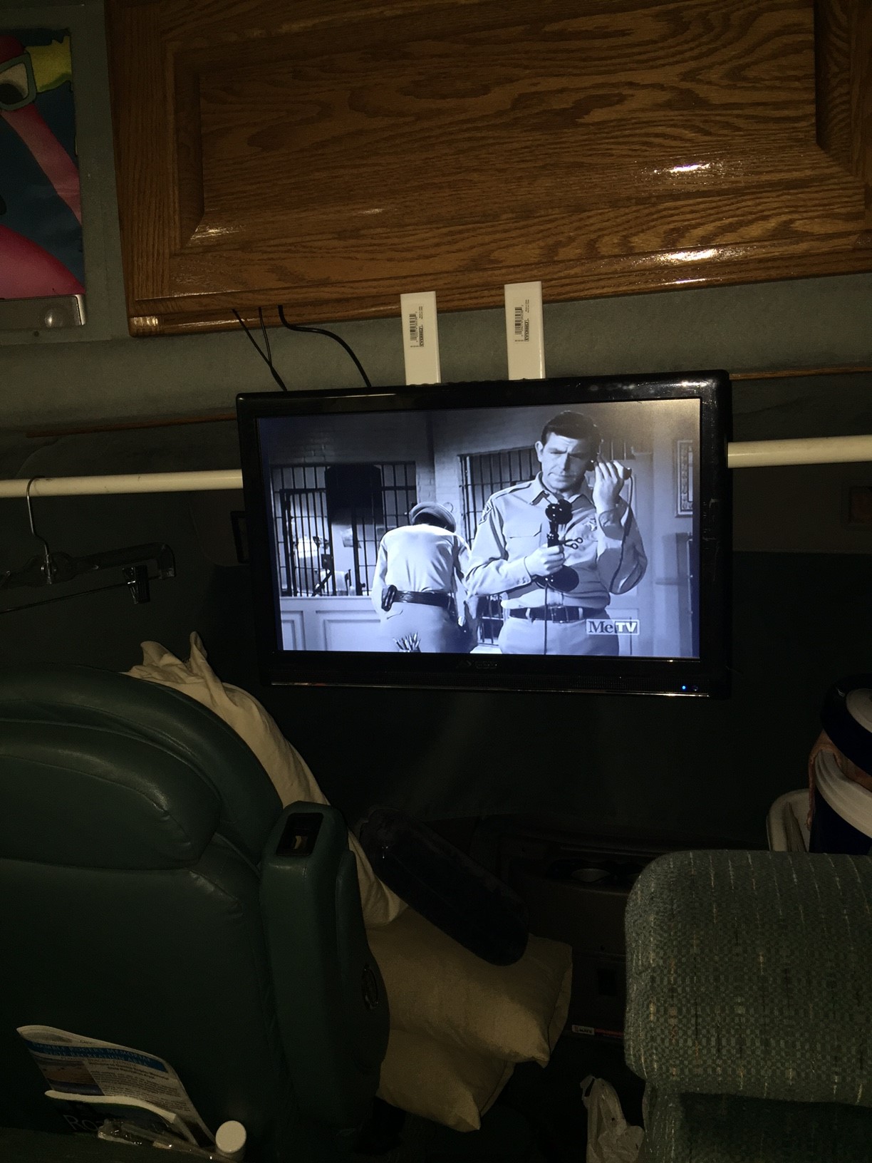

When you look at my install job think of simplicity, and not craftsmanship. When I met Red Land Baron ( Chinook diesel owner ) at a casino parking lot, he showed me some mod's he made on his rig and this concept was his idea. I bought the Axcess 19 inch tv/dvd combo which works very well considering the cost even though the viewing angle isn't great. By attaching two " L's " (from the shelving section at Home Depot ) to the back using the VESPA holes, it allows for simple setup and storage . The picture is very good from all sitting areas. The other thing was the poor sound from the tiny television speakers. So, I bought a $20.00 computer sound bar at Staples which could clip on to the television or placed anywhere the cord allows it. Mine is placed in the original television opening. You can barely see it in one of the pictures. I use the original 12 volt plug from Chinook to power the unit. Again, simplicity over craftsmanship.

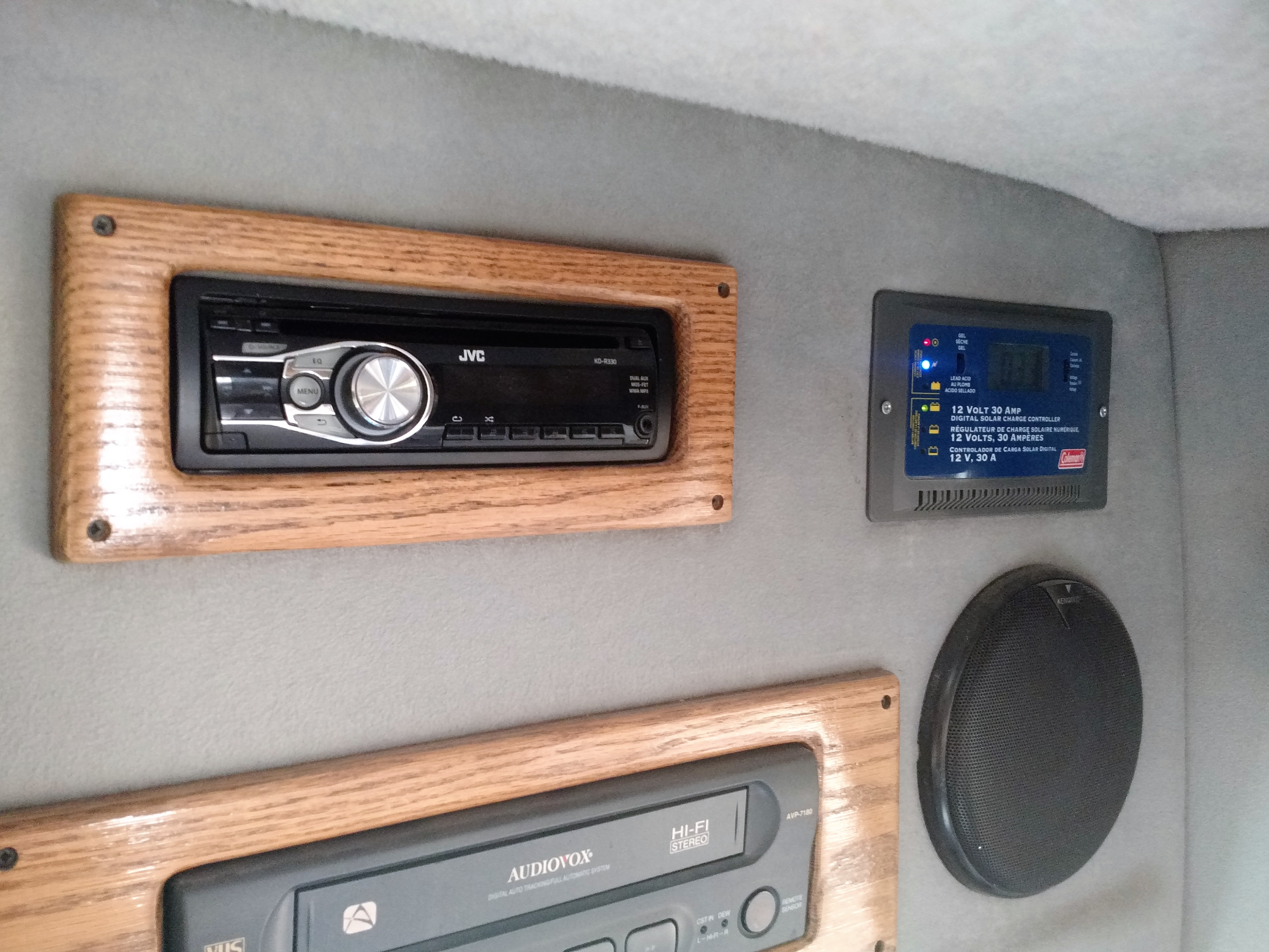

I also bought the Axess TV/DVD. The viewing angle is not very good, but we have a tilt mount so we tip the TV forward to get a good angle from below. For the sound I used a stereo cable connected from the headphone jack on the TV to the AUX input of our coach stereo. (The cord has 3.5mm stereo jacks on both ends). I found a JVC stereo with AUX inputs on the front and the rear, so the speaker cord is permanently plugged into the rear AUX connector. This way we get great sound through the stereo and the four built-in coach speakers with no external wires. We still use the VHS player, so there is a stereo AV cable from the VHS to the TV as well. I cut off the 12v power plug and spliced the wires into the original TV power cable in the cabinet.Xatlatc wrote:When you look at my install job think of simplicity, and not craftsmanship. When I met Red Land Baron ( Chinook diesel owner ) at a casino parking lot, he showed me some mod's he made on his rig and this concept was his idea. I bought the Axcess 19 inch tv/dvd combo which works very well considering the cost even though the viewing angle isn't great. By attaching two " L's " (from the shelving section at Home Depot ) to the back using the VESPA holes, it allows for simple setup and storage . The picture is very good from all sitting areas. The other thing was the poor sound from the tiny television speakers. So, I bought a $20.00 computer sound bar at Staples which could clip on to the television or placed anywhere the cord allows it. Mine is placed in the original television opening. You can barely see it in one of the pictures. I use the original 12 volt plug from Chinook to power the unit. Again, simplicity over craftsmanship.
My latest project was adding an indoor/outdoor thermometer with a clock and battery voltage readout left of the TV where the old sound control panel used to be. The outdoor temperature uses the old telephone wire to the outside compartment for the outdoor sensor.
