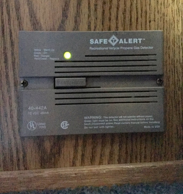

Finally, test your propane detector with a butane lighter to see if it still works. I agree with Scott it should be replaced anyway, a small investment for safety especially if it is 14-years old. Good luck

BTW, when it was mentioned to check the propane detector with a butane lighter, I'm sure it was meant to ONLY release butane, but NOT spark or light the lighter. In other words use it as a gas source. The typical RV type propane detector has a finite lifespan, so I'd probably replace it. Mine is near the floor on the sink cabinet (propane sinks).

My bad - I just read the fine print on my propane gas detector and it says do NOT test with a lighter! Anyway, this is a timely thread as it prompted me to go check and discover mine should be replaced. For 2002 the unit pictured is an MTI Industries flush mount 40 series # 40-442A in brown.
