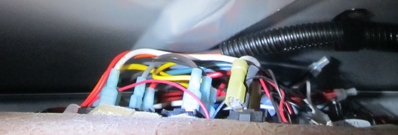

Hi, have another question of the electrical wiring nature. I notice some wiring hanging down from under the dash on the driver's side of my Chinook. The wires were off of the "emergency start" switch and the "battery disconnect" switch. I found dash wiring diagram in an owners manual that I downloaded but is doesn't show all of the coloring of the wires. If anyone knows where I might find a more detailed diagram, or has one, I sure would appreciate you sharing it.

Even if someone could take a look at the wiring on their Chinook and tell me what color the wires are on these two switches, it would be help.

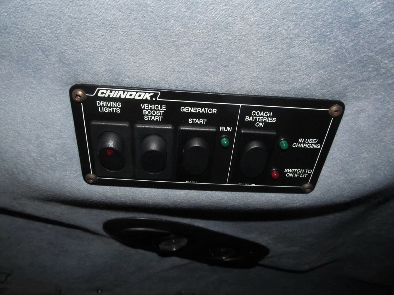

BTW, here are a few photos that may help. I have more/better ones, but am on the road and can't get to them just now.

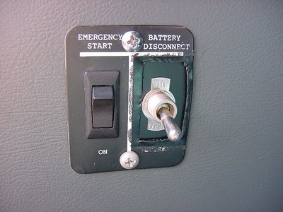

Here is the switch panel over driver's shoulder on overhead:
Bad shot of wires above it (I have a better one but can't access it at the mo'). This is looking forward from coach toward front of rig.

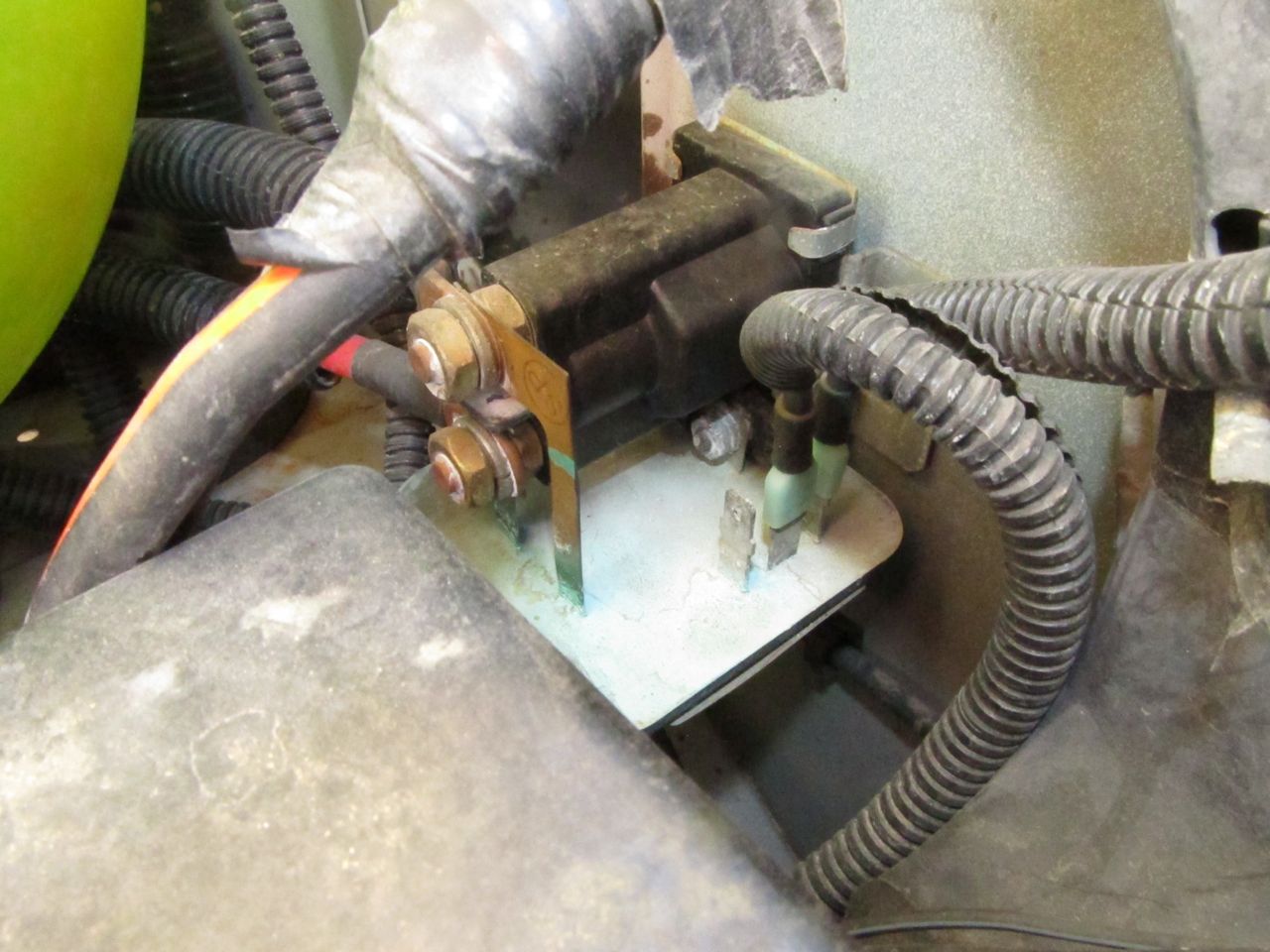

Sure Power 1315 under hood (can find wiring diagram online):

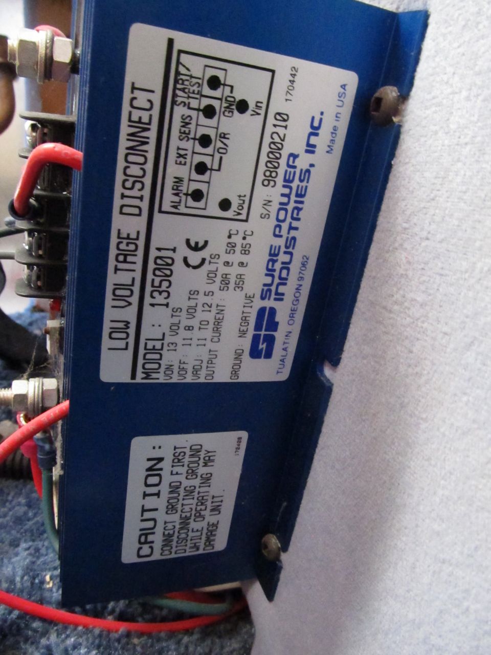

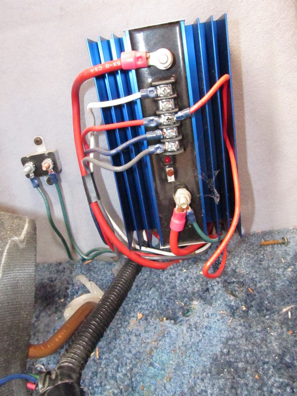

Sure Power LVD on floor ahead of couch:
Diagram on side of LVD:

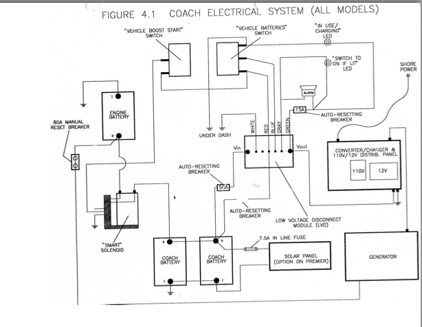

Here is the main DC diagram for a 1998 Concourse. The "busy" looking square in the middle is the LVD. The top row (two squares and a speaker) are the overhead switch panel in the cab. The square at lower left with the heavy black "L" shape along one side is the Sure Power 1315 under the hood.

Okay, well that install looks a little questionable (aesthetics), and so if it were me and it wasn't working, I'd likely just plan to re-do things. Then you know what you have, and that it works and is safe.
If you were to buy a Blue Sea 7622 (battery relay), then it comes with a remote lighted switch so you could use that and potentially solve two things at once (old separator that may be recalled and has negative qualities that older separators had, plus you'd have a lighted switch). Here is what I mean:

PS: Most relays are not really mean to be "outdoors," so you could also move it to somewhere a bit more sheltered (presuming yours is on fenderwell like mine was).

2) The "battery disconnect" switch you have performs a different function (I assume, but may be wrong). It's a bit ambiguous as shown.
a) What I think it may be doing is serving as your house battery switch. What this does is disconnect your house bank from the house loads. Nothing to do with the Ford/cab/start battery.
b) But it also could be "disconnecting" your start bank from your house bank, maybe.
