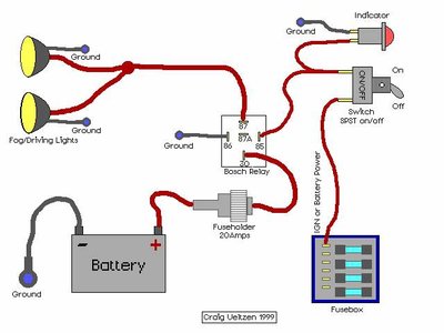

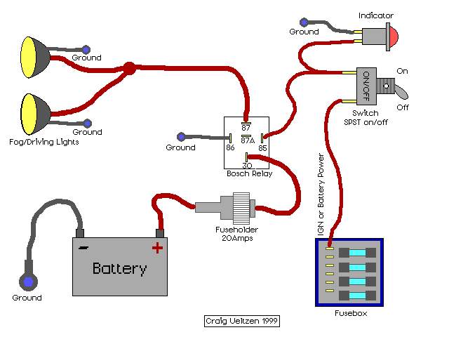

I would think there must be a relay involved that ties into the headlights?? You could reconfigure the relay so that the driving lights are activated with the switch and take the headlights out of the loop. Or, you could just re-wire the driving lights entirely using your own relay but you would still need to trace down the wire coming from the overhead switch. Use the existing switch and wire to trigger the new relay, the relay would be wired directly to 12 volt and another wire to the lights.
Doing it this way keeps all the current from going through the switch as the switch will just be activating the relay. The drawing below shows how to do it...
Bob
Bob
