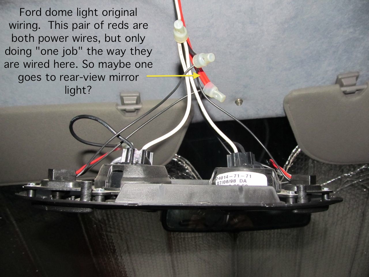

I also have a '99 Concourse with the rear-view mirror that shows temp and has a compass, plus the two lights in the bottom. On mine the temperature works fine, but I have never been able to get the compass to work. It says "CAL" (calibrate) 99% of the time (every once in a blue moon it shows a direction). I tried all the methods of calibrating to no avail.
Anyway, from what I can tell, it is a "Prince" mirror, but that has not been helpful as I have found no data on it except a patent application (not helpful!).
I can say something about the lights, at least on my rig. They were wired in to connect with the dome light that comes on when you open the door. The power wire *may* come across the overhead from the stock Ford dome light. The reason I only say "may" is that I'm not sure, but the power wire for the Ford dome light was two side-by-side red wires (in other words, there was an extra power wire). That may have something to do with the mirror lighting.
(I absolutely hated that the dome lights would come on when opening the door and there was no way to NOT have that happen. Just what I want at campsites, star viewing, etc. (not!). I re-wired the Ford dome light so that I have the option to not have it come on when the door opens. That worked out great. However, before doing that, I had removed the light bulbs from the rear-view mirror down lights (never used them as they were too far away from me being in the middle of the dashboard). So for that reason I didn't investigate that "duplicate" power wire that led to the Ford dome light. If I hadn't already disabled the mirror lights I would probably have checked into that (or if the mirror lights had been useful, I would have taken the time to figure it out and maybe re-install the bulbs).

Here is a photo of the Ford dome light in my Chinook after unfastening it from the headliner. See the pair of red wires coming in? They are both power wires, hooked up together as they affect the Ford dome light. I wonder if one of them relates to the rear-view mirror lighting (which in my rig came on with the Ford dome light when the doors were opened).

Well finally got around to checking this out. 12V power wasn't the issue. Got power all the way to the unit, it appears the internal board has gone bad. So sad, now the search is on for a replacement.
