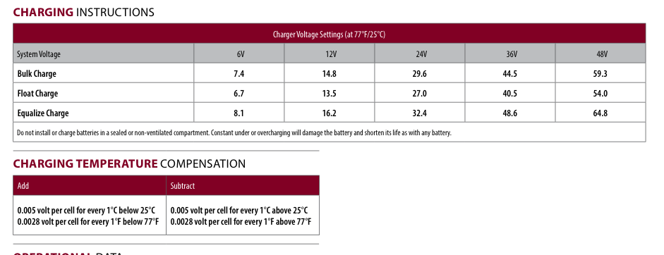

Just to add to what I said above, the whole charging system is inter-related. As a part of this, batteries like specific charge voltages. So you need to have a charger (AC [shore, generator] and solar) that can be adjusted to the voltages your battery brand specifies (you typically set two voltage parameters, absorption and float; there is also equalizing which you may do infrequently and which also has a settable parameter). The other really important thing is temperature compensation. Here's why: Those very specific voltages you just set your programmable charger for? They only apply at 77ºF. Any colder or any hotter (the battery, not the room) and that voltage changes. So even if you have a programmable charger, if it's not temperature compensated you will be using the 77º setting all the time. My batteries are often at 40-50º and that's a huge difference.
Take right now. I'm poking a few buttons on the solar controller display for this info. I'm boondocking and so solar is the only thing charging the battery bank right now.
My batteries are in the absorb stage. The "setting" for this (as specified by battery mfgr.) is 14.3 volts. So that's what I set into the controller for the absorption voltage. But guess what? The solar controller is putting out 14.55 volts (a huge difference in the battery charging world). Why? Poking the display again I see that the battery temperature is 55º F (and that's with the batteries under the couch, not outside). If I had a non-temperature compensated charger - even if I set it perfectly in the custom settings - my batteries would be getting chronically undercharged every time they were below 77ºF, and overcharged any time they were above 77ºF.
From a charger owner's perspective, temperature compensation is easy as long as you buy a charger that provides for it. Along with the charger will come a thin wire that has a pre-made way to fit into a special terminal on the charger, and then a ring terminal (usually) on the other end. You click the one end into the provided receptacle on the charger (solar charger or AC charger), and then fasten the other end to one of your house batteries (typically on the terminal, although I have seen some older ones that you tape to the side of the battery - not quite as good, but worlds better than none at all). Nothing hard about it.
One more step you can take is to look in the battery mfgr's manual again, and see how much they want the charging voltages to change for each degree up or down from 77º. That, too, can be set in the charger (there was a default setting in my solar charger, but it was not correct for my batteries so I re-set it as provided for).
My guess is that incorrect charging is the main reason many batteries die. Taking them below 50% shortens their life, but it's likely ocassional. Incorrect charging is chronic and happens every day - even if you are being really "good," and only taking them down to 80% charged. Even on those "good" days it's stressing the batteries by charging them at incorrect voltages.
I'm not as up on flooded batteries, and my sense is they will take a bit more abuse. But I did just have a look at Trojan's website (they are a premier maker of flooded cell batteries) and they DO specify charging voltages and temperature compensation and also do say that under/over charging will shorten their life. I downloaded the data sheet and here is a screen shot from it. Flooded cells may well be less "delicate" than AGMs (pretty sure they are) but this tells me they will still do better with precise charging and temperature compensation (although somewhat less expensive to replace when they die).
I think I remember that when I was charger shopping that the typical "converter upgrade" chargers didn't have temperature compensation, and may not have had adjustable charging either. If this is true, I'm not saying they don't have a place. If you have $100 batteries and it's not an issue to replace them (easy access for removal, you are near battery stores) then it may be just the ticket for a balanced system. For myself, with a larger (more expensive) system, it wouldn't make sense because I want to keep everything up to the same "level" (if that makes sense?). I mean, my system is puny compared to many RV-ers and boaters (can you say 1500 watts of solar and a 1500 ah battery bank :shock: - I read of that size system often on larger rigs). But just the three batteries I have are around $1200 total, so I had lots of motivation (and even cost justification) when I went to choose solar and AC chargers.
