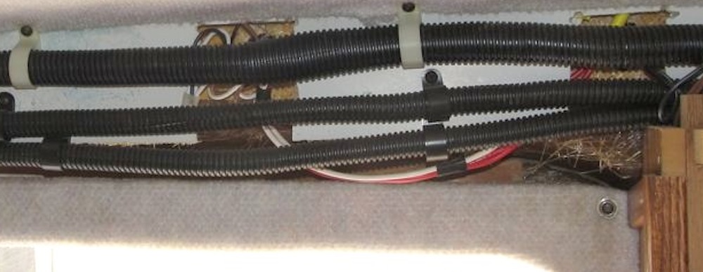

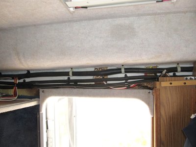

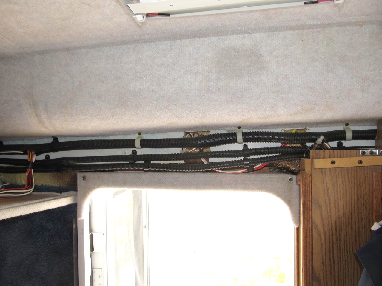

Say, since it's exposed on my rig right now, I took another look at that pigtail of wire that comes down from the rear hall light to the area just above the door. There is about a foot of wire on the light pigtail that is exposed there, and it is wire nutted to what is presumably the main feeds coming from behind the shower (one nut for white/ground; one nut for red positive). Any chance one of those got loose or somehow malfunctioned?
If you don't already have it off, the carpeted "half tube" above the door (what you would bump your head on if you walked straight into it on your way out the door) comes off fairly easily, and then all those wires are exposed, plus the wire nuts.
Here is a photo I took of mine earlier. It's a little hard to tell in the photo (I can take a more illustrative one if you like), but the "larger" red and white wire you can see is tucked in and the yellow wire nut(s) are up to the right. That's part of the light pigtail. You can just see the light fixture in question at the top of the photo. When the photo was taken I had already converted it to LED, hence the clipped little wires inside it (I went with a tube shaped LED bulb).
Here is a zoomed crop. The left hand side (as we see it) of the red/white wire is where they "break out" of the loom. Then the pigtail is led over to the right and tucked in (yellow is the wire nuts).
The black wire looms are original. The two smaller ones each have a pair of Romex type A/C wires; the larger one is the main DC wire bundle, all heading over to the passenger side.
