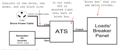

Here is a diagram that shows how an Automatic Transfer Switch (ATS) figures in. In our case it's mounted to the back side of the "brown box" (behind the breaker panels). I figured this might help show how the shore power cord fits in:

Thanks for the details that should be a big help. The black box on the left in the cubby is an auto drain so it's not involved with the shore power cord. I wasn't sure if the transfer switch on an rv would also be tied into the house or coach battery . I was concerned that the shore power cord could become live through the batteries. I may just try to eliminate the taped up portion of the cord and run with a shorter cord until I can get some help. I am a little intimidated to pull out that box. I don't want to cause a bigger problem. I'm just trying to get in local overnight trips I'm new to any RVing so I wanted to get some experience with the rig.

I get what you are saying on the shore power cord. One solution would be to just not plug in until you get it fixed. Using an inferior/broken cord could be dangerous.
However, unless you have a built in inverter (would not have come stock on that year), there should be no voltage in the AC system if you are not plugged in and are not running the generator, just so you know. If you think about it, if there were, then the prongs of your shorepower cord would be "hot" in the compartment. But of course you also have to have a comfort level to work on it.
