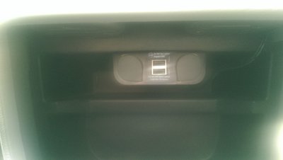

"Chinookers Journey" did a nice install of one, cleverly using the ashtray area in the 2003-era console for the display mount (which I also now have), but the one thing I don't like about that specific one is that it's a 9" display. That just sounds a shade big to me, and that company doesn't have the same camera with a 7" display. Too bad as I'm always up for just copying an excellent job :D

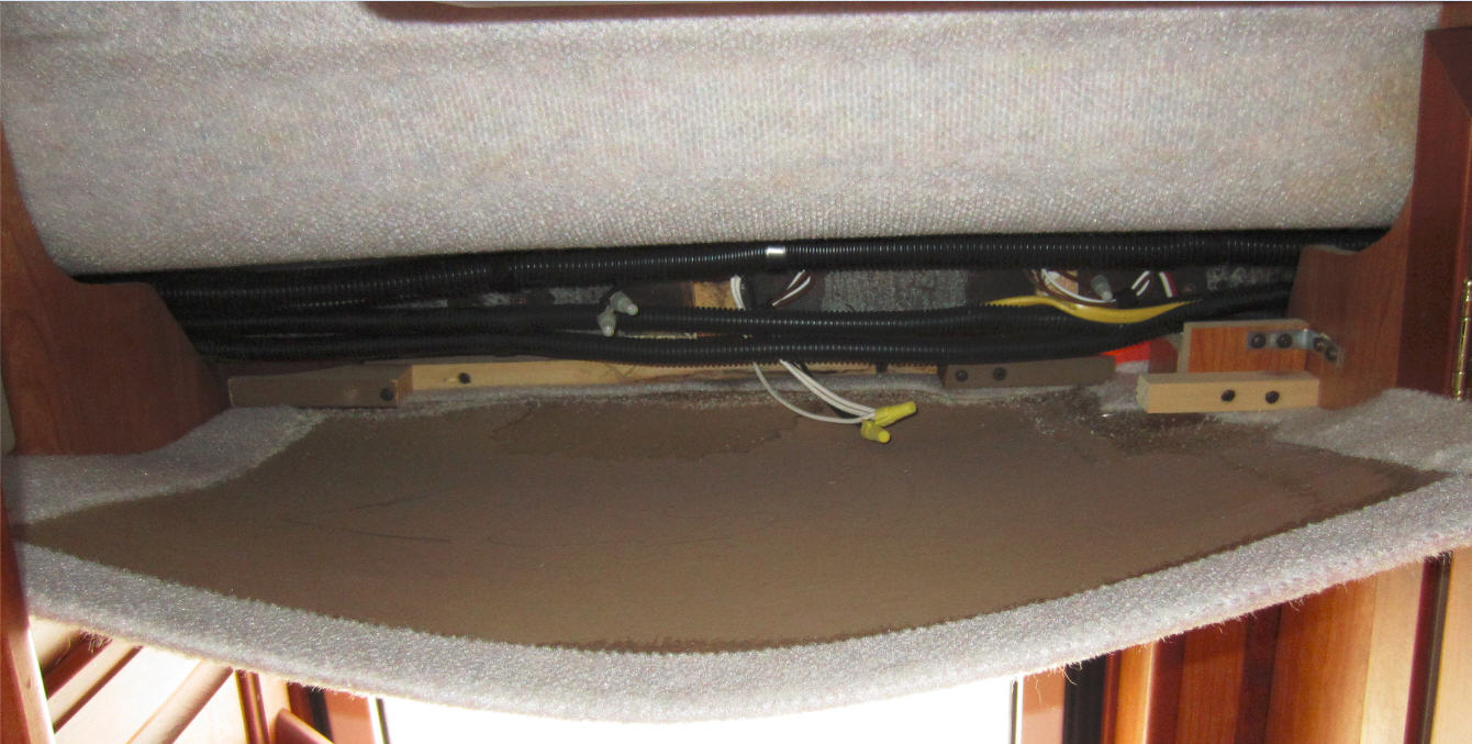

The curved header carpeted trim above the rear door can be dropped down to peak behind by removing the screws from the wood trim strip at the top. Behind it are 3+ armored wiring harnesses and some view of the clearance light wires. Not much space in there. Looking at a picture I took I don't think I see the camera wire. It might be just beyond that area behind the bathroom wall.

Oh shoot, I am so sorry about that mistake. I guess what I *should* have said is that I would prefer a slightly smaller monitor. Of course I can still copy your excellent ashtray mod :D In fact, I just pulled that little ashtray plug out of storage the other day (I had removed it since that leaves an ashtray-free storage cubby).

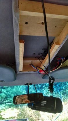

Receiver - I wired it and the display into the overhead console on my 1994, with a switch tapped into the overhead map light power. I drilled a hole in the right front of the console so the wire could go behind the headliner down to the display.

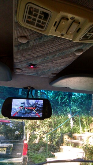

Display - I'm really proud of this. The Pyle has spring-loaded rubber tabs that let it mount over a regular rearview mirror. However, its heavy weight kept pulling down the Ford window glued stock mirror.
So I thought about it, then found a $14 black 1948 Willys new stock mirror that I simply screwed into the ceiling! It's small enough that the Pyle completely covers it. Perfect.
