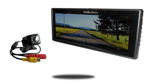

I decided to take the plunge into this endeavor as well. With my on-going rig remodeling project, the interior rear entry and fridge side of the galley have been basically gutted for new cabinet work, etc. This will give me the opportunity to run video/camera cable along the passenger side of the rig. After researching several install ideas, I determined I wanted:
• a "hard-wired" system (not wireless)
• full time rear view (not just for backup)
• at least a 9" wide color monitor to be placed where the mirror is now
A Tadi Brothers system (http://www.tadibrothers.com/catalog/bac ... kup-camera)
seems to address all my wants:
• 9" Mirror with 170° Backup Camera SKU93228
• Color
• Clips over existing mirror
• On while driving or in reverse (Mirrored Image)
It would appear I can tap into the existing rear view mirror power wire and use the "powered video cables" to feed the camera. Seems easy peasy enough (?).

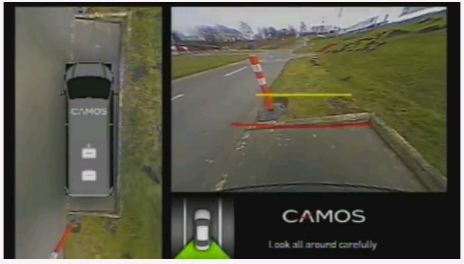

Has anyone thought about getting one of the "surround" / "omnidirection" overhead view camera systems?
They have (at least) four cameras... front, rear, left, right... whose output is folded together by a computer to display what looks like an overhead drone view of your vehicle (lefthand image in the split monitor view):
Most systems like this will show both the surround view, and a front / rear / left / right view depending on whether you're in reverse or not, or if you have a turn signal on.
What made me look into this, was having to back into my father-in-law's very curvy driveway one night. Even with a spotter outside, it was difficult. An overhead IR surround camera view of the driveway would've made it a piece of cake to do by myself.

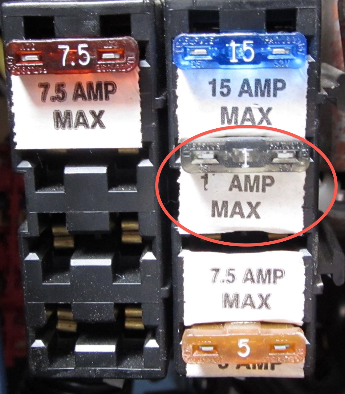

I haven't tapped into the mirror, and you probably already know this, but my mirror (also has compass and temp) takes its power from the Chinook auxilliary fuse panel by the left driver's shin. I noticed that in Chinook literature they referred to it as the "Prince" mirror. I did find one bit of US Patent info for the Prince mirror but little else. No idea if it really is a Prince mirror or if that was some type of Kleenex term that just stuck around even after they were no longer Prince brand.
Here is a photo of my auxulliary fuse block with the 1 amp mirror fuse circled.

I realize this isn't the same as telling you which wires up by the mirror carry power, but at least you could work backwards.
Another note, slightly un-related but in case it helps at some point: The two lights on the underside of the mirror are controlled by the dome light circuit. You probably already know that, but just mentioning it since those wires may be up there too. Not saying you'd want to use those, but rather avoid them.
I "got to know" those wires when I finally (praise the night sky) figured out how to re-wire my "illuminated entry" dome lights that WOULD NOT BE SHUT OFF when the door was open (or even if someone touched the outside door handle). Boy did I hate that feature (gone now though!).

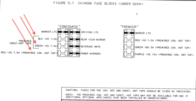

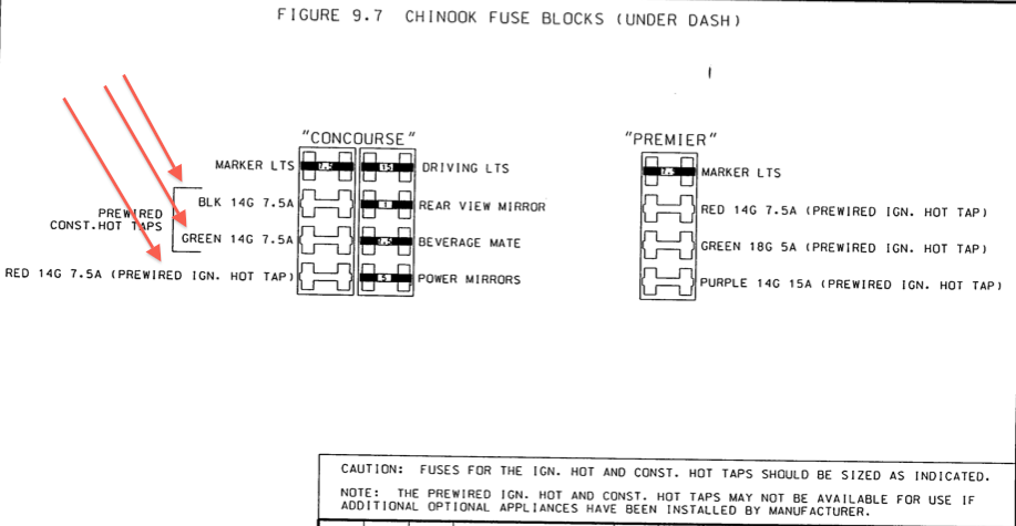

Just curious, but don't you have the pre-wired ignition or hot taps on that fuse block already? I thought that was standard on Concourses, and it's shown in the manual. Here's the page from the 2000 manual:
As far as wire/fusing, 16AWG (presuming 105ºC rated wire) can be fused to 25 amps if not bundled or not in an engine space. Presuming you only have the camera on that circuit, I'd probably fuse it lower. You may even be able to fuse it really low and cover the camera as well (say if the camera says to use a 5 amp fuse; rather than the main larger fuse and then an inline fuse you could just fuse the whole circuit to 5 amps).
I bet the camera would not draw a whole lot (should be able to find out), so the pre-wired ignition hot tap in the lower left should work, it would seem.
