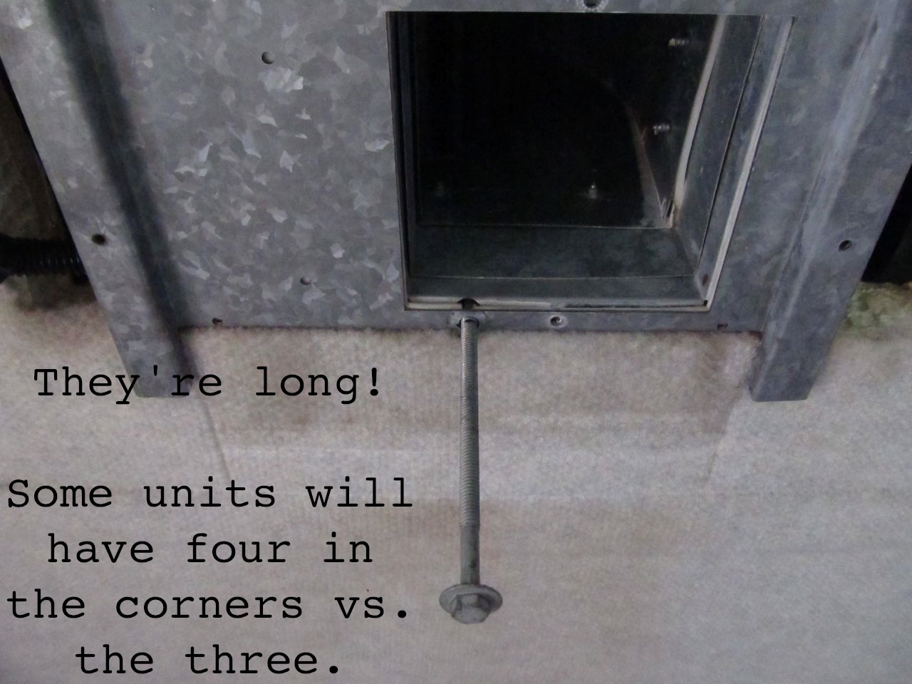

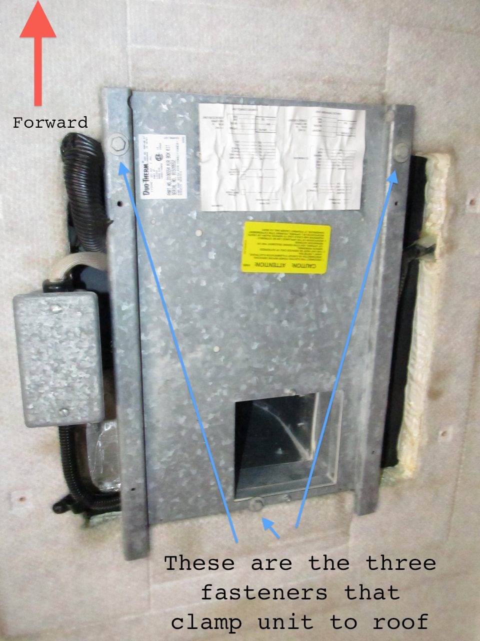

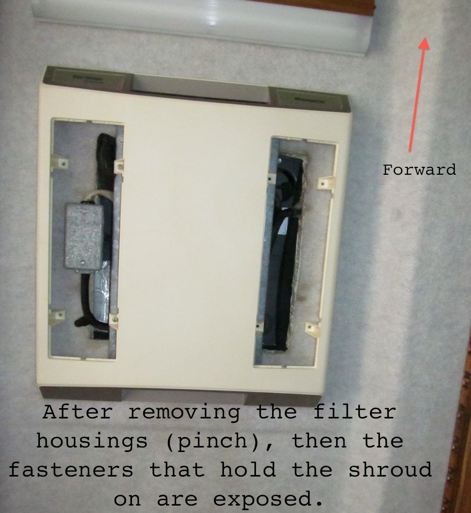

Here are a few photos from my rig when I was removing the Air-con (not that you'd be removing it, but they show how things sit). You may not have the same unit (this is a Duo-Therm 630215 series).

Great post Blue! The advice and pictures on tightening the screws to compress the gasket on the heat pump should prove to be a big help, and the video that you attached on replacing the gasket was also topnotch. Thanks so much. I'll be watching for your new thread too.
