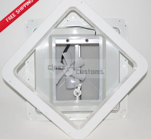

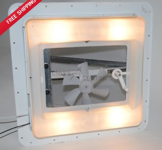

In my year Concourse, the main living room vent is a fancy Fantastic Vent, whereas the bathroom one was a more humble "Heng's" vent with a small built in fan and a lighted ring around the perimeter that is the bathroom light. Maybe you have that one? It does have two pushbutton (toggle) switches, one for the light and one for the fan. Perhaps you could wire in a different switch if you wanted to (that would indicate on or off vs. toggling)? I did buy a new (light) lens for mine this winter because the old one was cracked/yellowed. Let me look and see if I can find which vent/part it is. I would think you could easily get a new fan for it (although people tend to like the Fantastic Vents better). But if you want to keep the vent and just replace the fan part...
Okay, here is a link to what looks like the same vent/fan/light that is in the bathroom on my era rig. It shows as Heng's part number V771212-C.
http://www.ebay.com/itm/Roof-VENT-w-FAN ... 1374218618

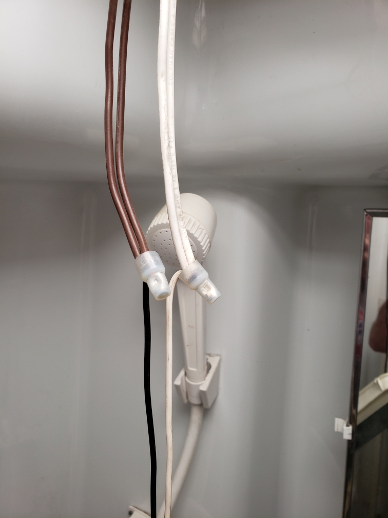

Yes, your two power wires that are at the top of the bath will hook to the vent.
The vent switches then control if its lights and/or fan get power from those two wires.
You might have to meter them to see which is positive or negative. Unless they're LED, the lights won't care if you reverse them, but the fan might run backwards :)
In my case, I think I had to non-intuitively hook black to white and vice versa. Whichever it was, I made labels with my labelmaker and wrapped them around the wires. (Life tip: also always label a wall wart power supply when you get it. Then when later you find it in a drawer, you'll know what it goes to!)
