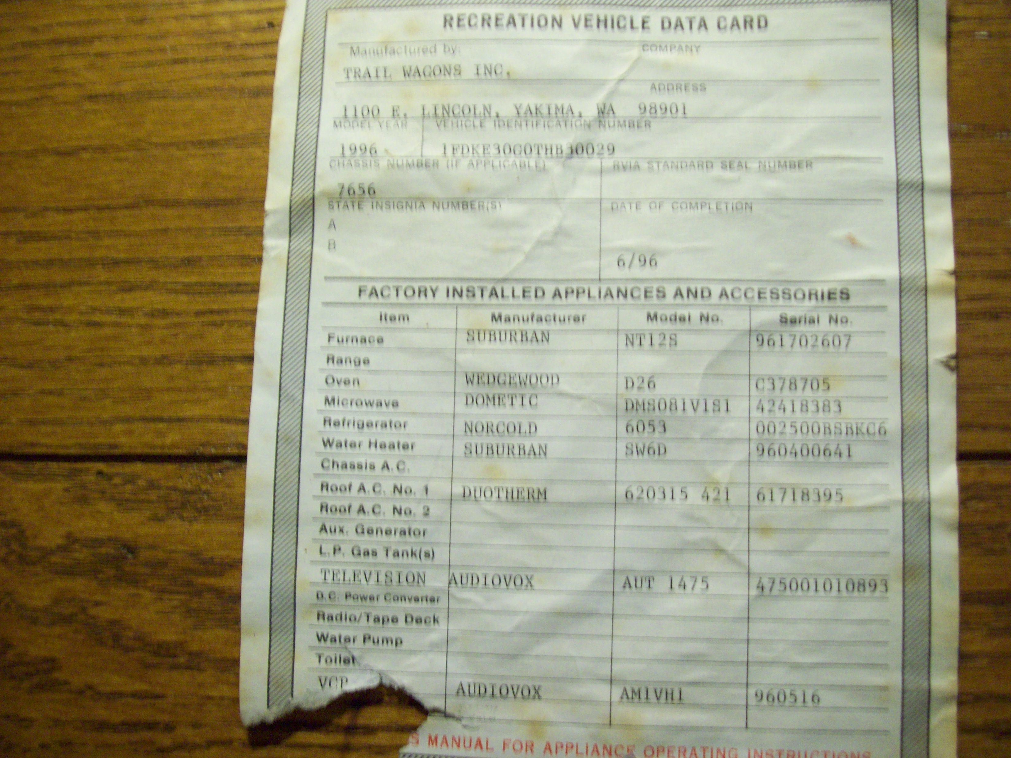

Well guess what, in looking through the cabinets in preparation for winter storage my wife found what might be the build sheet from days gone by. It would appear it is in fact a 1996 on a 1995 chassis. Everything seems be original less the tv and vcr.

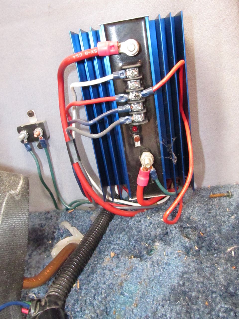

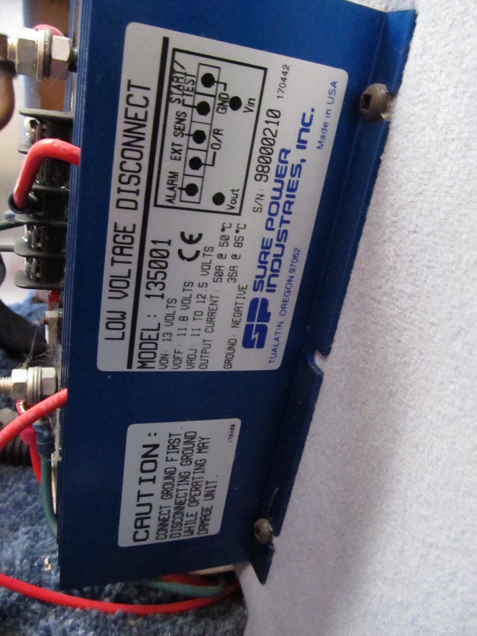

Here are some photos for now, to give you the idea and some info in advance. Clicking on any of these makes them larger. Only three photos are allowed per post, so I will continue in the next one. Actually, you might want to skip down to that post first, as I'm going to attach an overview from the diagram in the 1998 manual.

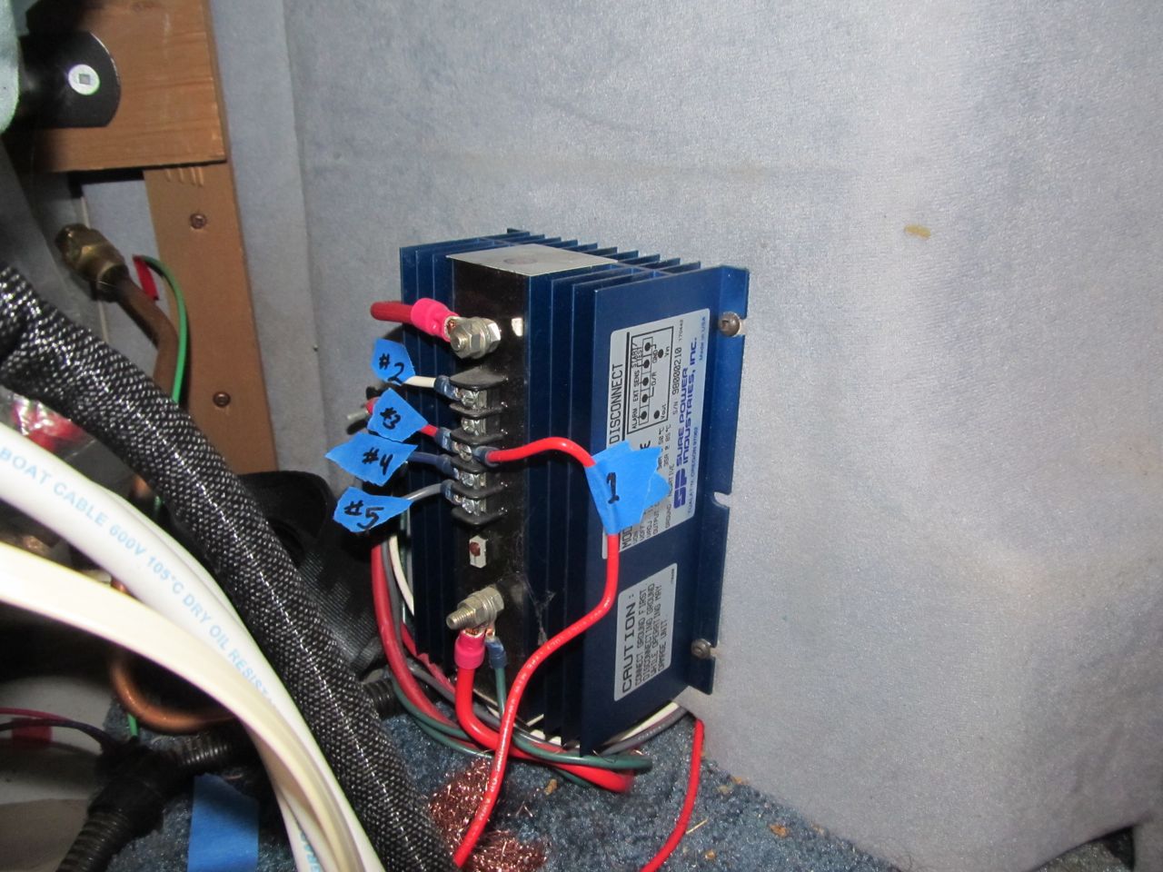

First of all, here are a couple of photos of the LVD in my rig:
Front: Side: Labeled, before removing (I hadn't decided how I was going to handle the new wiring yet, so wanted the info for reference):

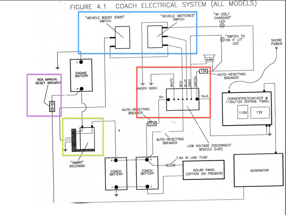

In the below diagram, the part in the red box is the LVD. The left-hand facing side of the LVD on the diagram is the top as it is fastened to the pillar in the coach. The blue box above that represents the "over the shoulder" switches by the driver's seat. The green box is the battery combiner under the hood (presuming you have that too; it's a Sure Power 1315 and is on the driver's fenderwell, although they must have had a trained mouse to install it - it's buried in there. You may want to look for the serial number on the combiner, as some were recalled due to fire danger (mine was). The purple box represents the 80 amp breaker for the generator start wire (again, if yours is like this). If you raise the hood and stand facing aft and looking at the start battery, then look up to the "seam" where the back of the hood meets the body, you will see it if it is there. A black breaker about 1-3/4" x 2-1/2", with a red button, and held on by some perforated metal strapping. (Later models, after around 2000, used the house bank to start the generator, thus shortening a wire run that is considerably too long and skinny.)

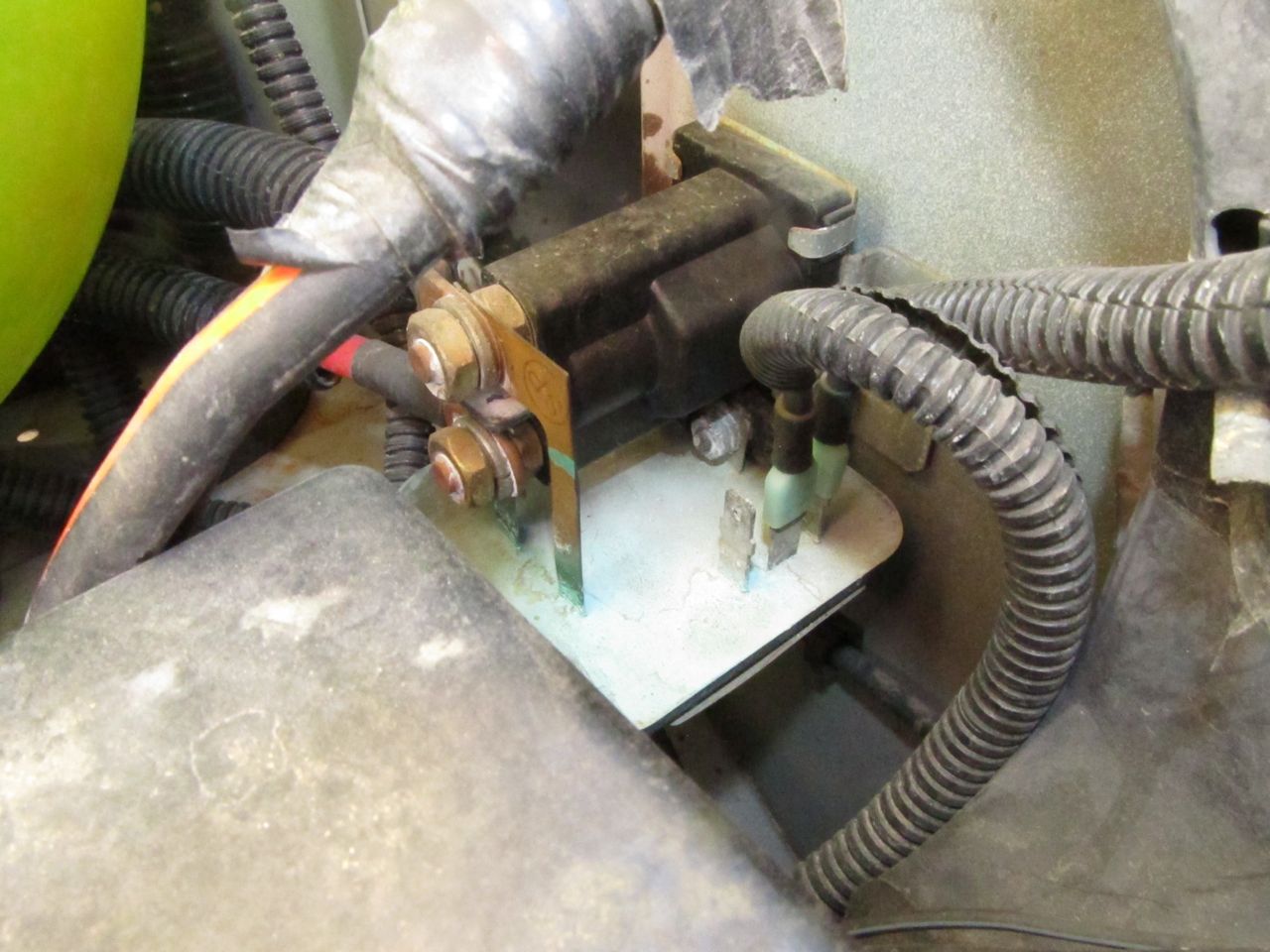

Here is the Sure Power combiner (formerly) on my rig, on the driver's fenderwell. This is without the cover piece on it. This has the green box around it on the diagram.

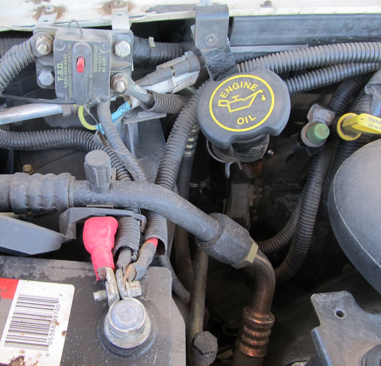

And here is the generator start breaker, top center in the photo -- the one with the purple box around it on the diagram. BTW, not a great arrangement on the positive post (terminal stacking). One of mine was just about torn through and making bad contact (I have since changed it).

Apparently, it's a late 1996 model year Chinook house body on a 1996 model year Ford chassis. It's a bit surprising that your local DMV didn't correct the title when you registered.Goodlife wrote:When I bought this unit the owner who was just flipping it said he thought it was a 1996 but the title said it was a 1995. I got no documentation or manual with the unit and I can find no plate on the passenger door jam. It is powered by a 360 engine with an overdrive transmission.
The VIN also says it has a 7.5L / 460ci engine, not a 360ci (which had stopped being made in 1976, I believe).

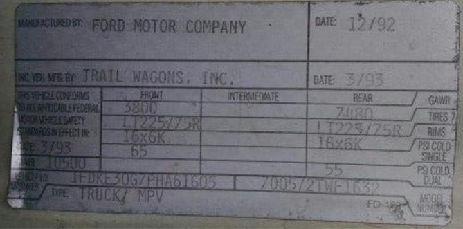

That's where the Ford plate is. But I meant a possible Chinook build plate. In some of the older models, it was on the passenger door, and gave the month/year that the chassis and the Chinook body each were built. This was before they started leaving a piece of paper inside the closetBlue~Go wrote:The Ford sticker you are looking for would be on the driver's door jamb, not passenger's.

Aha! Now I know.kdarling wrote: That's where the Ford plate is. But I meant a possible Chinook build plate. In some of the older models, it was on the passenger door
Since I knew I wasn't keeping mine (due to complete system re-design), I never looked to see if the low voltage cutoff could be adjusted. Looks like it can on the newer one. I agree it's not essential. I can see why Goodlife may want to put it back though. It would clear up a bit of a "nest" of wires and restore the function of the over-the-shouder switches (although there are other, perhaps better ways of doing that; putting the LVD back is straightforward).kdarling wrote: I agree, there might be a good reason someone took out the LVD. No real reason to put one back in, at least not a stock one with a too low voltage trip.
If the cutoff voltage can't be adjusted up, and is low (say below 12.2 volts or so), then just know that if you use that as a "low battery time to stop using things" alarm then it's a bit hard on the batteries to go that low. But even if you have it, you can still run another type of battery meter. And/or your use may mean you just use the batteries without much worry and replace them from time to time.

PS> Here's my passenger door build plate put on by Trail Wagons. I think it's a standard U.S. format for RVs built on an incomplete vehicle, to indicate when the body was mated to the chassis, often for model year purposes.
I think it became required in the late 1980s (?) after many RV manufacturers began cheating and constantly swapping a later model year designation onto any old RV that hadn't sold yet ... sometimes for years. Perhaps you have one too, and it's hidden somewhere?
