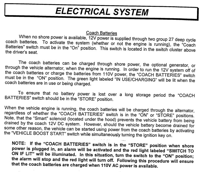

Watts = volts x amps, so 110V x 30A = 3300 Watts.
The house batteries are charged from the engine while driving, from the generator if on, from shore power if hooked up, and from the solar panel.
In my 1994, the house battery is always connected to the shore/gen power charger.
In your Destiny, I think you have to make sure that switch you mentioned is turned on (otherwise an alarm sounds?) so the house batteries will get charged... see NOTE section below.
Manual from 2000 Concourse
Oh. If you meant to simply run 12v stuff, I would think that switch has to be on. At least it does in mine. Have you tried turning it off with shore power? Do the 12v interior lights go out?

Great info all in one place. Thanks a bunch. I'd read some about this in the manual but it hadn't all come together for a greater understanding. :)
