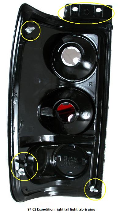

From what I've read, there's no screws for the Expedition lens on Chinooks. It's all press fit instead.
Apparently there is a (breakable!) tab at its top and two press fit prongs at its bottom. (EDIT: hmm. Aftermarket photo below shows another push pin at top!)
- To remove, you gently pry the bottom out and slightly sideways away from the RV (left for left lens, right for right), until the prongs and top tab slip free.
- To install, insert the top tab into its body slot first, then rotate up and push in the bottom prongs.
It's suggested that you get the new lenses first, so you can better see where those things are.
Btw, reportedly the Chevy based Destiny also uses the Ford Expedition lights.
Luck! Kev
PS to Colorider: hey I'd already wasted too much $$ trying to find Econoline lenses that fit. And tearing them up trying. If you hadn't asked, I'd have never figured out that they were Aerostar lights. Although member vacuumbed had mentioned last year that he thought the last 1991 Chinooks used them! Anyway, thanks again for asking!!

I am a Chinook Newbie. I just bought a 2004 Concourse XL with a Ford Expedition tail lights (3 bumps). I was looking for some explanation (or on You Tube ) on how to change the bulbs if I have to. I see no screws on the exterior surface to remove the tail light. In fact the one on the driver side does not fit well and I put a tape at the top to reduce water from coming in.

Nick, see my post just above yours.
Apparently yours just pull out. No screws.
