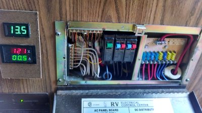

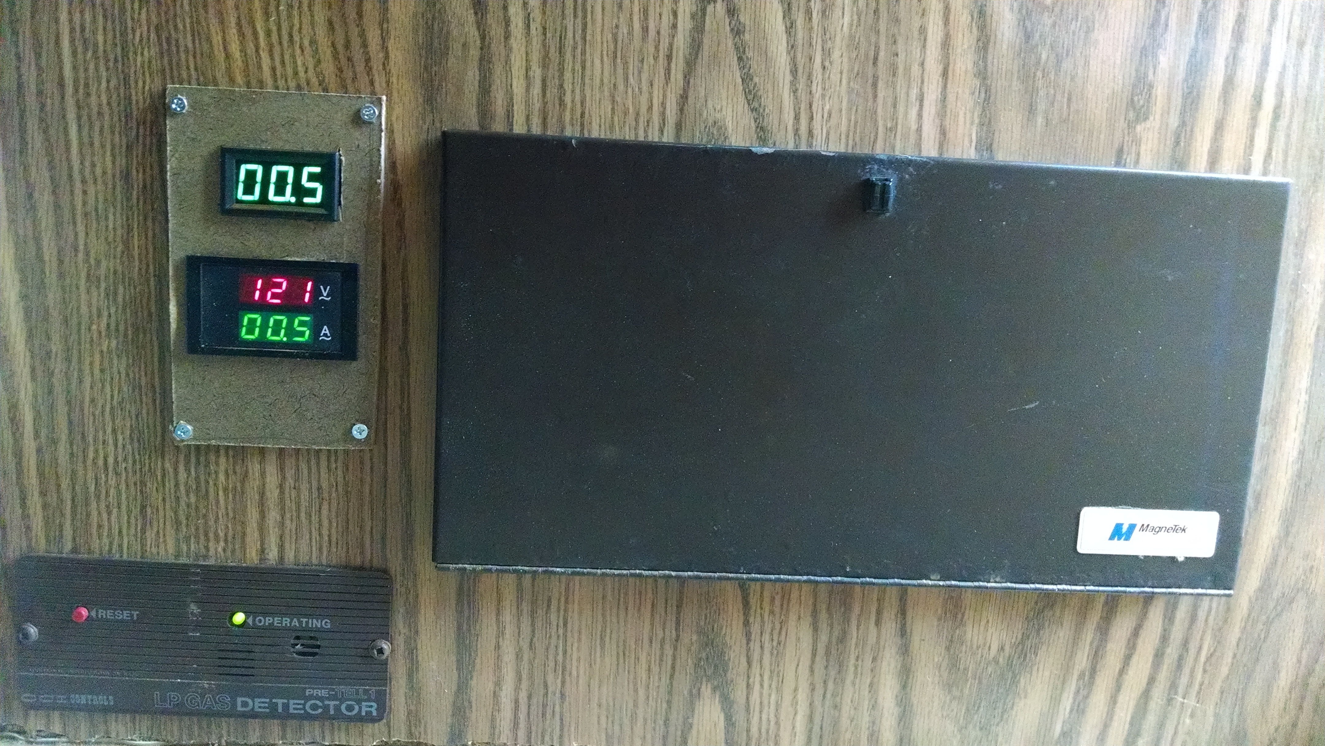

Above is reading 13.5 DC volts, and 121 AC volts with 0.5A being used by the converter/charger. (Turning on the roof a/c heater coil jumped that to 14A !)
And here buttoned up a bit better. Will fancy it up later. Note this on a '94, where the distribution panel is below the fridge, and in front of the generator box. DC usage here is also 0.5A (200mA for the gas sensor at lower left and 300mA for one roof LED lamp set -- a fan can jump that to 4A).

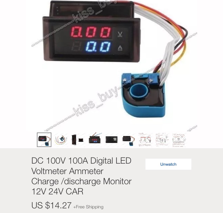

That top DC meter alternates between volts and amps, but I'm replacing it with another $12 loop meter that has both volt & amp displays like the bottom AC meter.

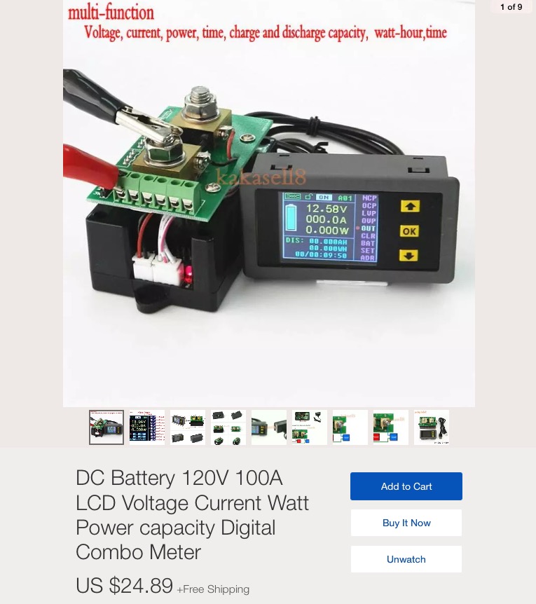

Next up: installing a remote shunt meter at my single house battery, which either wired or wirelessly transmits info on battery power in/output to a remote head display unit. The price for this technology is astonishingly low:
File comment: remote wattmeter
The left box is the shunt and meter electronics, with optional wireless transmission to the remote display head on the right (which only measures about 1.5 x 2.5").
It's sort of like a trimetric monitor for cheap. I will let everyone know if it works well.

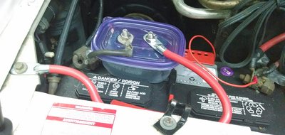

The plan was to put the reader/shunt part next to the house battery (in my '94, that is just one battery under the passenger side of the engine hood), and use its wireless mode to talk to the display head placed somewhere in the main cabin. (If all the metal got in the way, then I'd run a USB cable instead.)
Like most such meters, the shunt has to go on the negative side of the load, so that meant in my case that I had to go under the hood, and connect between the chassis ground (the return side of the house load) and the battery negative post. You guys with the later rear batteries should have it easier.
So I went to an auto parts store and got a short battery cable (a ground strap would also do). A small red wire gave it positive power for the electronics. A small 2x2x4" plastic container to keep it dry came from the grocery. Still figuring out placement, but here's my test setup (the battery negative cable used to connect directly to that fender screw):
First I plugged the display unit directly into the sender to make sure it was reading and that they were both set to the same wireless channel.
Then I took the remote display head inside the cabin, using a 12v outlet & USB adapter to power it. To my pleasure, it could read the sender from under the hood, back almost as far as the sink. I'll probably mount it closer though, in the overcab storage wall next to the old VCR slot.

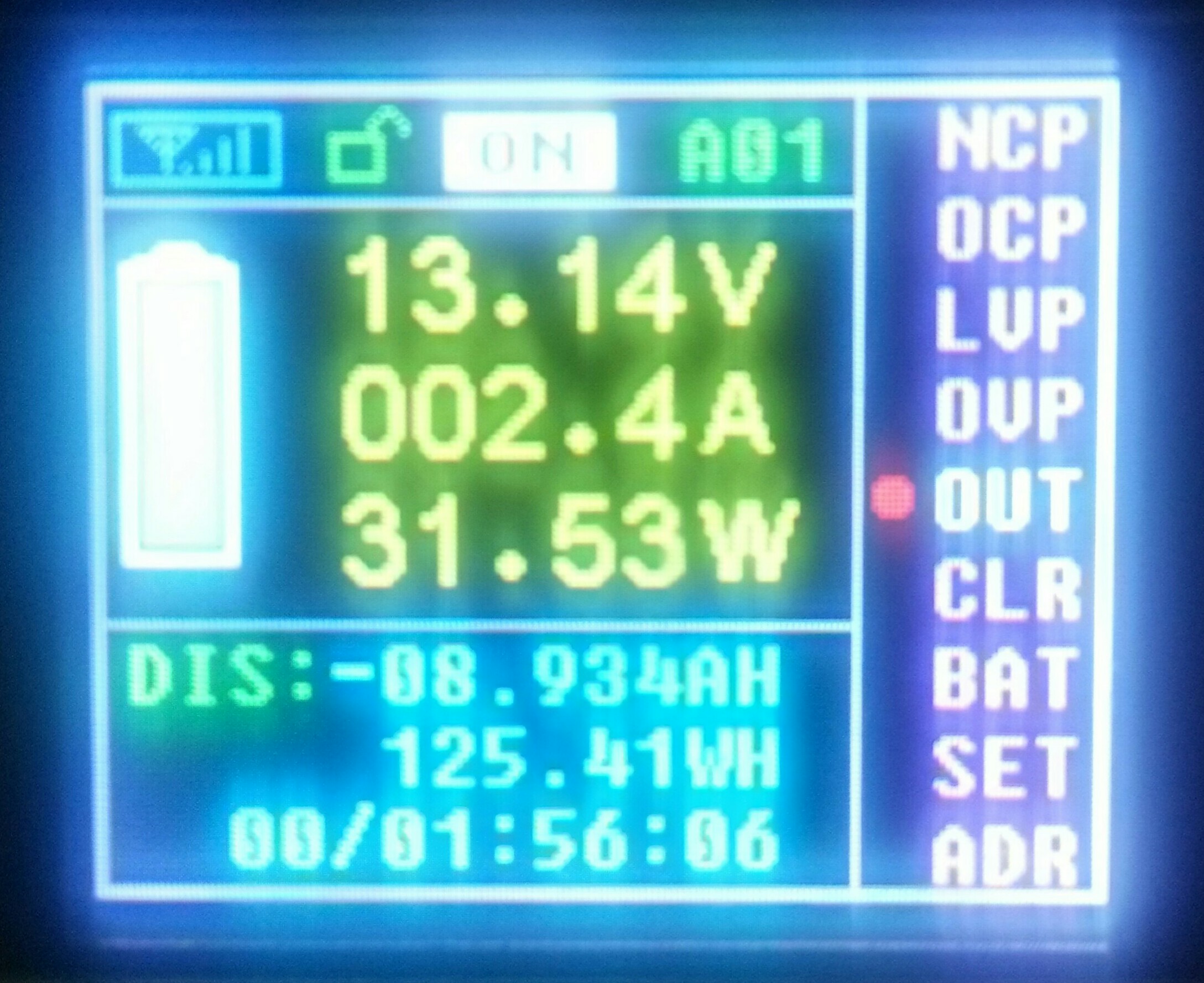

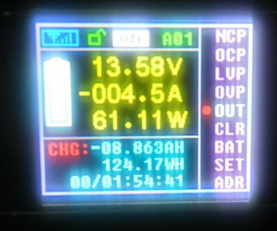

Here's a blurry shot with shore power turned on, charging the battery. I had gone inside to watch TV, and so after about one hour and fifty-four minutes (1:54), the converter/charger had given the battery almost 9 amp hours of juice:
My Progressive Dynamics charger puts out 13.6v from its location back near the fridge area, so I apparently lose .02v on the way forward. Hmm. Seems too little. Will need to check with another meter.
Now a couple of minutes later with the shore power turned off, running the Fantastic fan from the house battery. The accumulated AH and WH will start to tick down now that the battery is being discharged:
The values update once a second, so you have a constant running total of the amp and watt hours that have gone in or out of the battery.
I'll have to get used to positive numbers and green == discharge, with negative and red meaning charge, but hey, for $25 I can do that :)
You can set the amp hour rating of the battery and other parameters, so I just need to get it fully charged and then set that as the full 60AH point in my case. You can even hook up a relay for it to disconnect the battery load if it falls below a custom voltage (LVD).

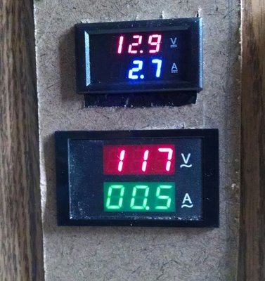

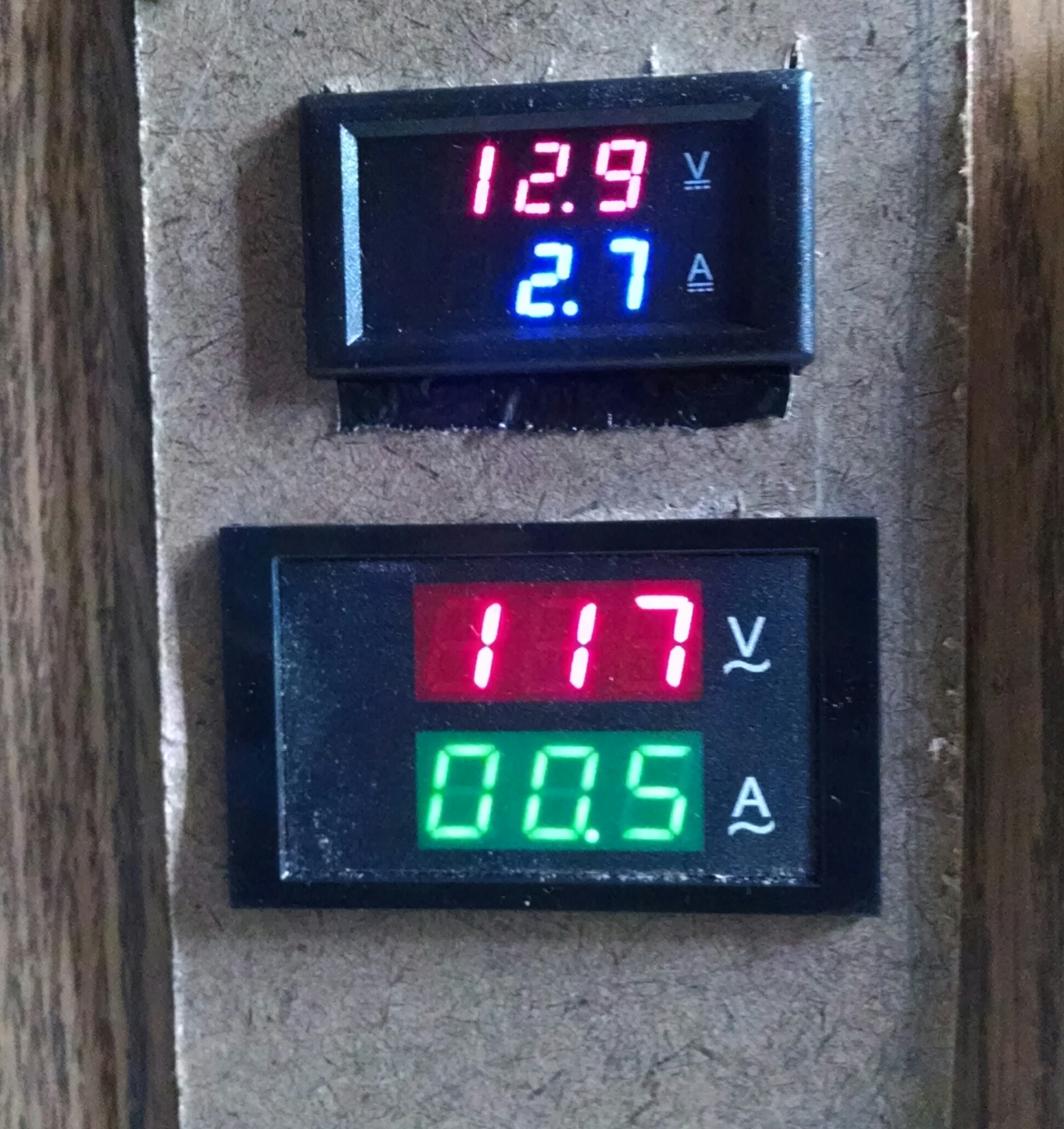

So, I got in a dual display DC volt / loop ammeter, to replace the green meter that constantly cycled between volts and amps.
File comment: dc volt ammeter loop
Installation of the loop was again easy... just unscrew the incoming 12v wire and slip the sensing loop over the end, then rescrew the wire.
Since it only comes with about a three inch sense loop connector, I cobbled up an extension using the long three wire cable that the previous meter came with.
I like the dual display but I think it might read slightly low on the volts. I'm going to have to do some testing and check if it has an adjustment.
(The top DC and bottom AC meters are still in a temporary mount next to the circuit breaker box.)
