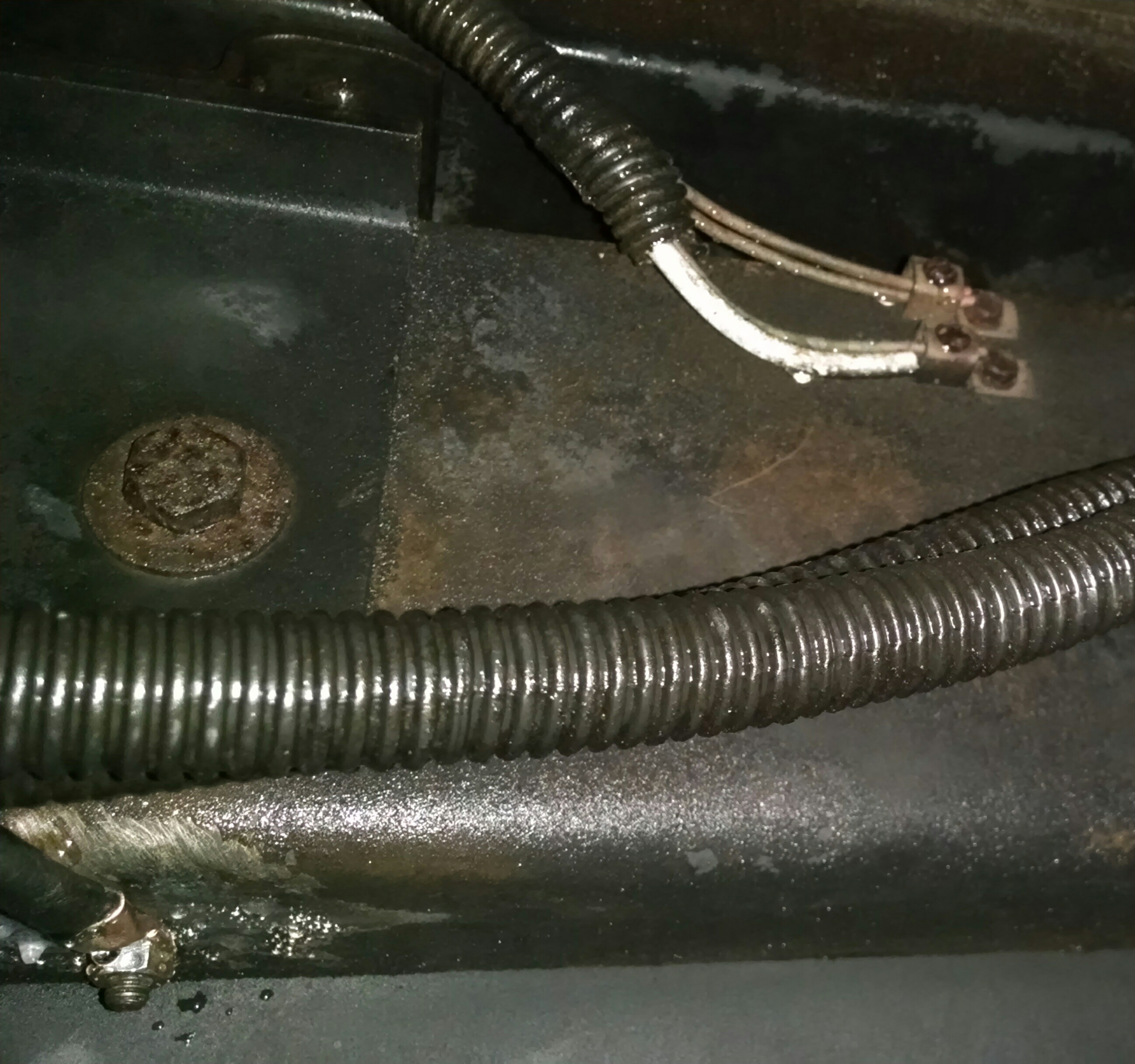

Anyway, so I got towards the right rear and saw some of the ground connections, which are on my todo list.
In the photo below, at the lower left is the generator ground, and the upper right are the grounds for most of the electrical panel and converter. (This was taken after washing nearby, that's why it's all wet.). Remember, I'm a '94, so yours will vary.
Since the generator has been slow to start at times (it doesn't quite reach the RPMs required), and its ground used a big 1/2" nut, I went for it first. The nut quickly came loose with a socket and began to unscrew off, but then after a few tight turns it suddenly starting turning TOO easily.
To my horror, the nut and the bolt inside the chassis rail that it threads onto, were now turning together! Arrgh. Now I was worse off than ever, with a partially undone ground, and seemingly no way to tighten or remove.
Long story short, fortunately the back end of that chassis box rail is open, and I was able to jam in a long crescent wrench to keep the bolt from turning while I removed the nut, wire brushed clean the rail and ground cable, and put it back together. Then I covered it all with clear Rustoleum spray.
Good news is that now the generator cranks a tiny bit faster and thus starts nearly instantly.
Bad news is that now I'm fearful of messing with those other grounds, as there's no way to reach behind them inside the rail. Does anyone know if they are simply screws into the rail, with nothing inside? I think they are, but you know how it goes: once bitten, twice wary ;)

Wise preventive maintenance. My 2002 has 7 ground wires to frame rail as I recall; 3 on the right side rear (for Refer, Gen and 12V circuit board) and 4 on the left side. On the left, one is mid section under the coach battery compartment to batteries and the remaining 3 are at the rear for 110V breaker panel, 12V fuse panel and 12V circuit grounds.
The wires run into copper blocks grounded to frame by a 12x14 sheet metal screw with no backup nut inboard of the frame rail. However, these screws are easily sheared when rusted into the hardened steel frame then a bear to remove. I had to drill one out with much colorful language.
So I suggest soaking the area overnight in penetrating oil like Kroil or PB Blaster. Others swear by a home brew of 50/50 acetone/automatic transmission fluid. Either way, ease out the old screws gently and replace with new ones, then coat the area with some Rust-Oleum.

Ted, thanks so much for the info!
PB Blaster it is, then. And I'll keep my fingers crossed... I've rarely had good luck removing broken fasteners that small. Likely easier in this case to tap a new hole instead :)
