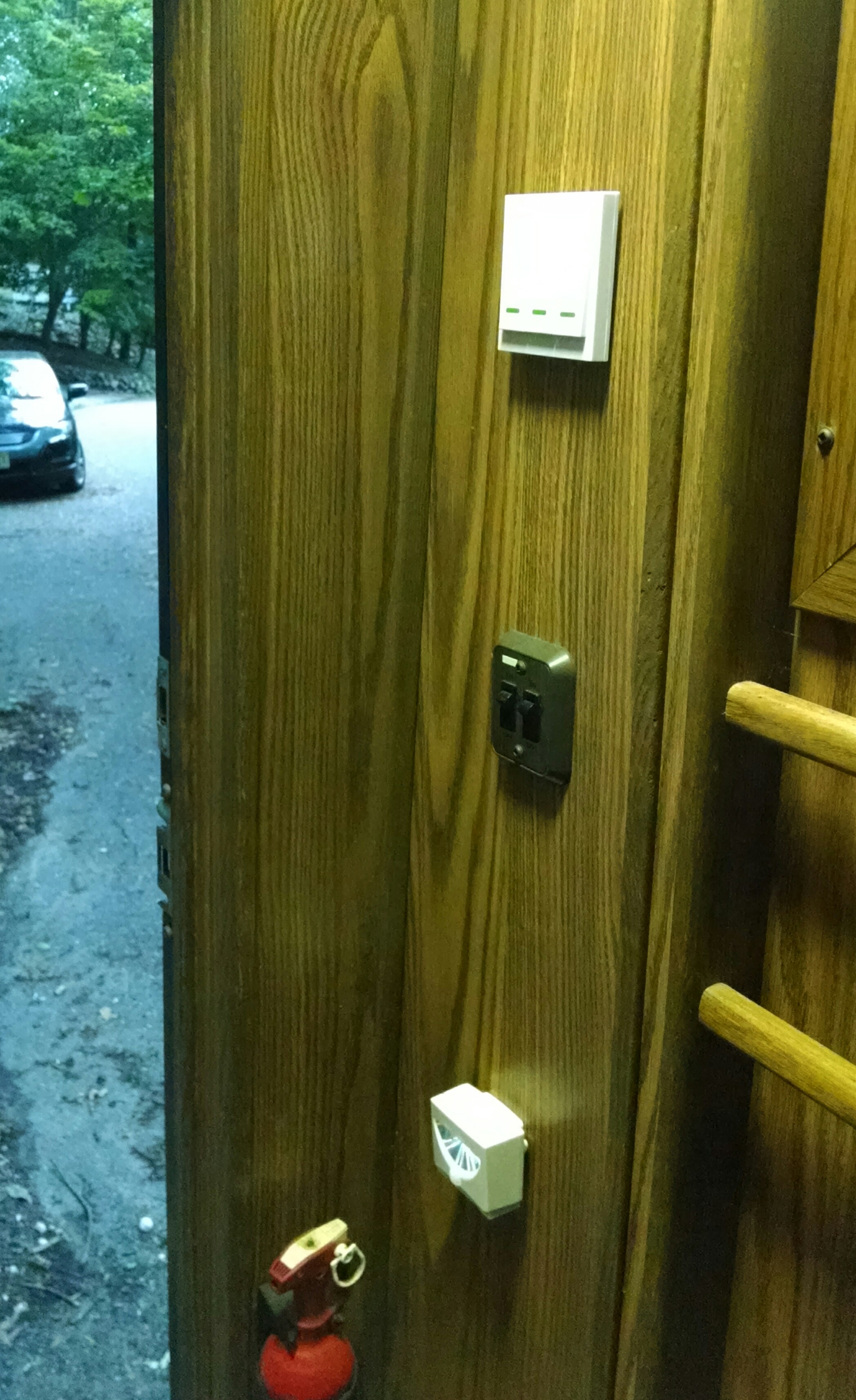

I'm mostly using 3M Command strips, so the pushbutton switches can be easily moved/removed.
Those green markings are just painted on, btw. I'll be covering them with glow tape so I can find them in the dark. Pressing any button lights up a dim red LED behind the middle of the buttons. When a relay switches, it makes an audible small "tink" sound. The relay has both normally closed and normally open outputs.
PROGRAMMING
After a receiver is wired into the light circuit and has 12v to it, you press a learning button on its board and then any remote switch you press is added to control that relay. Repeat as needed. In my case, the switch mounted on the passenger wall has its leftmost switch set to toggle the frontmost ceiling light, whereas on the driver side wall, it will be the rightmost switch (I'm setting them visually to match position front to back). If you goof up, you must erase them all and start over. So figure it out before covering up the boards!

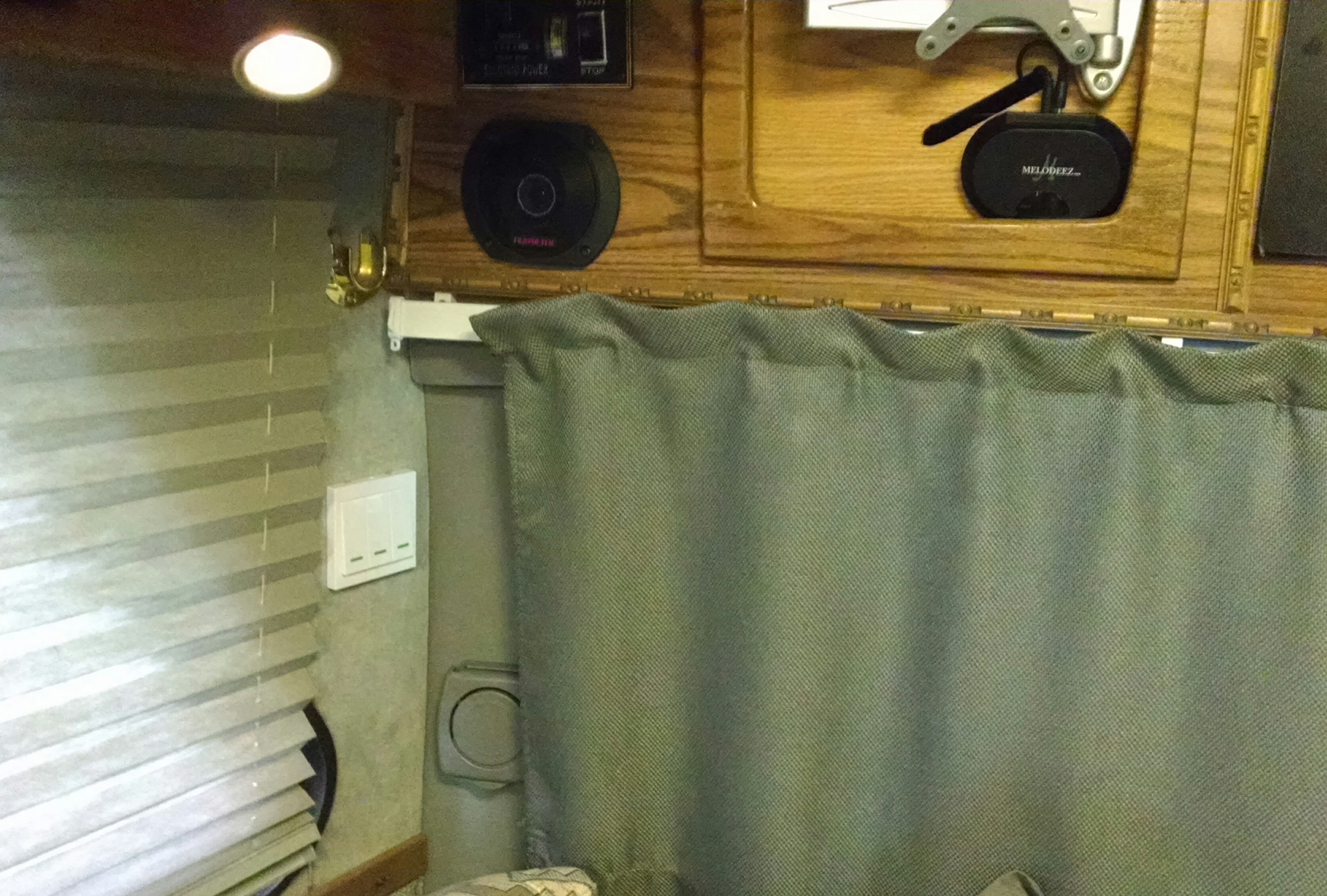

So here's where another of the wall switches ended up -- behind the driver's seat. Again, they are arranged in order, back to front, controlling the rear, middle and front main ceiling lights.
I was going to put the third one behind the passenger side window over the dinette, when I realized that lowering the right side shade would cover it. So now I have to think of another spot.
